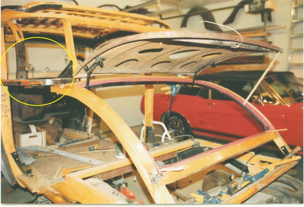

    Chevrolet stopped using a wood framework with the 1935 Chevrolet STANDARD SERIES EC. This is determined by having a wood sills on which a wood framework is assembled and then the sheet metal body panels are nailed and screwed to the wood frame. . Body%20wood_2A.jpg

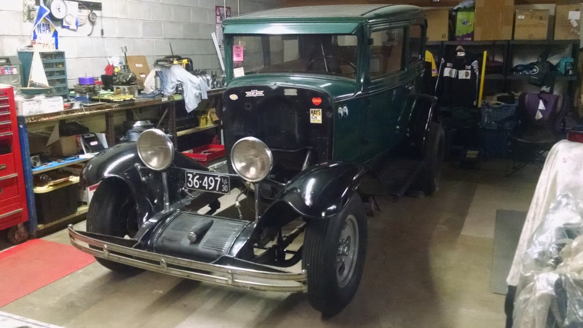

    Chevy Project - Roller, 55 Chevy Rear and Speedway Straight Axle. Nov 2015 Photo Droid 005.jpg 10436676_10203050417398304_5018446119965221019_n.jpg 10559906_10203045109785617_5240273499477389357_n.jpg

  9. GlassThamesDoug
    Joined: May 25, 2008
    Posts: 1,578
    GlassThamesDoug
    Already there in pic with tires

    The axle picture installed in the car with fender wheels and tires is NOT a straight axle, its a dropped axle looks to be about same drop as a stock cast iron BEAM axle.
    If you want to slam that front end down on dual spring front end chevies, you have to run a MOR_DROP beam axle that's dropped on the ends ( spring mount to kingpins ) 3--or 4 1/2 " over stock. The axle also needs to be 4" NARROWER 46--47" over stock (50" ) so that when the fenders come down the tires are sitting completely inside the fender .
    My coupe was using a mor-drop 4 1/2" maxi drop that was narrowed to 46" in a forge . You can see how low this was by looking at top of front bumper is below the spindle centerline using the hub cap as a visual aid.
    I still have that axle its been bead blasted and drilled with 3/4 or 7/8 " holes. Price $300 plus shipping.
    The axle is a 1940---1954 .....1/2 ton truck. I used to run 1949---54 chev PASSENGER CAR spindles and king pins, along with 67-69 camero 4 piston discs, ( smaller bores than vette )
