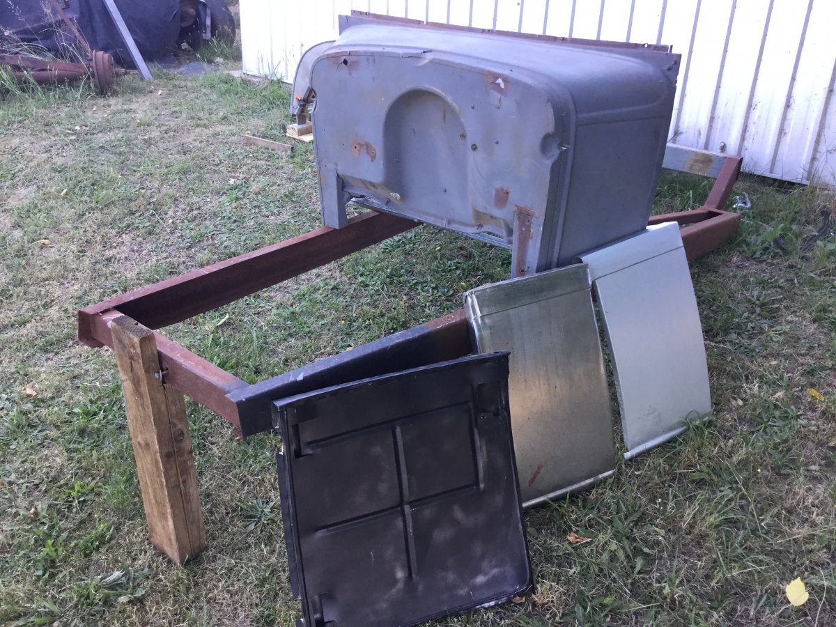

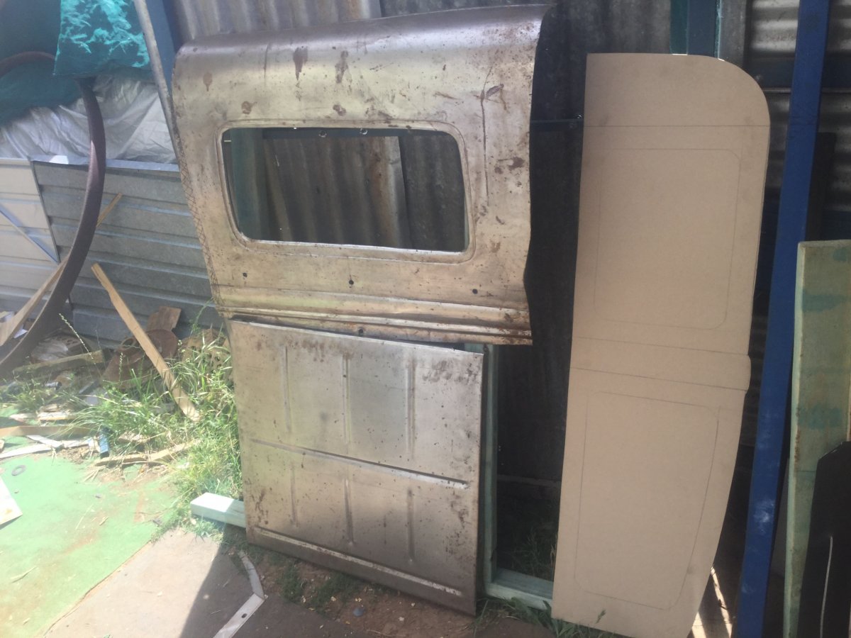

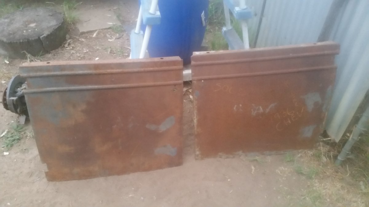

    Hey Guys.

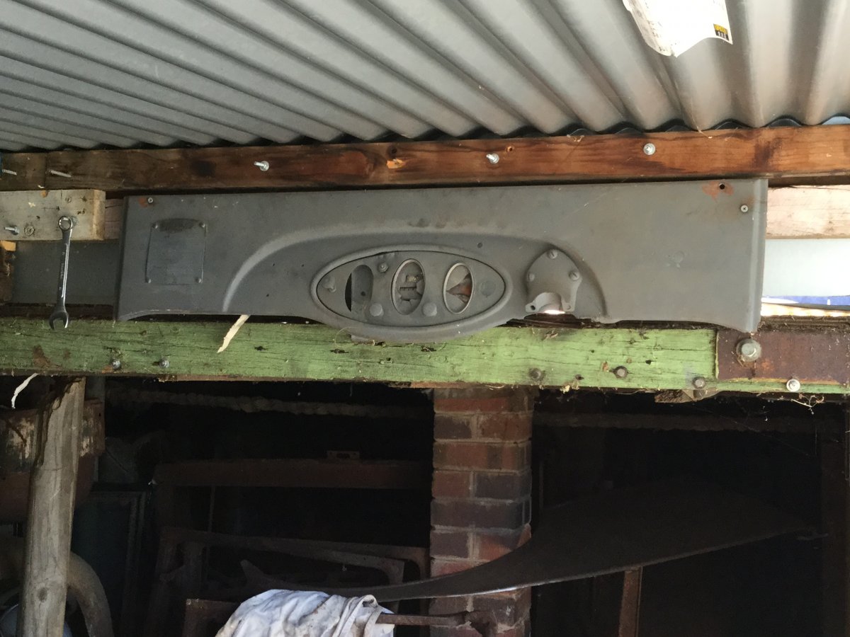

    I only just discovered this thread today, so I have been looking through all the posts. This is the pile of panels, I picked up two years ago. It comprised of a cut up 29 Truck cowl, single door and a 28 Tourer rear door. E3F1B743-6999-4117-8132-BB53DA26640D.jpeg 5B585D0F-D152-4D87-BE41-1875796EF039.jpeg
  17. chev34ute
    Joined: Nov 13, 2011
    Posts: 1,240
    chev34ute
    I will be fabricating everything from the cowl back into a closed pickup cab including the doors out of new steel . I am not worried about the task but the biggest challenge will be recreating the lower part of the cowl that is missing. I will be using these mid thirties Chev truck doors as a pattern for the new ones. These doors are actually for closed cab trucks and extremely rare, but look similar to the 27/28/29 truck doors. 2D5E442C-0139-4123-A1DE-57CB3A86B401.jpeg

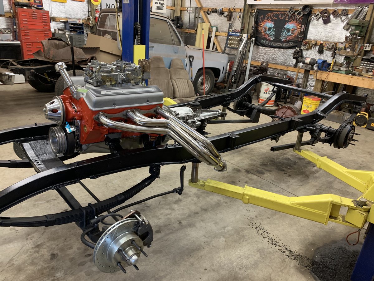

  21. IMG_1747.jpg Just stumbled across this while searching for other stuff. I'll be spending the next few hours reading all of it. I recently rescued a 36 Chevy 5 window coupe that was a gasser in the 60s. Parked and left to rot in 1970 when the track closed. The chassis is squared away and now I'm looking for tips on replacing the wood framework that went between the chassis & the floor. I'm leaning towards 1x3 rectangular steel for the sides and probably 1x1 or 1x2 cross bracing. Any help would be hugely appreciated.

  24. Not much to see so far body wise but here she is. Floors are pretty much non-existent and the wood is bad also. 111999229_1001595963608052_9211414049108110050_o.jpg 110823541_1001595983608050_5087637599647601030_o.jpg IMG_0957.jpg IMG_0979.jpg
    Torkwrench, biggeorge, TFoch and 6 others like this.
  25. She's a rough old girl. When I got it it still had stock front brakes and the guy I bought it from thought it had a Ford 9" rear. Turned out to be a 58 Olds rear with welded spiders and 5.38 gears. The rear tires were old bias ply Redlines that were date coded 1970 mounted on 15x10 Aluminum slots. IMG_0960.jpg IMG_1022.jpg
