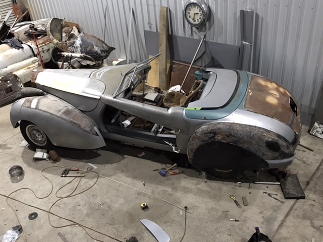

    65825B5D-05BE-42C8-AB84-15BBC7D6ECC8.jpeg F0B86100-E086-4173-A94D-0FCC0FA3F970.jpeg My 39 Packard custom is coming along nicely. I’ve moved the cowl back 11 inches and the firewall back 4 inches.

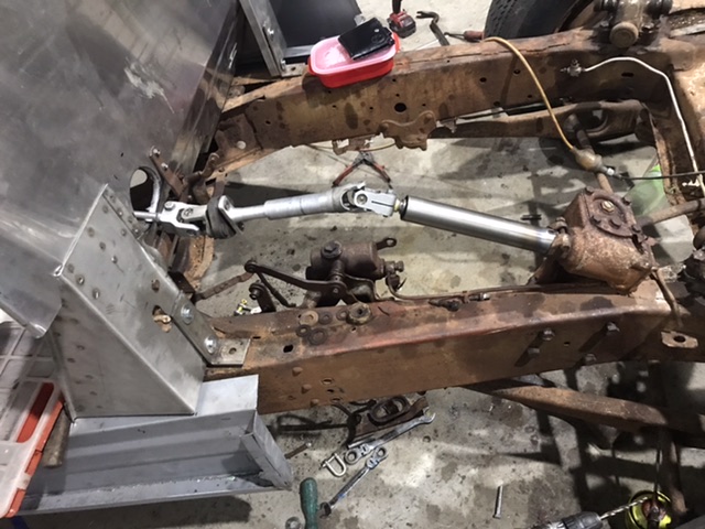

    Initially I planned to just lay the steering column down and extend it but as I did not have enough column length decided to add a Borgeson joint and retain the original steering box position.
    As the cowl is sectioned 3 inches the low rake of the column and size of the steering wheel puts it low in your lap.
    Now that I have decided to use a floor shift and get rid of the column shift, I’ve been thinking that a telescopic steering shaft would be great for entry and exit.
    I know MGAs has a push in pull out column. I guess I just need a splined shaft and a bush and a locking device.
    I thought about a tilt mech out of a later model but I think the tube needs to be aesthetically straight.
    Got any ideas? Remember I’m right hand drive, not that that should make a difference.

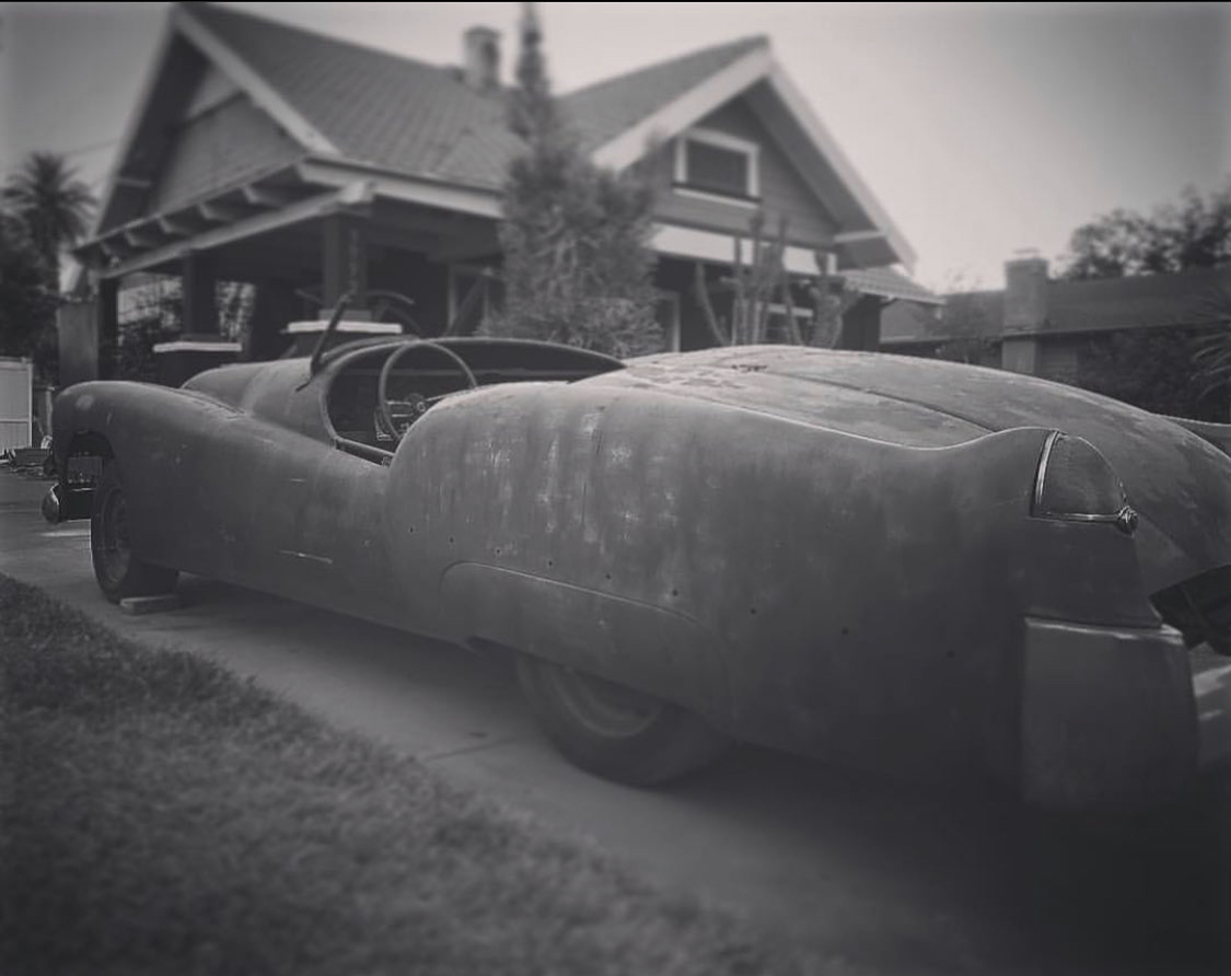

    The idea came from Hudson Joe’s insane 41 Buick/Cad sportster which has an aviation in/out column.
    But I do like the swing away idea too.... we’ll see.
    Up,down, in ,out, swing left, swing right. I need a Bex and a good lie down. 633728EB-61A7-4DFC-AA8C-353EE88957C4.jpeg
