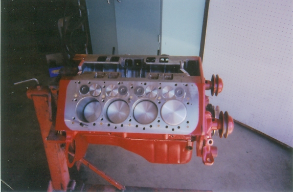

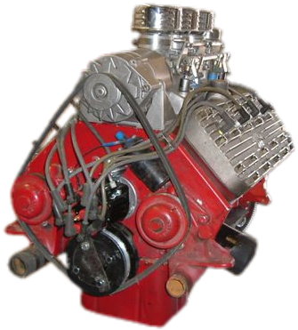

    Here are the photos of Dicks flathead. HE made patterns to cast the deck, heads and front covers. His son Blaine, an expert machinist, did alot of the design and machining on the patterns for head and deck water passages to get the cooling correct. Dick said he would sell engines or the complete tooling and design package if there was interest.
    scott
  8. etwheels-- what are we looking at here?

    Scott, thanks for posting!
    There is no doubt that Dick and his son have talent! It's pretty spendy, and not really my cup of tea.
    The design, machine work, and overall workmanship is awesome though! I've never seen the 'reverse' of the normal OHV conversion before, so that's pretty cool!

    Unreal. I would not have believed it with out the picture. Just proves what is possible when you just want to do what you want to do and don't care what anyone else thinks.

    I always figured at some point someone would cast or machine a new complete upper deck & cylinder assembly that, with lots of machining, could be installed in an old flathead block that had excessive cracks or other damages rendereing it unrepairable otherwise.
    I never figured someone would do it to an overhead block. Sound like someone was bored and had a lot of time on there hands. With that much bore, even barely adequate breathing would likely make more power than anything Henry ever invisioned.

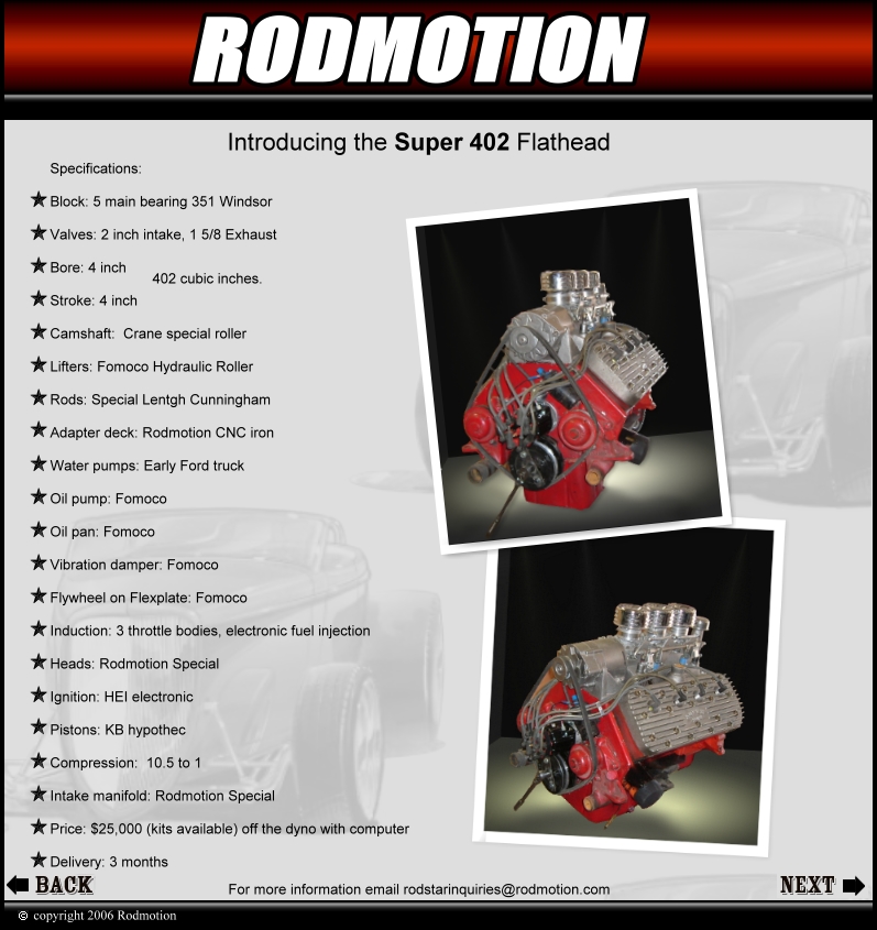

  13. Ummm, something weird here... You show a page from a website ("back" and "next" buttons) dated 2006, but there is absolutely NOTHING coming up on a search for this swap. The only thing that comes up for "rodmotion" is a low-buck dyno.
    Not saying it didn't happen, but it looks like they are for sale from your pictures...but where?

    ALL that work and the exhaust ports are still routed to the OUTSIDE of the block? Why not just make them up top? As far as camshaft goes getting enough lift with the Ford .875 dia lifter might be hard, just going to a roller lifter might do it or boring the block out for bigger would be required...For power [hp] I would say one hp per cube would not be unrealistic IF you have the build from scratch option and you have the durability/oiling of the windsor lower end and real durable parts for boosted applications?...

    I thought about making valve covers that looked like a flathead for my 302 just to look cool in my 36. Having a real flatty that could produce big time cubic inches on a strong crank would be awesome.
    I still can't figure out how he routed the exhaust?????

    that is a neat setup! giant intake runners, pretty much a straight shot to the valves. well done!!

    The exhaust is still a mystery from those photos. I can see what appears to be openings into the valve chamber area. No sign of exhaust ports on the outside in those photos. There isn't enough room to run it between cylinders there for the center siamese exhaust ports.
    More info would be needed to even see if they run the exhaust to the outside of the block. Under the manifold? Maybe there is a reason folks haven't heard much about this conversion yet.
