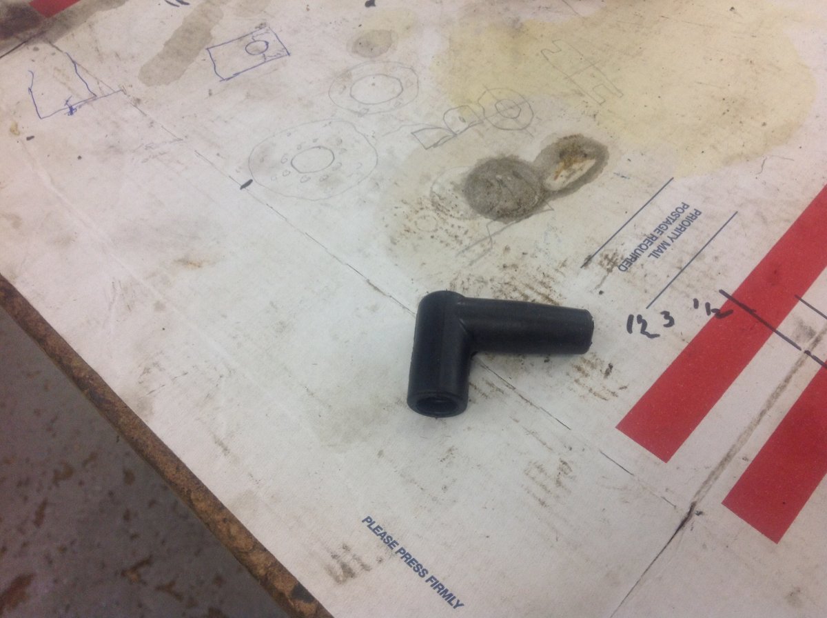

  1. Getting 8mm plug wires thru a 90* plug or distributor boot can be a real problem sometimes. It's a bit like sticking a wet noodle up a wild cats ass. S
    So this little tip makes a PITA job a non issue.

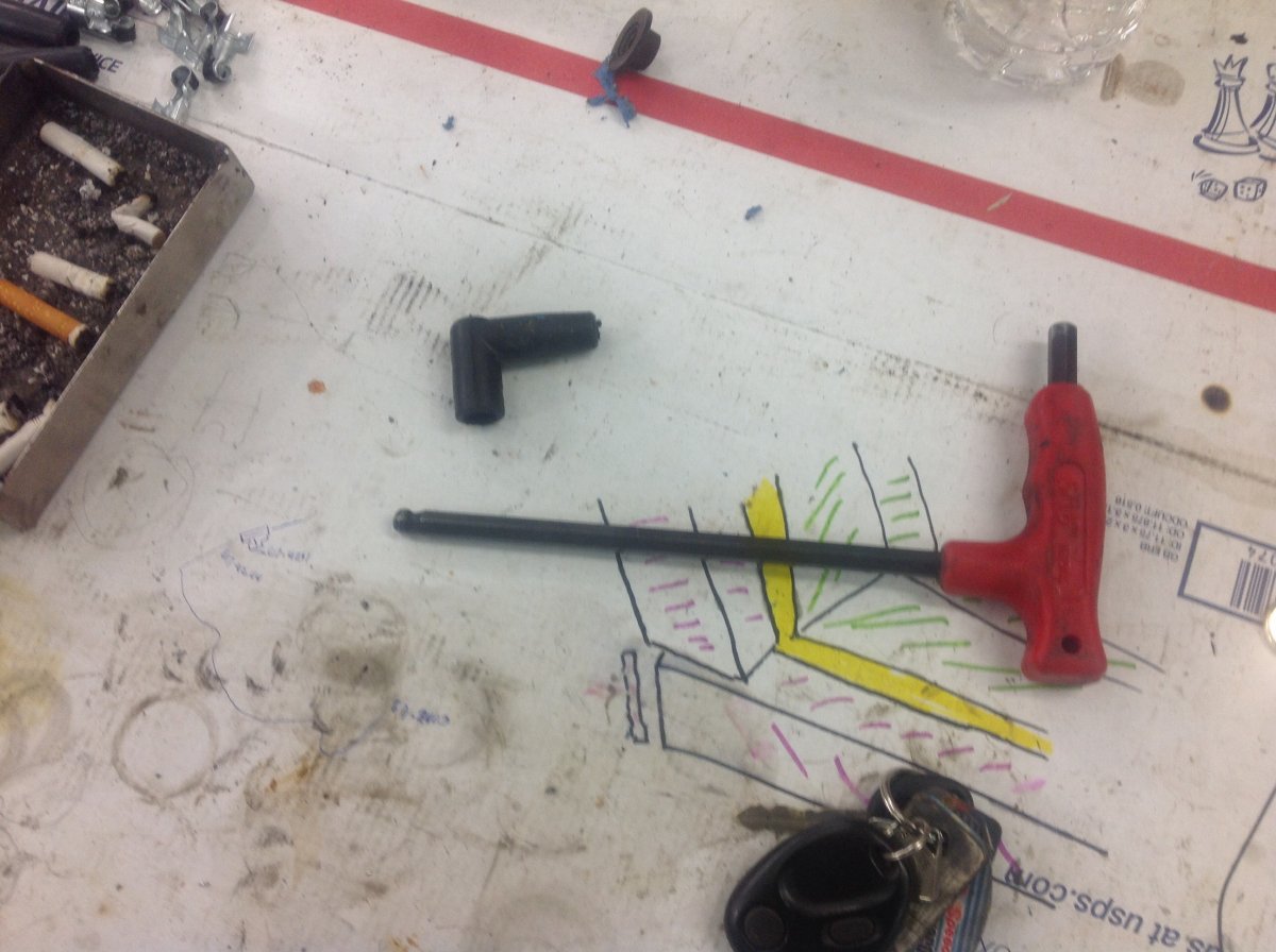

    Find your 5/16" Allen wrench with a balled end

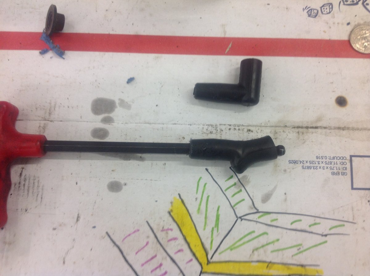

    Let it sit like this just for a few seconds. I didn't time it but about 30 then take the boot off. But you need to work quickly here.
    It stretches that boot and the plug wire slips right thru nearly effortlessly and with out even noticing it went dead end into a 90.
    8 wires booted in about 5 mins or so.
