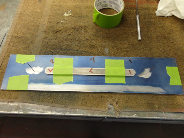

    I located some pics that I can use for a demo on the more common use
    of steel patterns. The pic below shows the 3/16" male, and female
    patterns. The blue blank to be pressed is 16 gauge which I have scribed
    the location of the male die. A good rule of thumb for clearance between
    the male, and female die is 1 1/2 times the thickness of the piece to be
    pressed. (16 gauge .057 = .085 gap in this case) This can be varied to get
    better definition on the finished part. To tight of a gap, and you will shear
    the the piece! I had been trying different gaps with this die, and settled
    on .085.

    Here I have taken the female die, and taped it to the bottom of the blank
    aligning the two pieces using the 1/16" drill bits. I than taped the male die
    to the scribed mark on the blank.

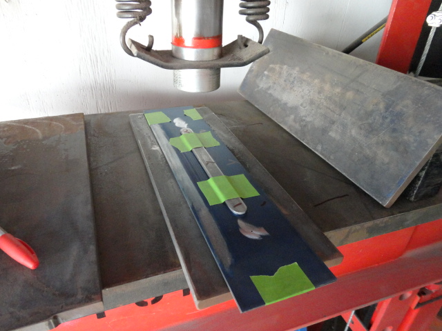

    The above pic did not show the oil, but I spray top, and bottom before pressing.
    Below pic shows the pressing. I do the pressing in stages usually by lightly
    pressing the first pass front, middle, and back. Increasing pressure with two more
    passes. It seems to give me a more even press, and less chance of the part
    moving around.
    How much pressure? Well with steel a 20 ton press should work.

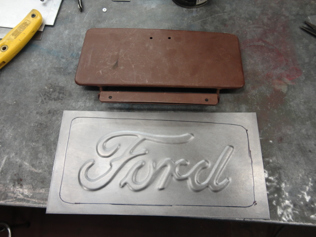

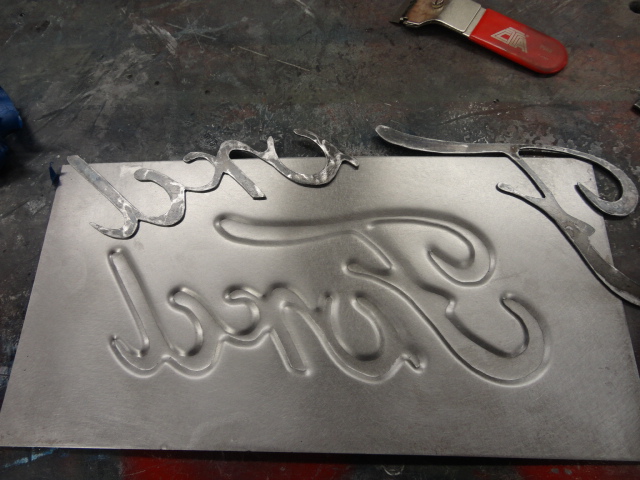

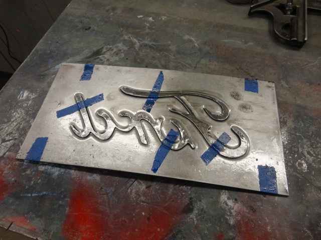

    Here I'll make an actual project. For a long time I had wanted to press the
    classic FORD script, but had troubles making a good pattern. I had some local
    guy's with a computer controlled plasma that made one for me. They had a
    lot of problems cutting 16 gauge because it would warp as it was being cut!
    Water jet may be a better route. After hand finishing them I had a set of dies
    finally.
    This pic shows the female die on top of a piece of 19 gauge CR steel.
  15. Rich B.
    Joined: Jan 23, 2008
    Posts: 761
    Rich B.
    from Portage,IN
    Locating the male die for scribing.

    Already to press, both female die, and blank are the same size so no need
    for locating holes.

    No need to show pressing, here it is after. Notice the oil all over.
    -Brent- likes this.

    Here it as after popping it out of die, just reverse dies to inset pattern.

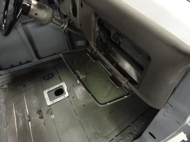

    Here I'm using it to make a new glove box door.
  21. Rich B.
    Posts: 761
    Rich B.
    from Portage,IN
    I cut a piece of 3/16" plate to match the size of the glove box door, and
    formed the piece around it.

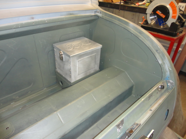

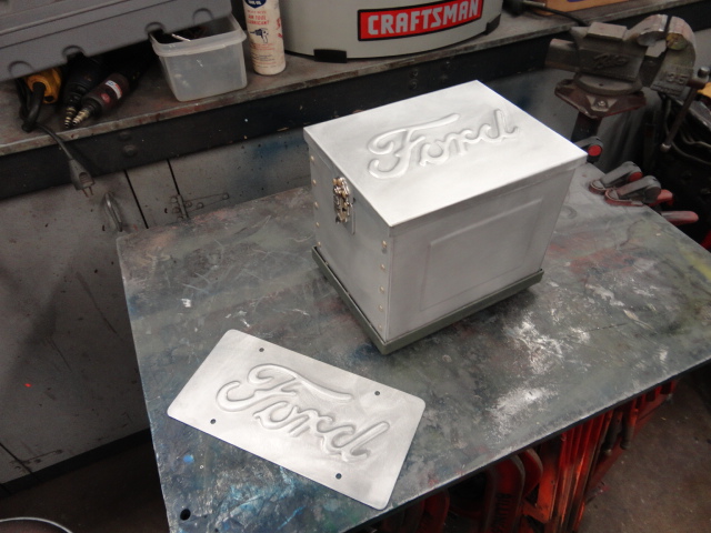

    A254.JPG A258.JPG Had to make some pieces for my friends.
    Wanted to show the simple die that I used to stamp the design on
    the side of the battery box. (sorry for double pics)
    No need for locating holes, die is same size as side of battery box, just
    lined up outer edges after scribing location of male die. Pressed before
    any bends made in box piece. (.063 aluminum) Die is 16 gauge CR.
    bct, Stogy and D-Russ like this.
  25. Rich B.
    Posts: 761
    Rich B.
    from Portage,IN
    Had to keep one for me! The square shape on the front was made the same way.
    I could have bead rolled it, but there is no distortion this way. All the aluminum
    is .063. I hope this helps some one with a project.
    Rich
