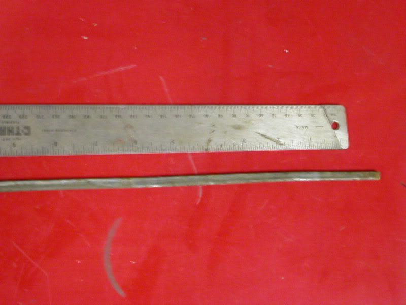

    I traded for this "bundle of sticks" not too long ago. The guy i traded said that there was not one usable bar...
    Plus, the guys at work laughed at me when I got this, so I just had to see what could be done with it.
    Here's the pile spread out a little...
    Let's pick a nice one to start with...
    Hammer it flat...
    But it's still wavy...
    Drive a putty knife in to open it up and start to straighten it out...
    Then a piece of 18 ga. to get the final dimension...
    It's getting closer...
    Now I've got a pile of "kinda" straight one's going...
    Now the whole batch is reasonably straight...
    So I turned my attention to the surround...
    The bottom was pretty bad. I had another stainless trim piece, so I popped the old one off, hammered and tweaked until it fit the shell. The replacement trim went on real easy. I then straightened out the two cross braces using the shrinker and started fitting bars in place...
    I ended up with 30 of the 43 bars...
    ...but it kinda looks like something usable now, with just a few hours of work. I was looking for a shell and insert for my sedan, this came along, so I thought I'd give it a shot...I'm happy I did.

    "I then straightened out the two cross braces using the shrinker and started fitting bars in place..."
    Can you explain how you use the shrinker to get the cross braces back into place? This is another great post Neal.
  8. NealinCA
    Joined: Dec 12, 2001
    Posts: 3,443
    NealinCA
    As you can see here...
    ...the cross braces were bent pretty bad. When I tried to straighten them out it was obvious they were stretched, as they wanted to pop up/down and in/out. Shrinking the back flange straightened them right out and made them strong again.
