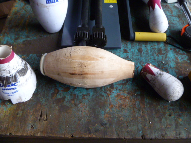

  5. SJR
    Joined: Feb 17, 2011
    Posts: 126
    SJR
    picked up a couple bowling pins
    plan to make a few different hammers out of them, they are laminated Oak
    got them Free just called them up and asked if they had any damaged pins they were going to throwout , got 4 of them
    might make a small hammer with the end piece, these had a thick layer of hard plastic on them , may just leave that on for a hammer, still need to find some handle material

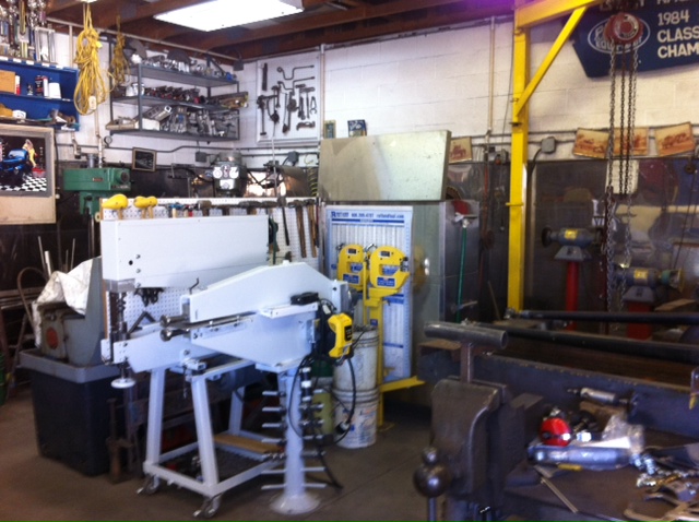

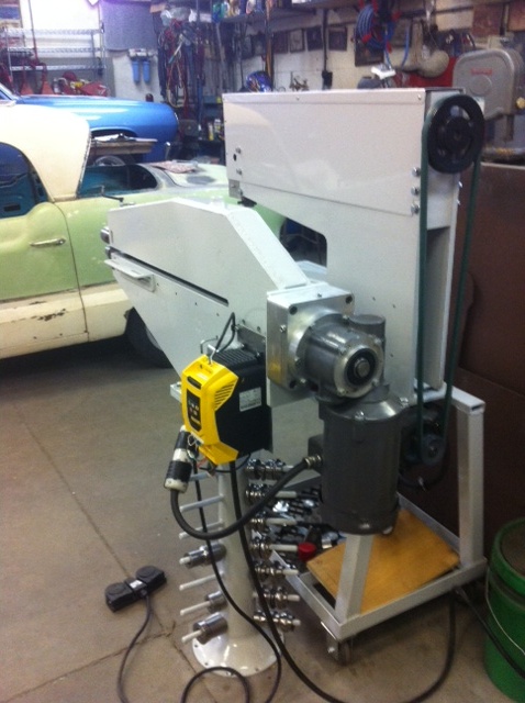

  9. nxcess
    Joined: Mar 30, 2013
    Posts: 109
    nxcess
    from Mesa, AZ
    I made these this past year for my shop.
    A HEAVY DUTY bead roller and a pullmax type mini-hammer.

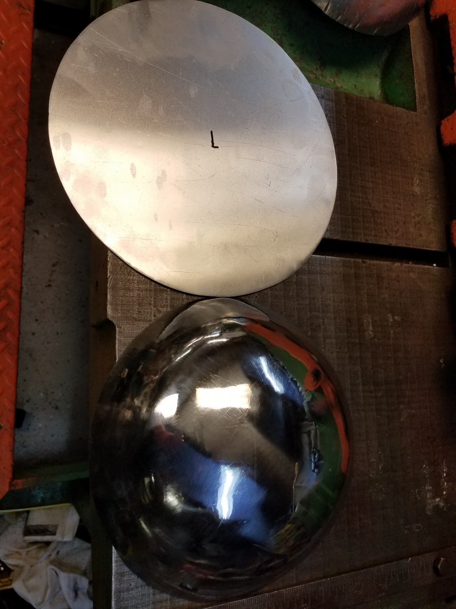

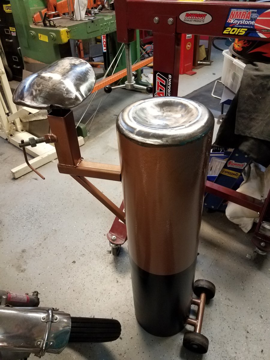

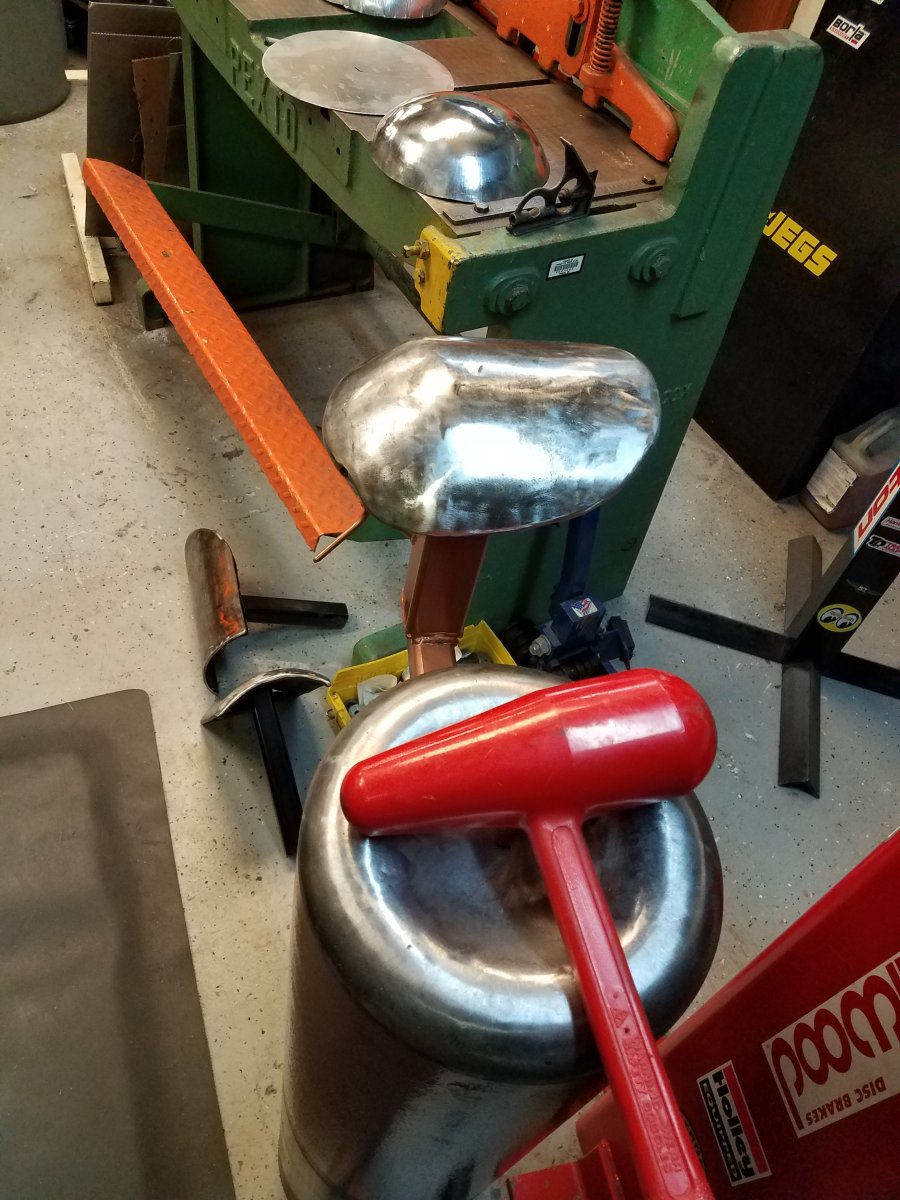

  26. slomotion34
    Joined: Jun 16, 2013
    Posts: 5
    slomotion34
    from Georgia

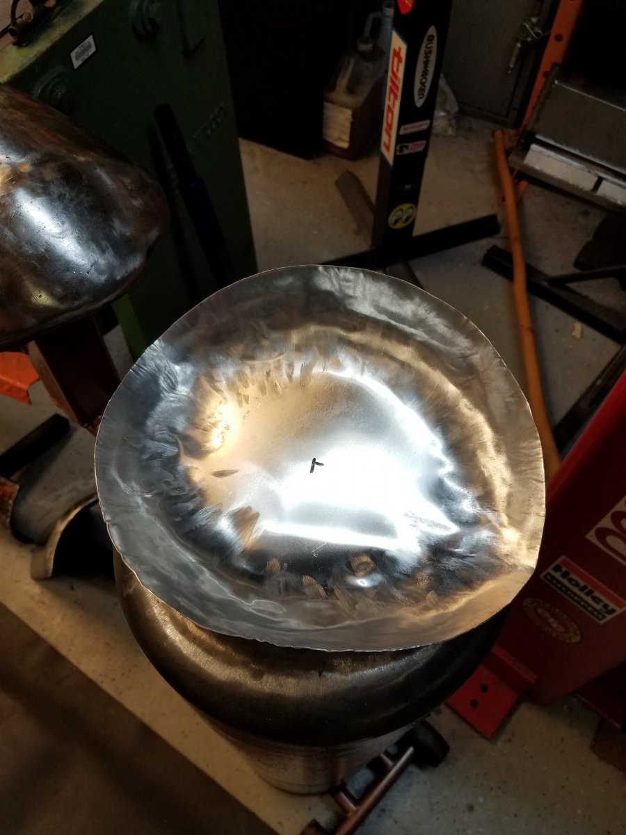

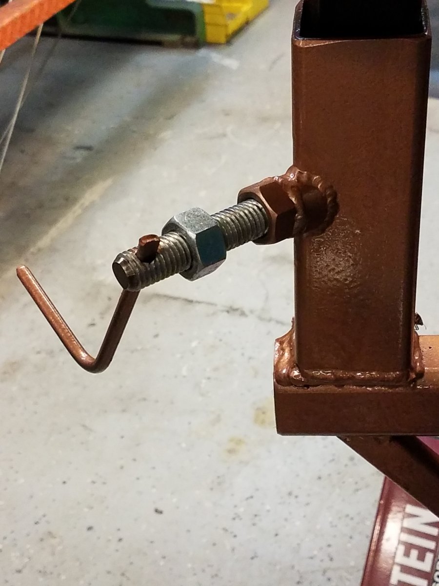

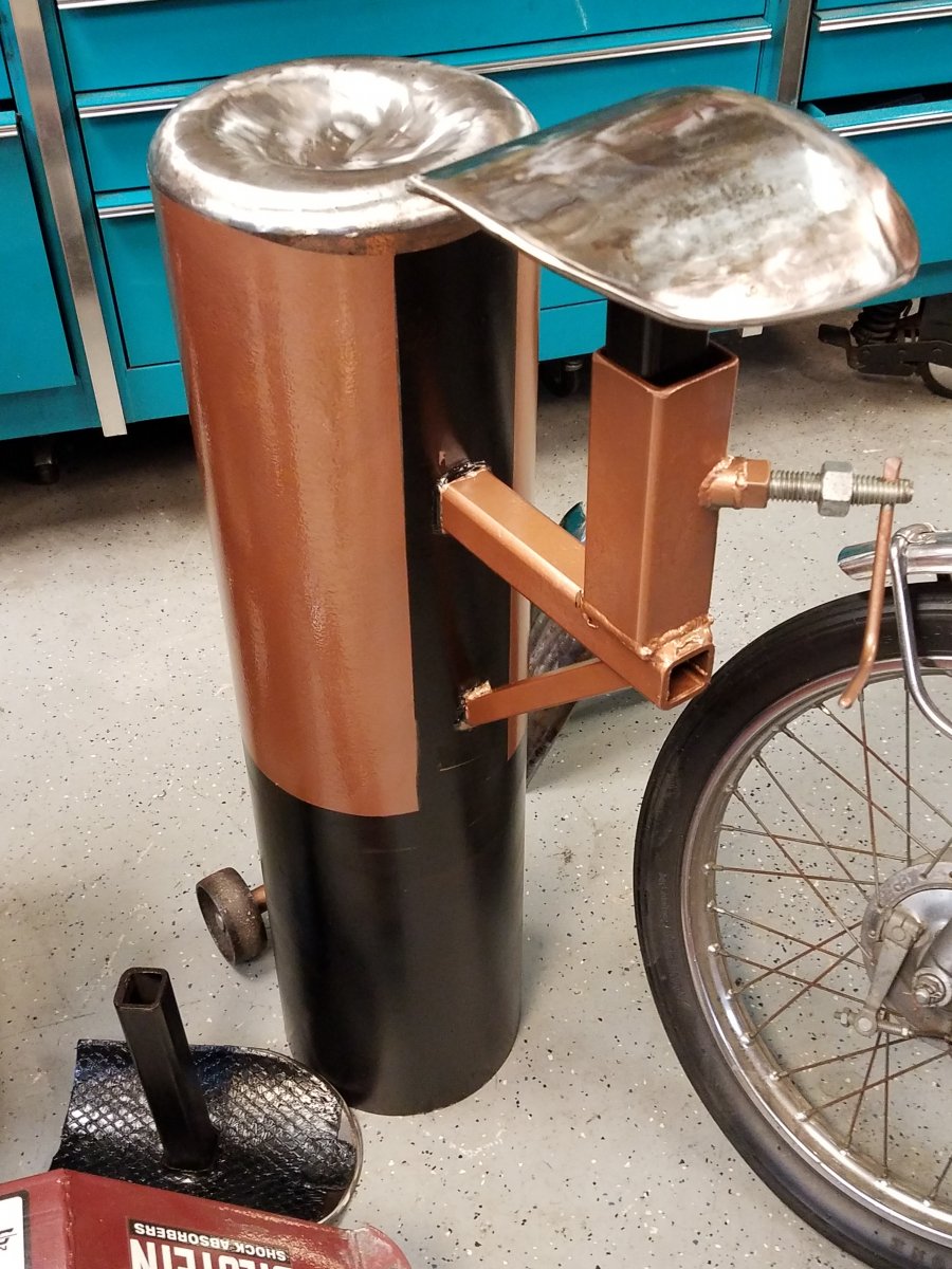

    I am waiting for my oak stump to dry... in the mean time, I saw a video that showed how to make a shrinking "stump" from an old compressed gas bottle. I tried it out and it works great. It also makes a nice stand for shaping dollies (made from the bottle leftovers). Hint: use sound deadener on the dollies - they ring!
    This may be basic as well, but putting the bolt on the corner of the dolly holder allows you to use round or square dolly bases. The wheels are from an old jack... probably only have 25 bucks in the entire thing...the bottle was only $10 at the local gas supplier (they have a bunch of test failures and the old bottles are in their way).
    Hope this helps, and thank you for this post! 20170516_224226.jpg 20170516_224323.jpg 20170518_214800.jpg 20170518_212057.jpg 20170518_214808.jpg 20170516_224307.jpg
