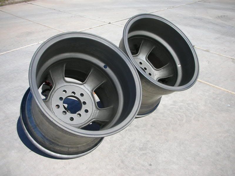

    I just bought a pair of the small mags just like the one in this photo with no name on them. Someone said they may be Superior brand. Help!
  12. Anglia-cars
    Joined: Apr 27, 2014
    Posts: 3
    Anglia-cars
    from Florida
    Just boought a pair of mags just like the one in the front, they have no name on them. I was told they be Superior brand. Help!
  13. bowie
    Joined: Jul 27, 2011
    Posts: 3,104
    bowie
    If they are truly like Shaky's 15x4 wheels and made of magnesium , I would say they are Americans. Near as I know Superior only ever offered aluminum wheels.
  14. Yep, if they are mag they are Americans.
