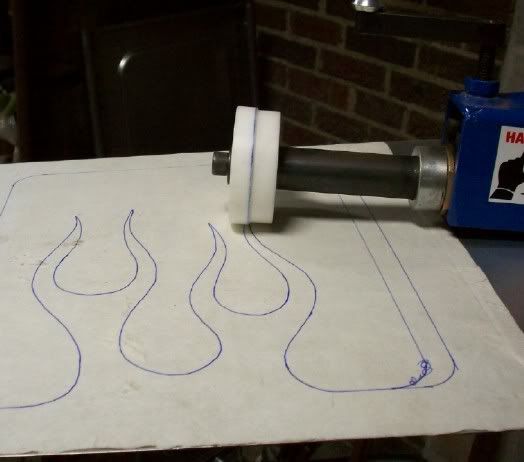

    Layout is by far in a way the longest and most frustrating part of step rolling, especially mirror designs like door panels. I have found the trick to speeding this up.
    Lets start with the design you want to copy,, I'll do something quick and easy, flames.

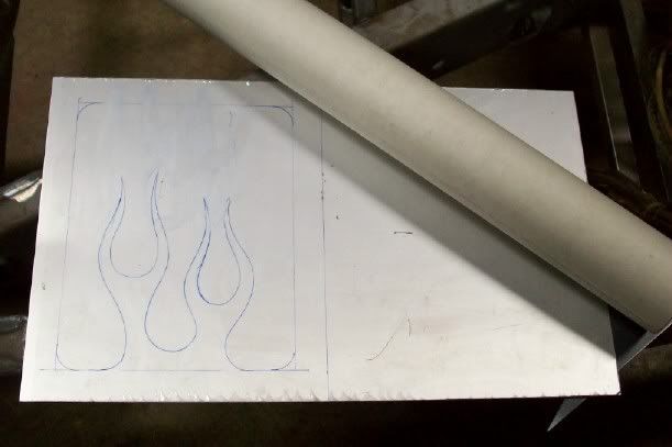

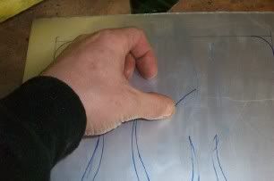

    I like to draw the design on the aluminum, it erases with a pass of the thumb,, which then gets tranfered to your nose, forehead, ears etc.

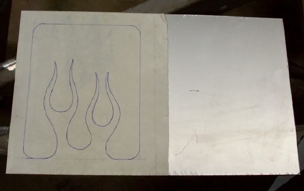

    Here's the key ingredient to this mix,, white transfer paper, paper on one side,, adhesive on the other. You can get it from vinyl graphics shops.

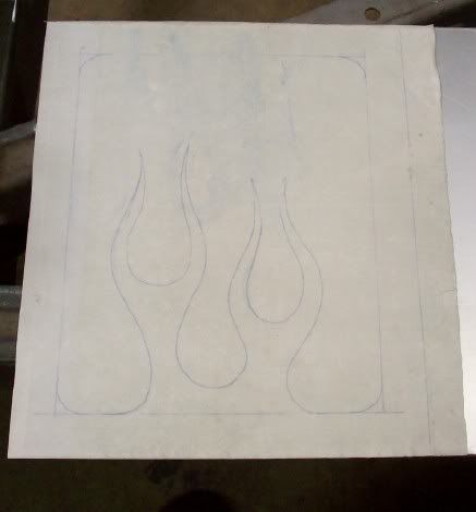

    Lay down a layer of transfer tape over your design, the design shows through just like tracing paper.

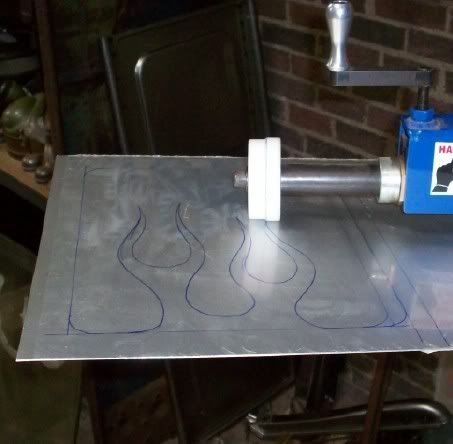

    Trace over your design, and peel off the paper. Turn the aluminum over and stick on the backside. because its already cut to size all you have to do is line up the edges and is located and centered
    Load it up and roll the first side.
    note the direction of the step!!
    After you have finished with the first side, turn the rollers around,, face the step the other way.

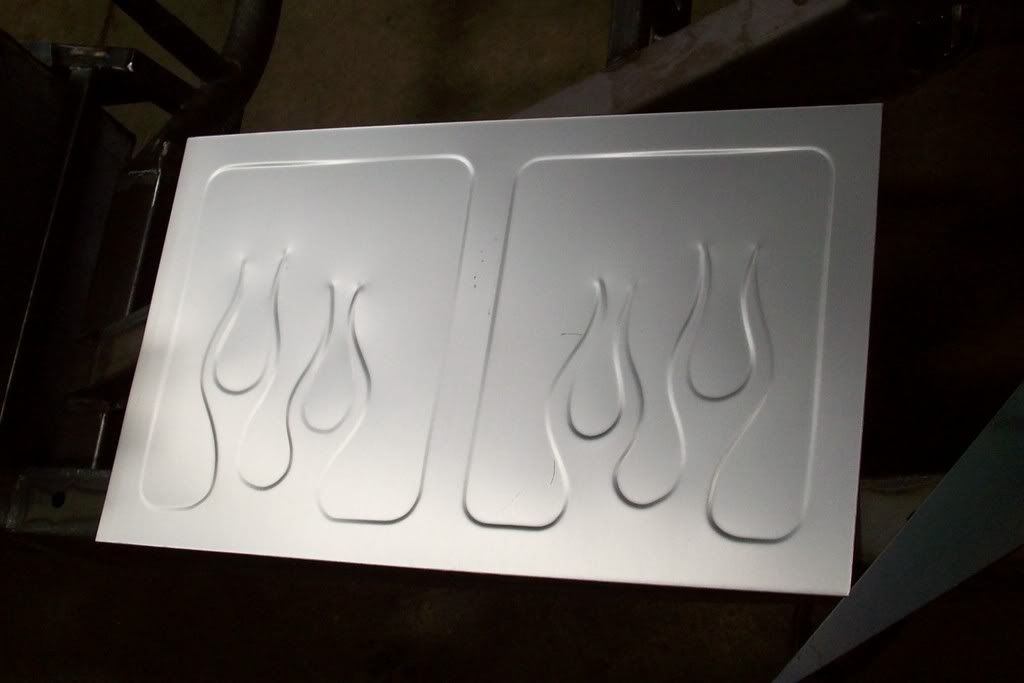

    This is what you end up with,
    The steps done from the backside are going to be one step roll width wider than the ones done from the top,, but on opposite sides of the car noone will see it.

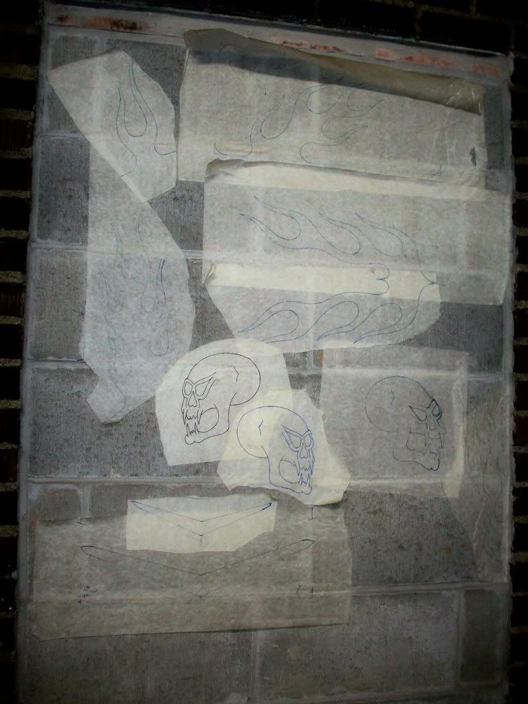

    I save the transfers for future reference, just stick them to the wall
    Hope this helps:D
