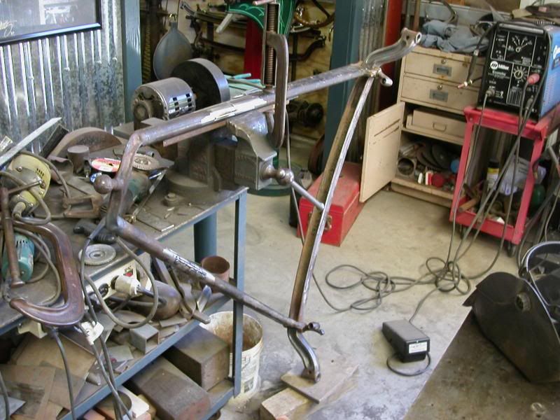

    My 32 sedan has cruedly split wishbones and I want to put a stock wishbone back in...but I didn't want to pay "32 prices" for one.
    I found these split 32 wishbones at a swapmeet for $10...
    and rounded up a free model A wishbone as a donor...
    and figured I could piece them together something like this...

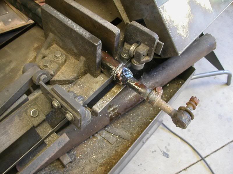

    I started by cutting the discards off in the bandsaw...
    The tube size matched up real well...
    but the angles weren't so great...

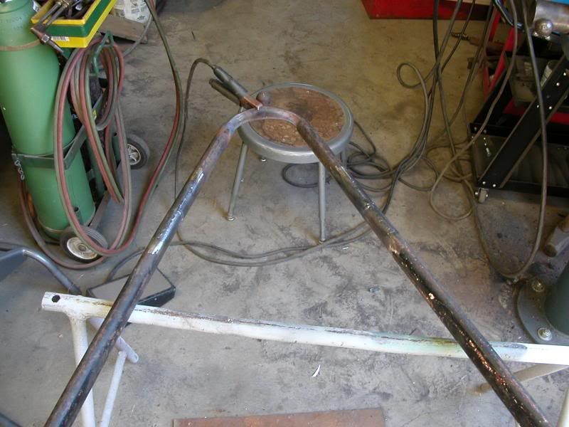

    I made a template off of a stock 32 wishbone...
    ...and you can see the Model A piece needed the tubes brought in some, so I heated and bent them in until they matched the angle of the template.
    That helped things to line up and look like it might fit together...

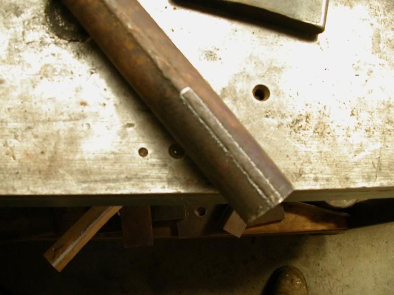

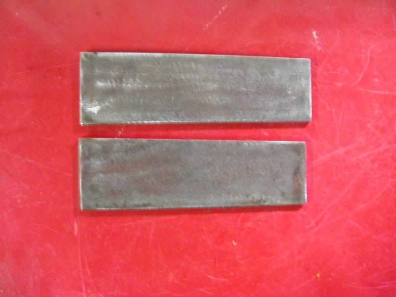

    I didn't feel that just butt welding the tubes together would be strong enough, so I made up some 6" long 3/16" plate splines. The tubes taper front to rear...so the splines are a slight wedge shape. The mill was good for a quick trim of both plates in one pass...
    Cont...

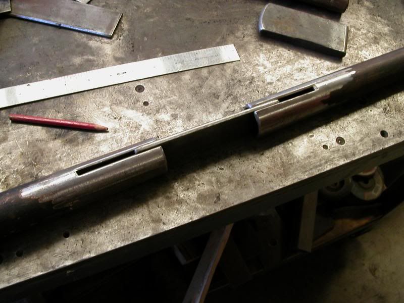

    I marked out the slots in the tubes...
    and opened them up with a cut-off wheel...
    Then they were ready to slide together...
    With all the the edges beveled, I started tacking...
    I had the axle pinned in place with perches, to make sure everything stayed lined up...
    Then finish welded...
    and cleaned it up...
    ...and there you have a $10 32 wishbone...
    ...or as a friend pointed out, at shop rate it would be an $800 wishbone...but who's counting?
    Neal
