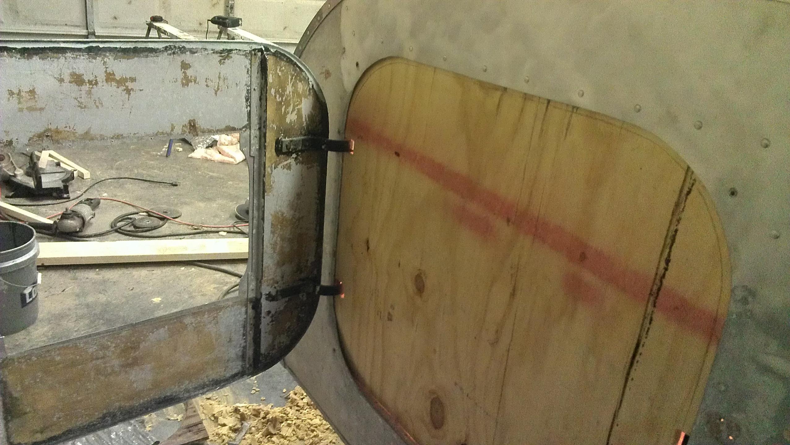

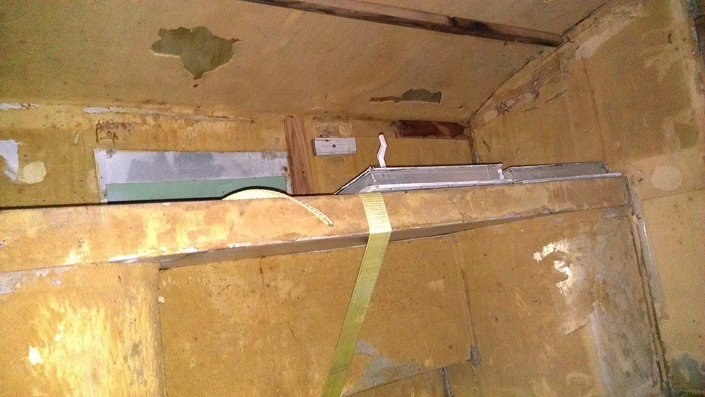

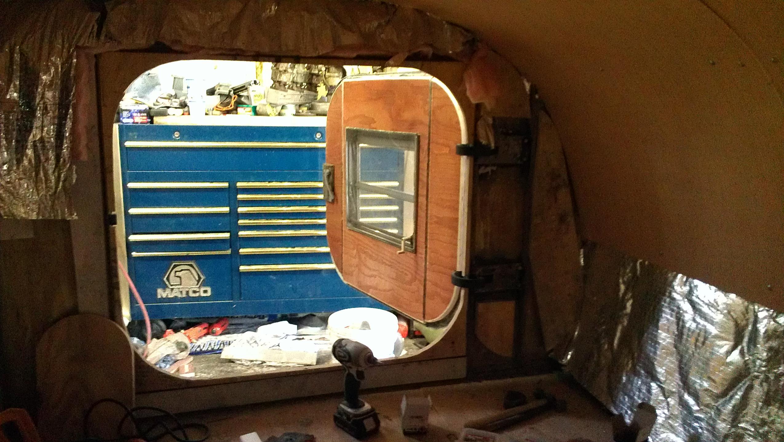

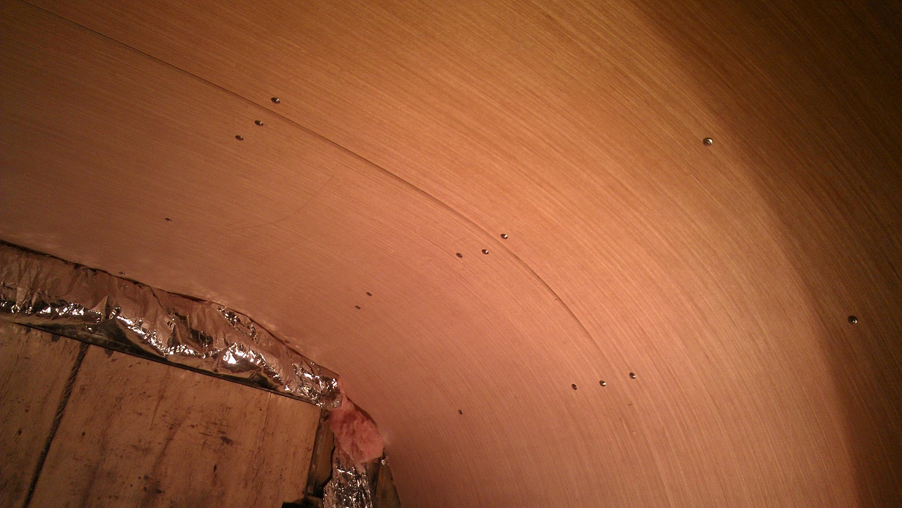

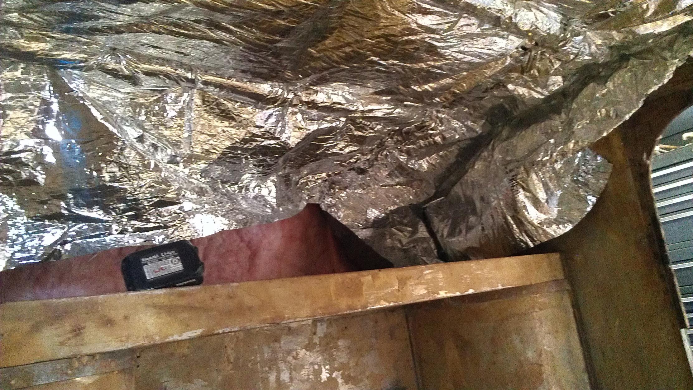

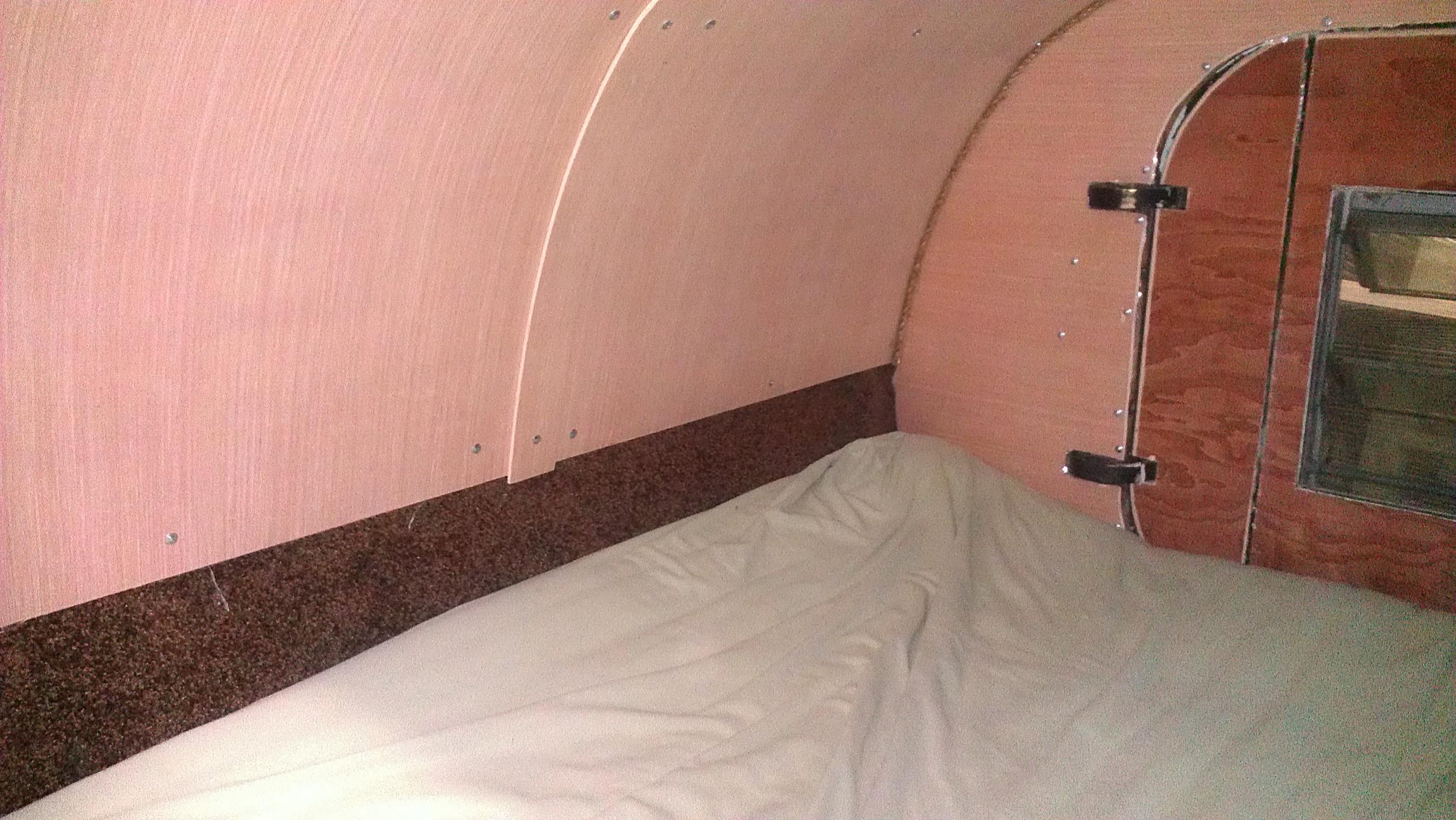

    Been working on a teardrop I picked up on turkey day last year. I have had it out a few times now and its a blast.

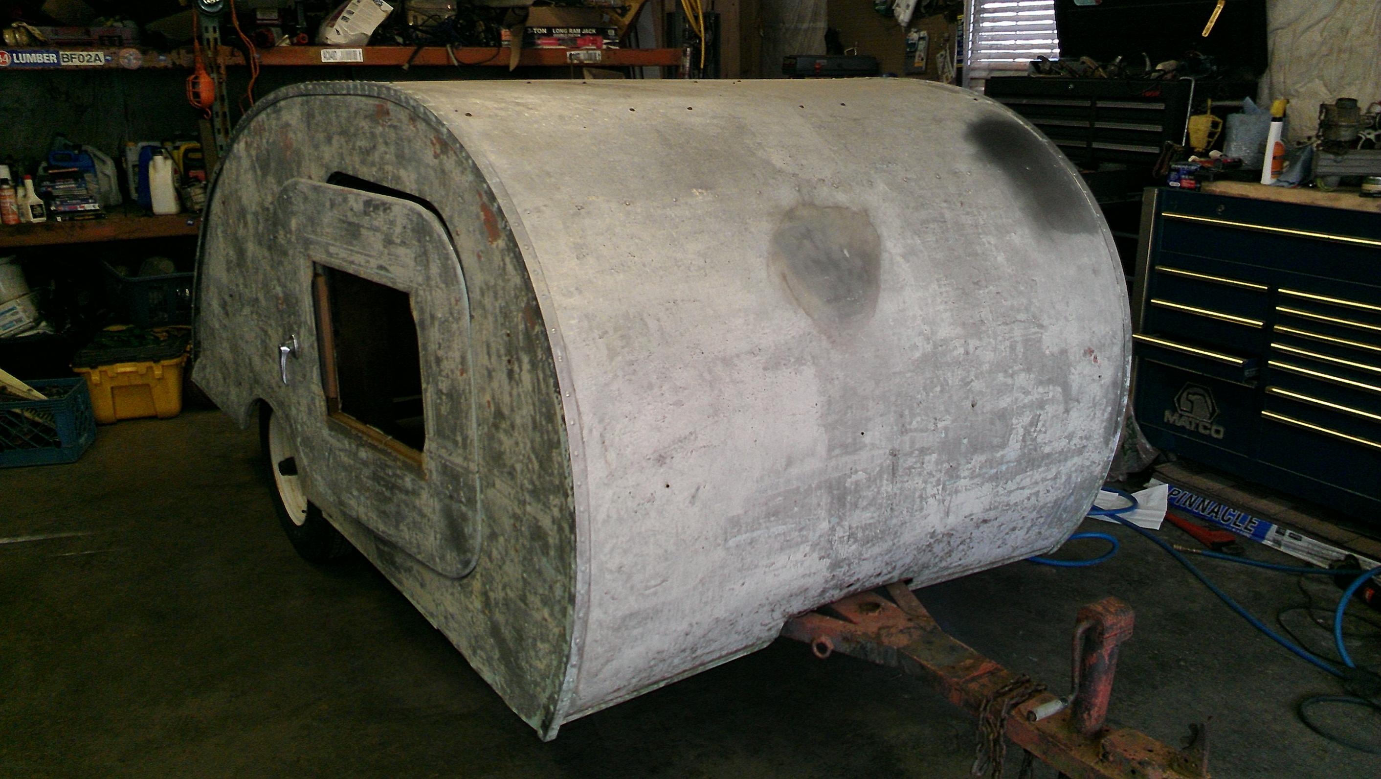

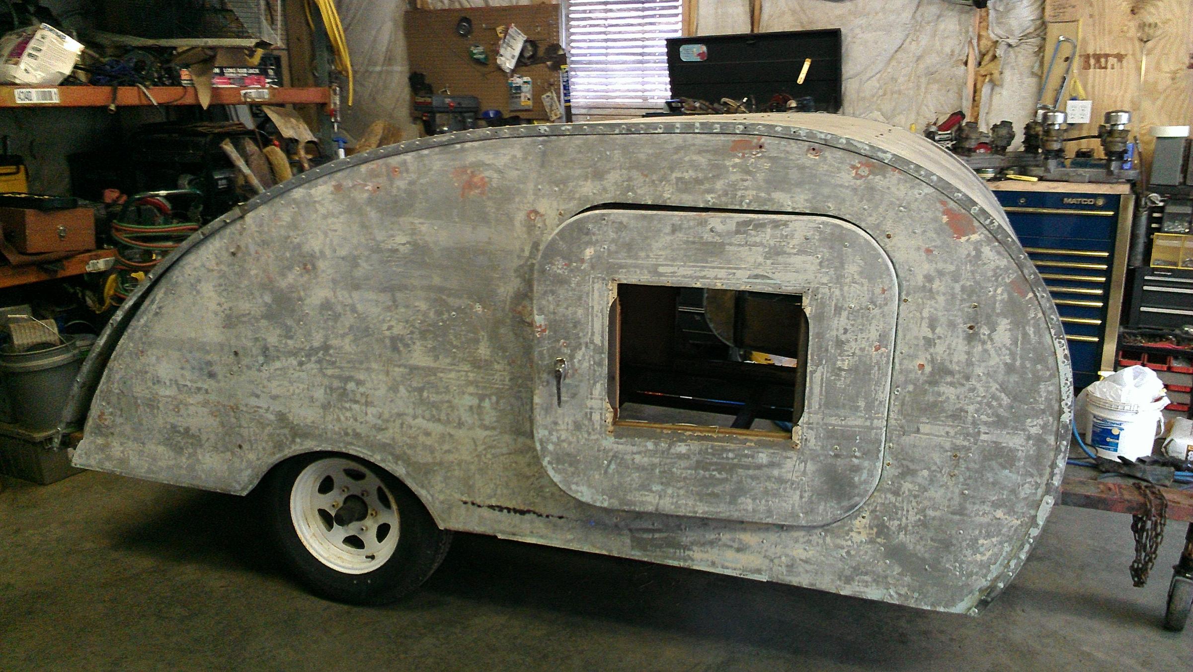

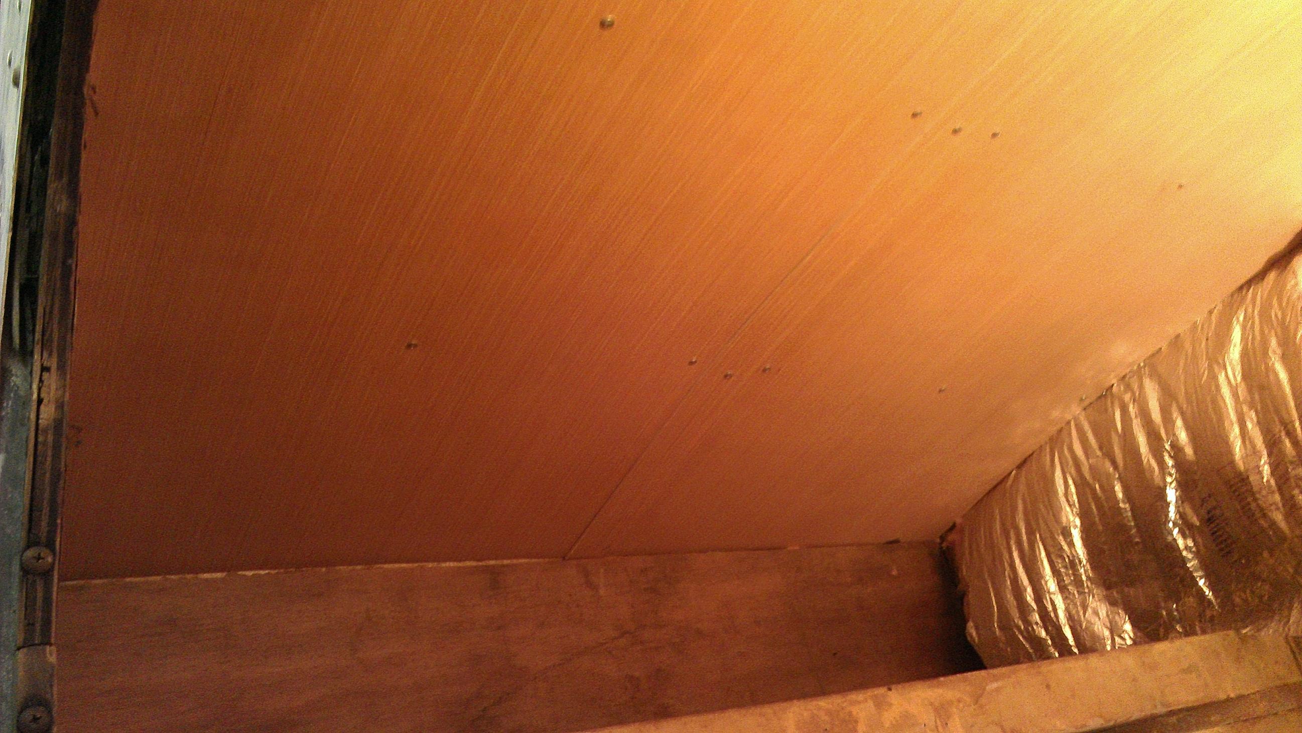

    more pics

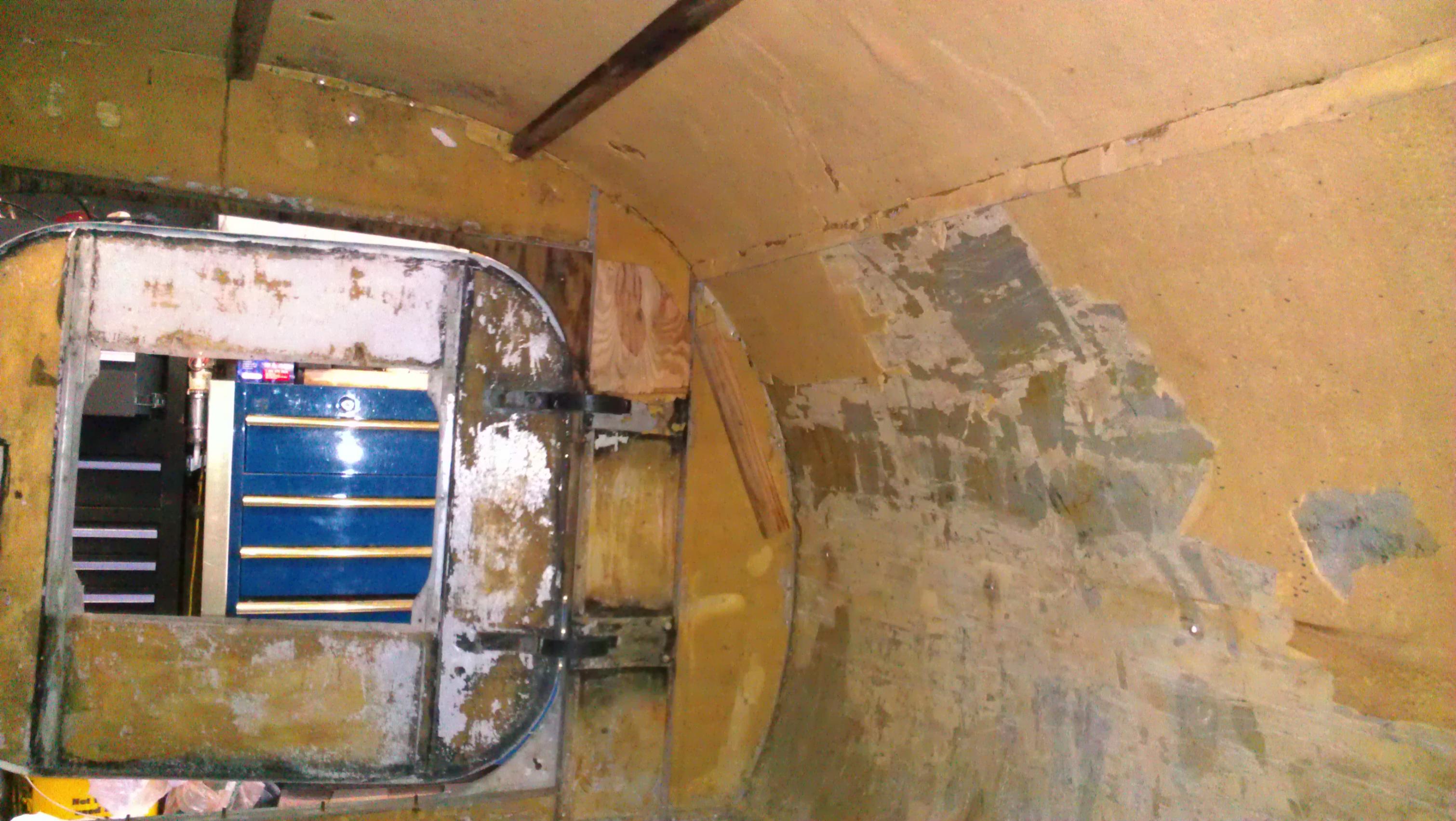

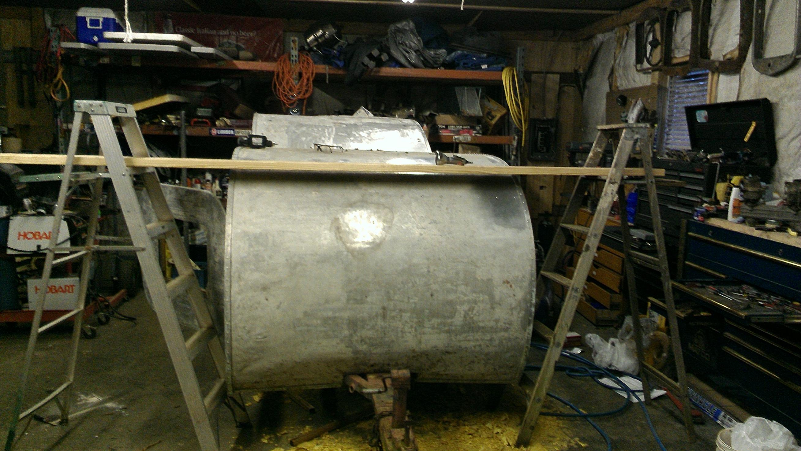

    moving along

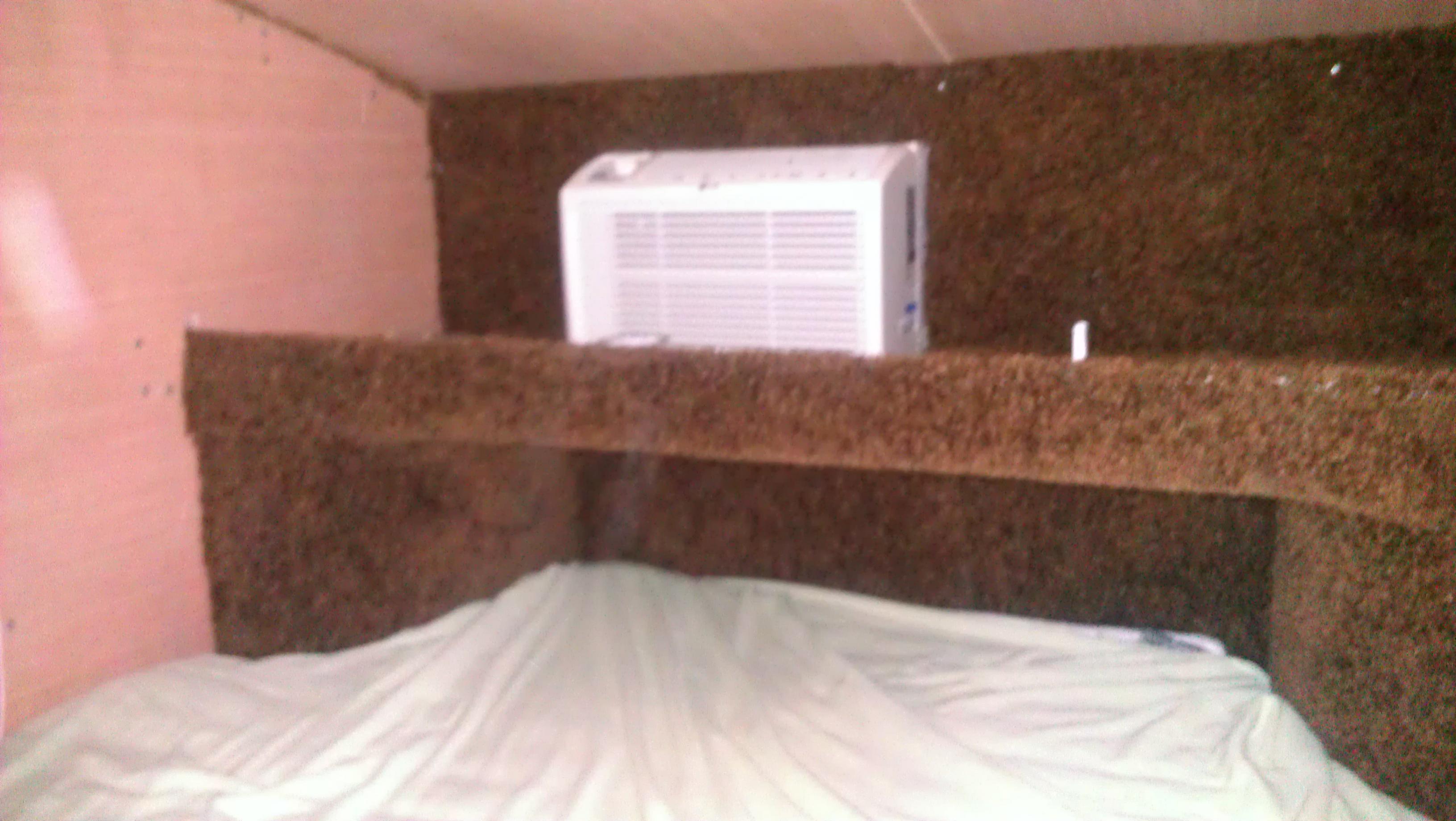

    movin on

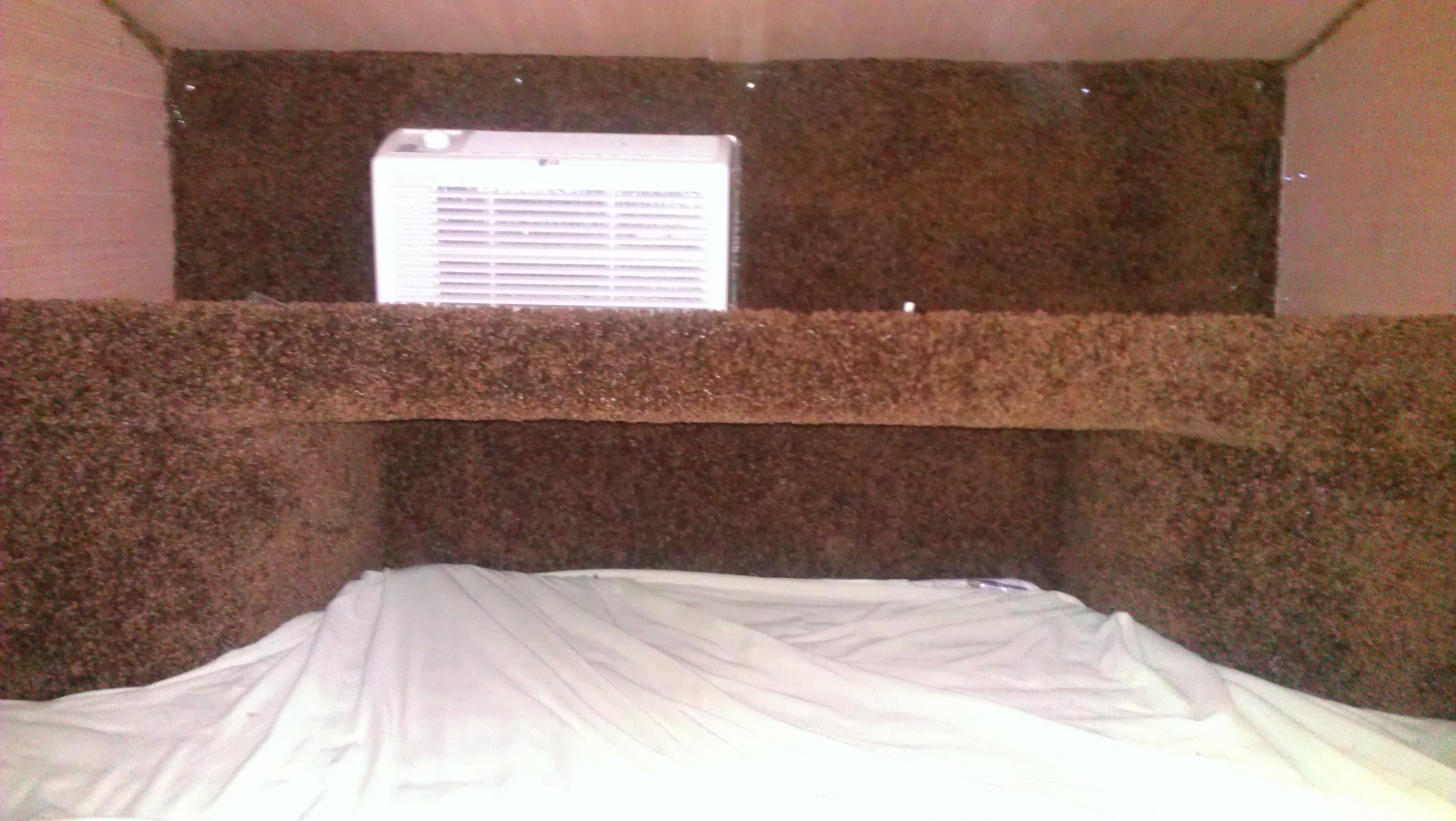

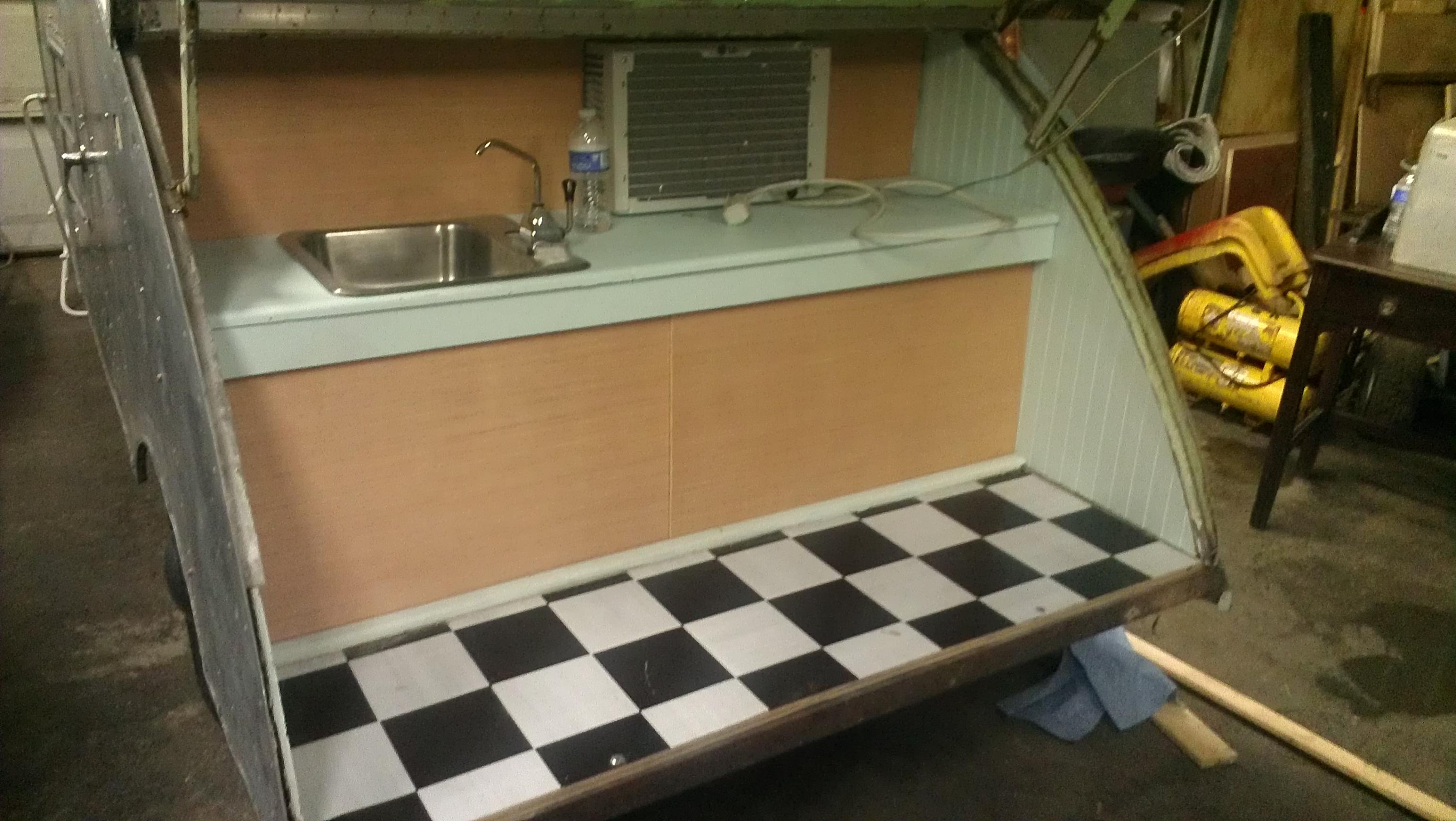

    that's it for now. Still needs some finishing touches but it beats the hell out of a tent.

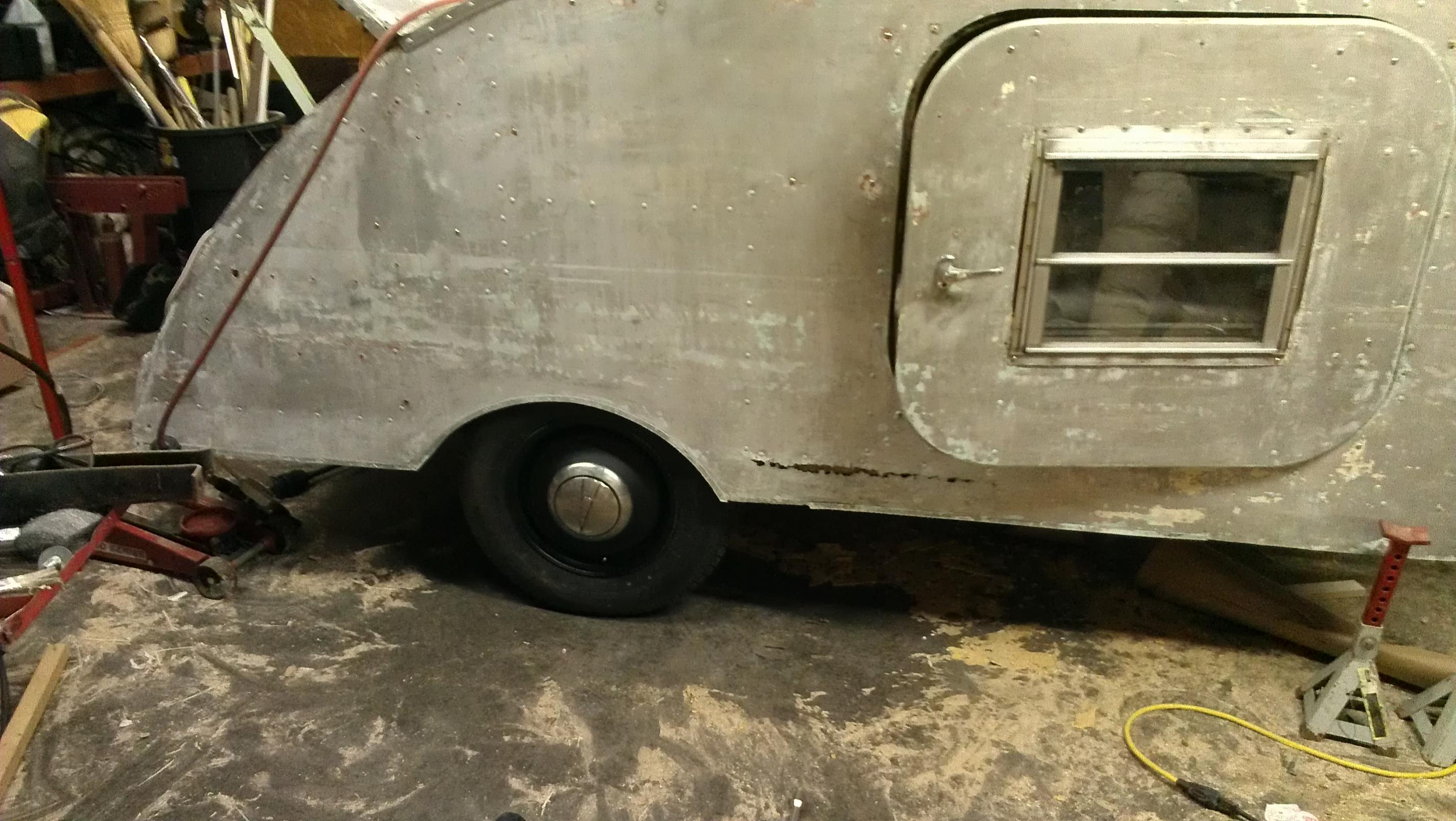

    not sure yet. I would like to try to shine up the aluminum but it has been pretty abused over the last 65 years. Someone took a wire brush on a grinder to it and I would have to try to get those scratches out somehow. Im not sure how to go about it yet.

    Depending on how deep the scratches are, you'll have to start sanding with a courser paper 600 - 800 maybe, final sand should be 1200. That should clean it up providing wire brush scratches aren't too deep. After scatches are removed, if you don't want the upkeep of polishing, a wash with "StreakMaster" or "AlumaBrite" every few months keeps it looking original.

    I don't want the upkeep of polish. This sounds like a plan to me. I assume this is all wet sanding? Any more info on this would be good.

    I was looking at a 1951 canned ham today,,you can polish them but that will just highlight all the dents you have yet to notice..paint is the way I would go,,,nice trailer ya got

    I don't know what it is about these little teardrops, but seeing one makes you want to hit the road and explore the country. You are doing a nice job on that one, and you were smart to add air conditioning. :)
