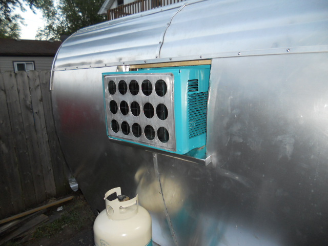

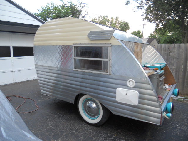

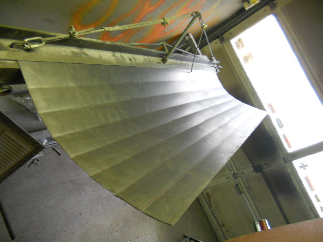

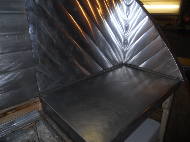

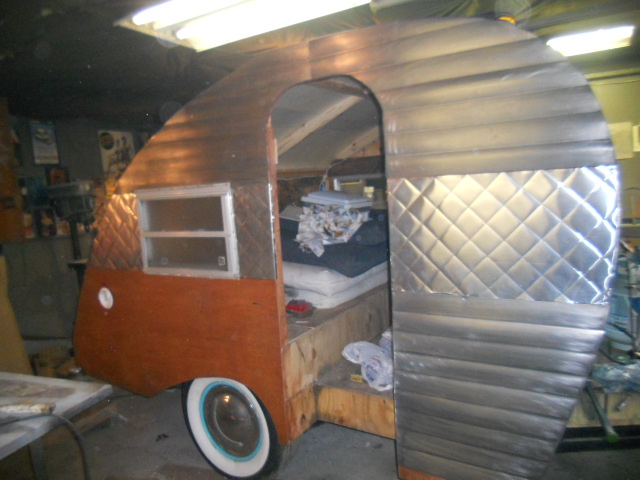

    i di the aluminum. you can cut it with tin snips. .30 is all the thicker you will need.
    as for the bondo and wood idea. they both attracted moisture and expand and contract differently thru-out temp. ranges, so like stated befor you'll get cracks. if your really not into aluminum, try fiberglass alittle messy but secures to wood better.
    heres a few pics. of my build.
    george.
