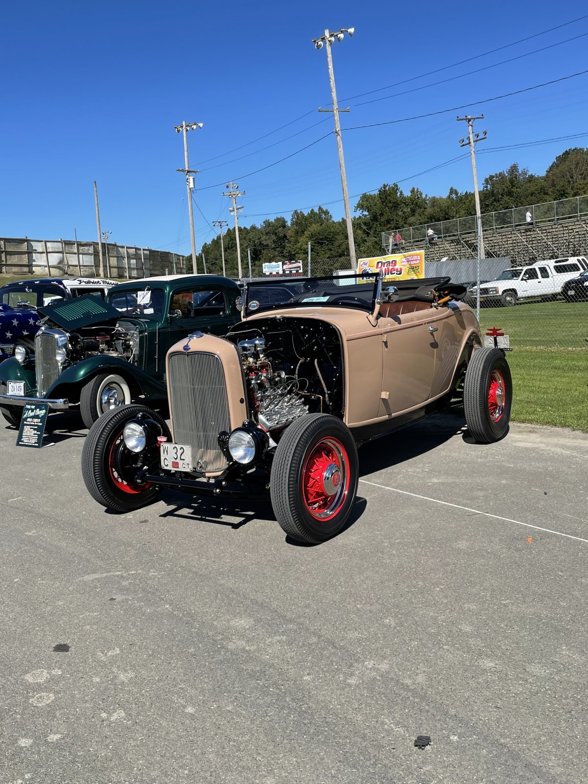

That's a great example of a 50's style Hot Rod, dripping in chrome. The plate is a '56, is that when it was built? Nevermind, I just saw caprockfabshop's post. Awesome photos BTW

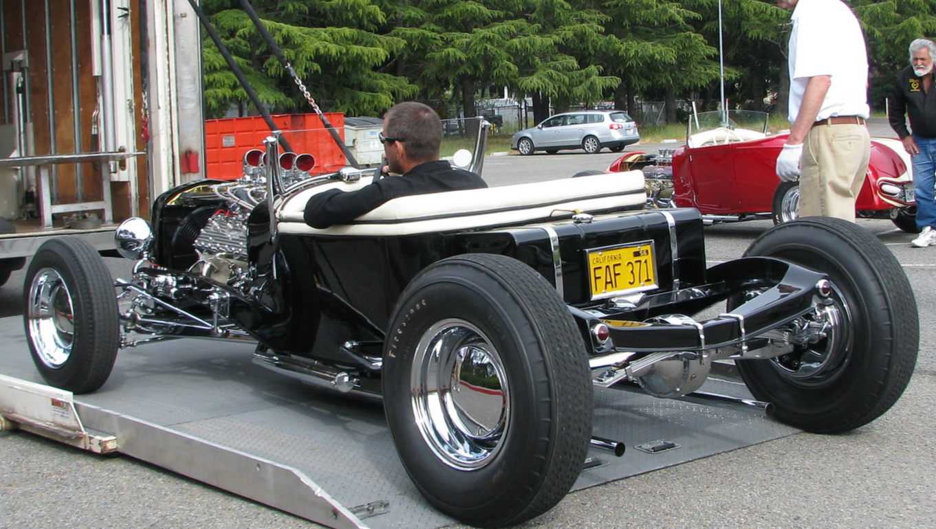

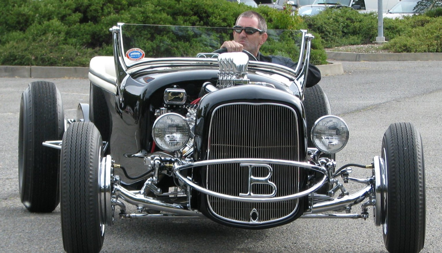

I has order a dropped semi polished 34 axle from Anson, ready for chrome shop here in Sweden. But after look more on the McGee roadster I would say a chromed axle should been nicer....but....the more I did look the black axle/springs and the nickel plated drum shields and a chromed bone, shocks, draglink and ends is a very neat combo !
The McGee polished but black painted front axle changed me from a chrome one. See that car got me into nickel even if it had chromed parts. The cad plated parts is really cool but some of my parts is rust pitted ( its not bad parts but pitted ) The tone of nickel is really nice even if it was not really late 40’s. I had been into chromed springs but I like Henry parts and I’m into my second A-spring now and today I will look in a T-spring. They get carved out in the end. So if I had them black I could sand them of. But yesterday I might saw a game changer ! No news on black & some chrome is one way ( as not a full chromed front/rearend ) See this racing build-up model A has allot of black, even brake shields but allot of parts is nickel, and its really tasty. It gets me paint parts instead of chrome it ( less work, or more easy work ) but it get me back to chrome springs and a polished QC ( and the Ardun heads ) ——-/——-/— A note. This 28 roadster is build by pro and paint and chrome is done for win LA roadster show !

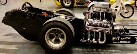

Ewell, Stecker, Kamboor FED Hello, Jack Ewell gave us some great advice, like the words of wisdom that Joe Reath and Joe Mailliard used to give us teenagers when we went into their shops to get the next thing in hot rod parts. Since he was the manager of Mickey Thompson’s Shop, it was closer to our house, so it was a natural. The old days of drag racing at Lion’s Dragstrip was the thing that brought us all of those great inspirational talks and advice for a couple of young kids. There were three versions of the shop on the Westside of Long Beach during those times. Jack Ewell is well represented in a HAMB search and there will be some very early history from coupes to dragsters in his repertoire during the very early days of drag racing. old Friday Art Jnaki In our later days at Lion’s and Long Beach, we almost detailed the 58 Impala engine compartment to all black highlights and chrome. The block was going to be black, as were the heads. But everything else was going to be chrome. Valve covers got the chrome treatment, the Moon Breathers got the high polished look and the top of the triple air cleaner also got the shiny chrome appearance. This was in between doing some work on our SBC Willys Coupe after school. So, we had to divide our time doing enhancements or doing some heavy duty building aspects. It was not going to be an overnight job doing the detailing. 1957-60 We realized that more effort was necessary for the Willys Coupe and that the black 58 Impala was going to be as fast as it was, unless we spent more time doing further speed enhancements. So, it was currently, a surf transportation for my brother, a parts runner and a tow vehicle for our Willys Coupe when we needed something done that we could not get in our own backyard garage. So, detailing enhancements for the Impala were put on hold. Once our days at our small backyard speed shop had turned into a surf shop, a desert racing motorcycle shop, remains of our dad's fishing poles, reels and general fishing equipment got enlarged, we looked forward at the detailing that was to come, with more time on our hands. 1961-62 Inspiration came from a highly detailed Hemi motor on the Jack Ewell, Bill Stecker, Jim Kamboor FED, as well as the overall black on black on black look. The detailing went from: thanks, @themoose and finally, a great goodbye with this final look in 1964:
