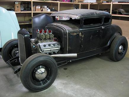

  9. el Scotto
    Joined: Mar 3, 2004
    Posts: 4,699
    el Scotto
    from Tracy, CA
    This is my 6'3", 220 lb gorilla ass in a 4" chopped model a Coupe, seat set all the way back.
