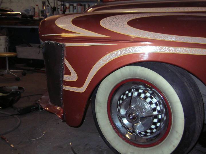

  13. Kartsa
    Joined: Jun 23, 2001
    Posts: 253
    Kartsa
    from FINLAND
    Some progress on the front.
    Parkingl lights will be behind the bullets.
    More to come.

    Wow! That is gonna look so cool! Are you gonna use a piece of mesh, like the hood piece to fill out the area between the headlights & parkinglights? Excellent work!
  16. Kartsa
    Posts: 253
    Kartsa
    from FINLAND
    That is one option.Owner will decide that.

    Nice work and good choice for which front end re-style to go with. The Tailights look great, but the new front end is even better!!
    Totally love the Formica boomerangs - I hope those make it back onto the finished car.

    OK it is done.Final update.
    This is pretty dificult part to make.Start with piece of sheet metal.
    Litlle stretching.I use shunk of lead under the metal.
    Then I use english wheel to staighten those bumps.
    Grille bar mount.It can be adjusted in every direction.
    Outside.
