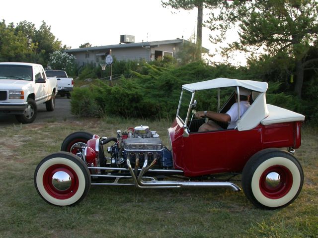

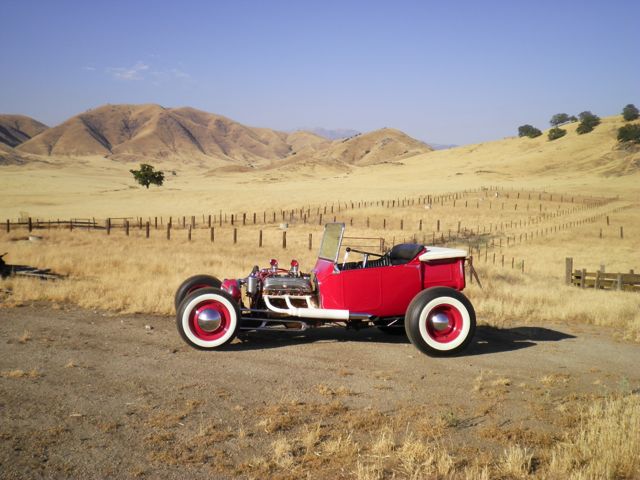

    I agree totally. Avoid the "ugly gap" between the firewall and the engine. As pointed out to me by a professional photographer.
    Small engine, distributer in front and body set back too far.
    First incarnation of my roadster with the 289 Mustang engine and "ugly Gap"
    Second picture with bigger 331 Cad. engine and body set up three inches. I actually had to move the radiator and grill up a couple of inches too.
    Remember an inch or tow here and there make a big difference. Once in a while during your build pull your project out and step back twenty or so feet and just look at the profile.

    Absoltely agree with Steel Rebel. We've use the thickness of your hand measurement when setting engines in and it looks just right. Also watch the space up front between radiator and engine. Keep it tight and all is right.
    Remember an inch or tow here and there make a big difference. Once in a while during your build pull your project out and step back twenty or so feet and just look at the profile.[/QUOTE]
    I see what you are saying with the motor and the space. Wow it does really change the over all look.
    I was thinking about this and I really dont want a lot of space between the motor and radiator.
    Best advice ever given! You can crunch numbers, memorize dimensions, fab everything until all of those numbers match, but dammit, if you step back twenty feet and it doesn't look right, STOP! Figure out what isn't right, fix it, step back again, then move along...

    Don, your engine & body gap isn't noticeable, but then you have a second carb back there.
  28. tfeverfred
    Joined: Nov 11, 2006
    Posts: 15,791
    tfeverfred
    Wow, Rebel! That body is set back far! Did you end up moving the engine back or the body forward?
