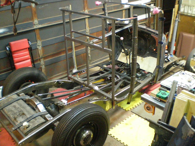

  1. I'm finally getting to a point where I can start assembling my Model A Coupe from parts collected to an actual car. I have enough to build a five window coupe. My problem is that its a 1928-29. The parts I have are mostly Sports Coupe/Special Coupe items.
    I know I'm not reinventing the wheel here. I know some of you guys have replaced the wood supports in your coupes to metal tube framing for rigidity. If I were restoring a stock car, I'd use a wood support kit. I'm not doing that. I want something that will last as long as I do.
    If you have pictures of your metal structures with which you've replaced the wood, I'd love to see them.

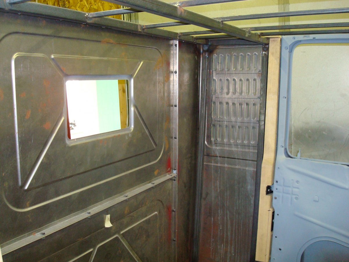

    It’s not an A but here’s what I’m doing for my deuce Tudor. It’s just 18 gauge formed on my brake, shrinker/stretcher, and dimple dies.
    I had the same thought. I could of bought the full wood kit but I wanted a different look. I’m not running any interior and all of this will be exposed. Plus I didn’t feel like dropping the extra $1000 or so in the full kit. I did keep the roof wood for a contrast.
    kadillackid, nochop, TFoch and 6 others like this.

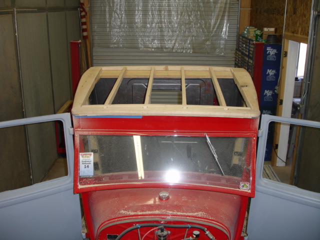

  5. denis4x4
    Joined: Apr 23, 2005
    Posts: 4,363
    denis4x4
    from Colorado
    I did a steel roof on my ‘29 CCPU with a 6-1/2” stretch. Redid it in wood. Some steel, but a lot of repro wood pieces and some custom white oak pieces I fabricated 01EE54B0-1467-49CC-89DB-79983BFCD636.jpeg DDE40AF3-29CC-4613-AD2C-B01402B5B87E.jpeg
    kadillackid, cactus1, Packrat and 2 others like this.
