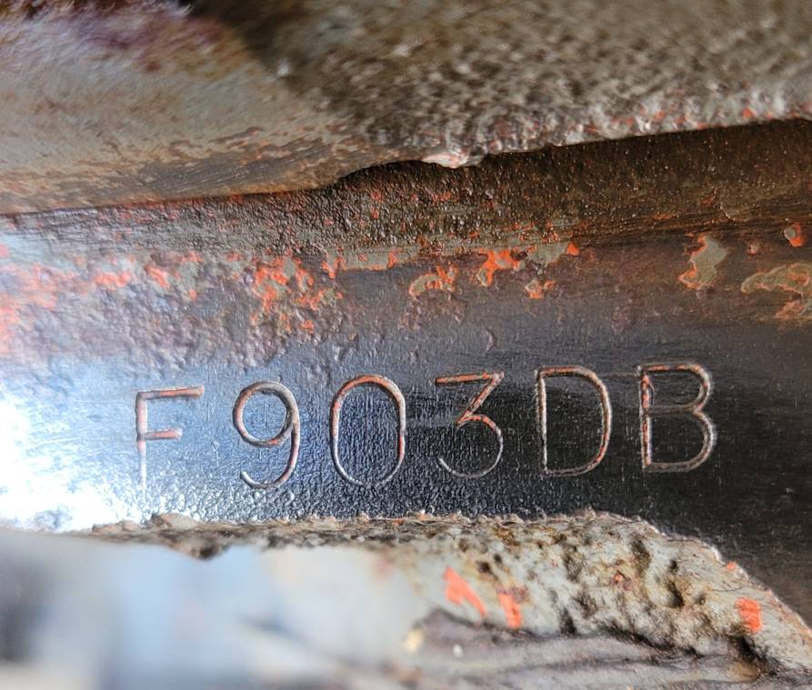

    Anyone have any info on the DB suffix below on a sbc 3737739 283ci F is Flint, 9-03 September 3rd. 20211120_115224.jpeg

  10. squirrel
    Joined: Sep 23, 2004
    Posts: 59,262
    squirrel
    283 Powerglide 4bbl.
    if you want to know the year, look for the casting date code on the back....not far from the casting number, it will be a letter followed by a few numbers. The last number is the last digit of the year. So H 23 8 would be August 23, 1958, for an example.
