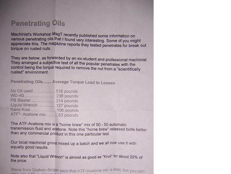

  17. mgtstumpy
    Joined: Jul 20, 2006
    Posts: 9,214
    mgtstumpy
    Rusty bolts.JPG I came across this some time ago but haven't used it.
    Michael V. Brown likes this.
