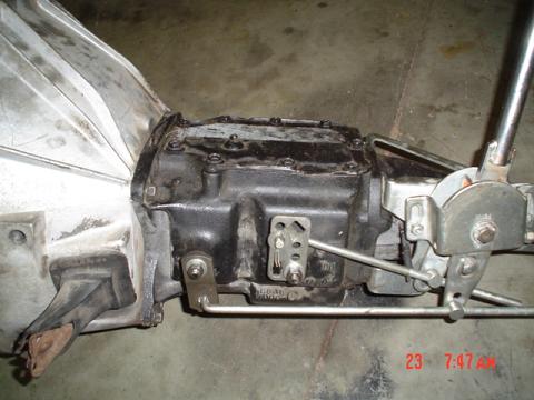

    ...and this one is the common Ford 3 speed toploader aka 3.03 aka RAN or RAT or T&C, produced from 1964 to 1981, or so:
    oldandjaded and 1oldtimer like this.
