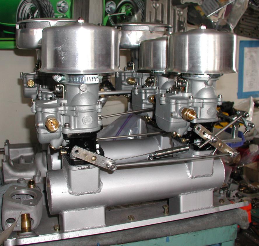

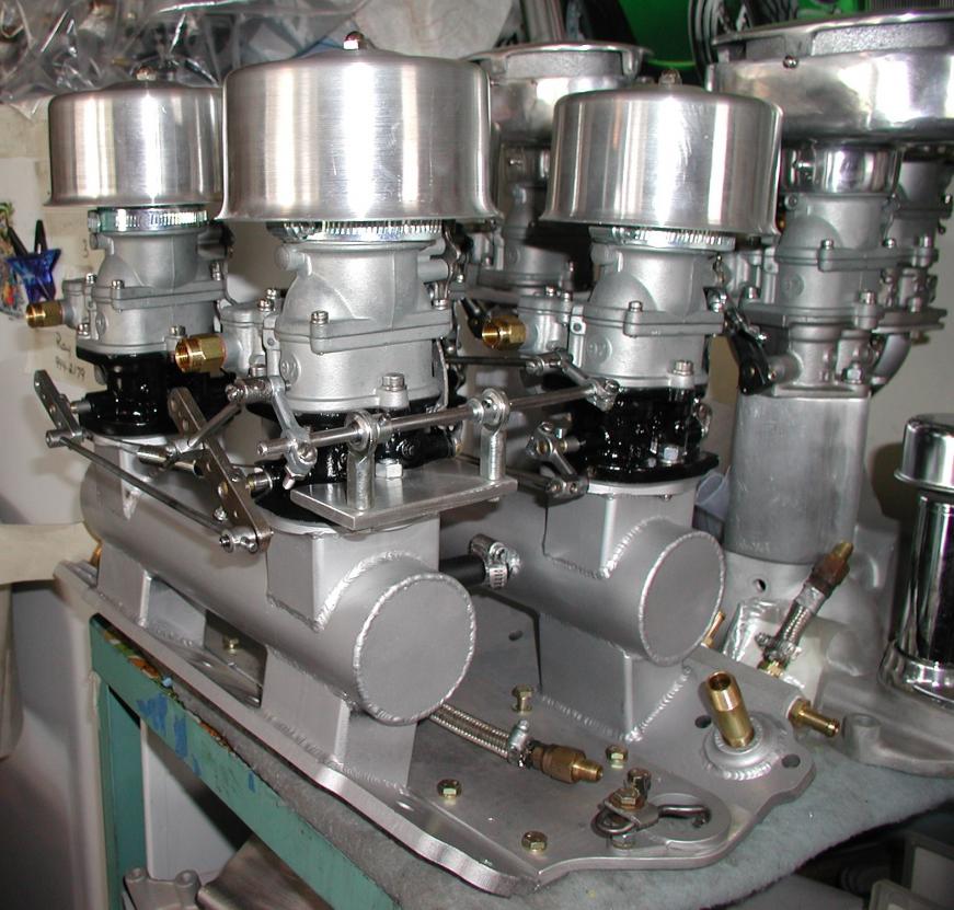

    Hello..Here is an idea..A custom built 4x2 with Strtomberg 97s
    Duane.

    The Frenz..Yes, I sell custom intakes, Stromberg 97s and custom built linkage..PM me with you email address and I'll send you some pictures of my work..
    Duane..
