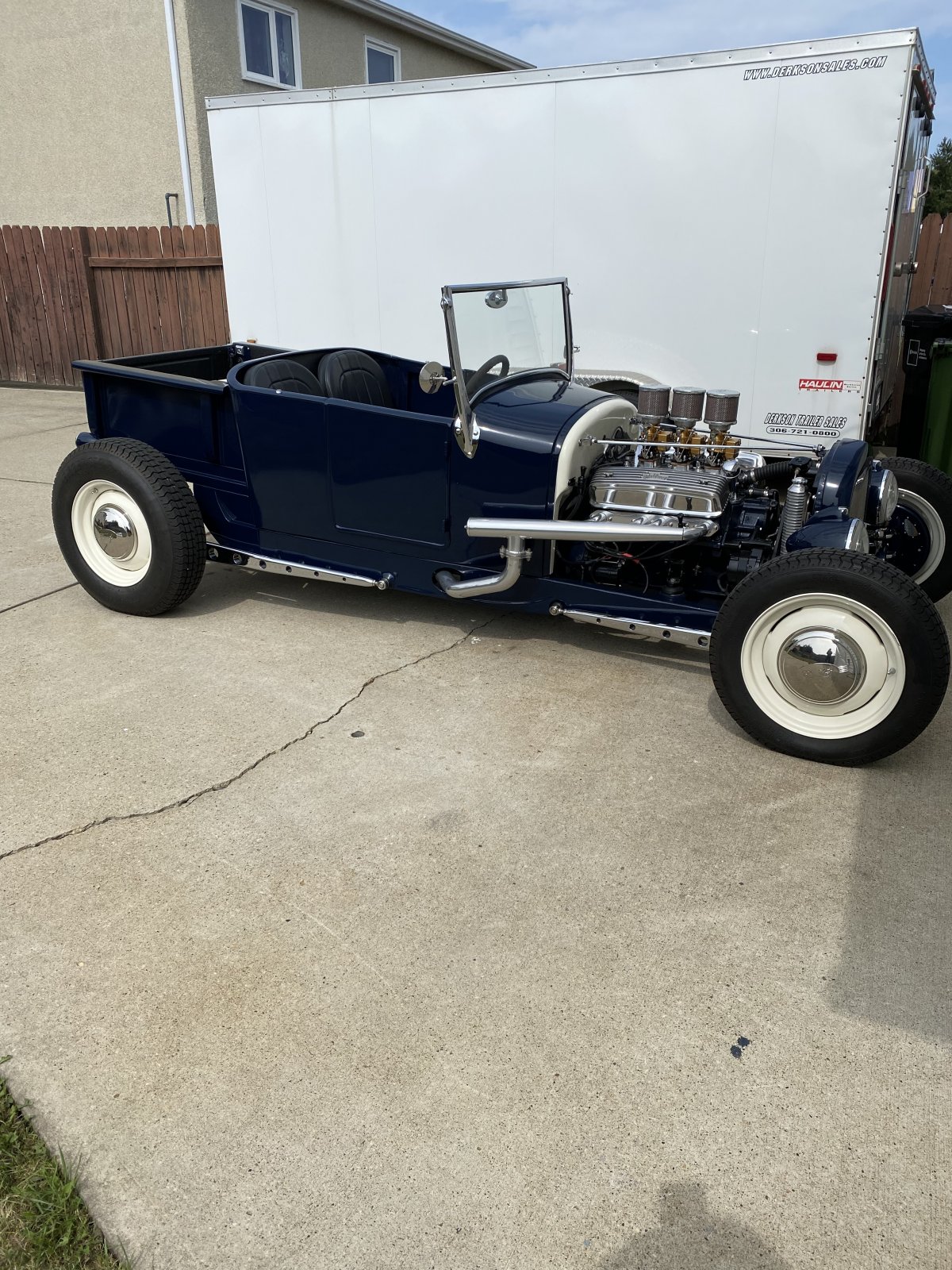

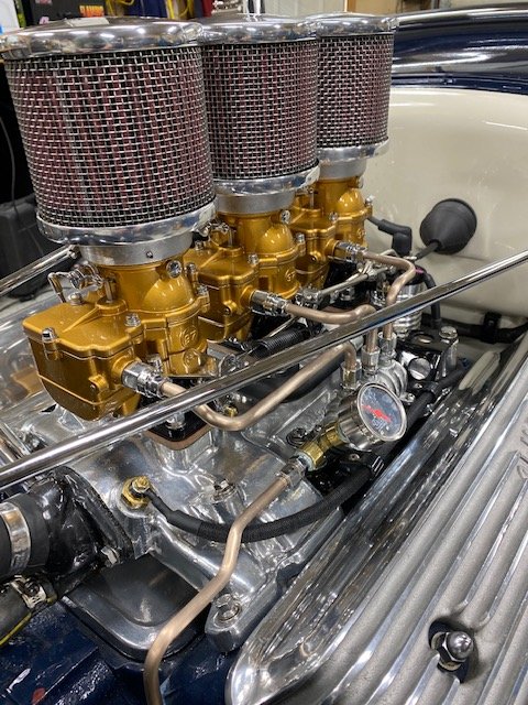

    Stromberg 97’s from Clive on my Y Block.
    E2E45B90-D54F-45EC-A2C0-2D38CCAD5CB7.jpeg 0CD74175-3A9F-49A4-A2E3-D227B9B39148.jpeg 64A406DB-BDC1-402C-813C-0D0336D327DD.jpeg 83C11DB2-2448-4138-B6B6-0D84914C9EBC.jpeg
    bchctybob and Bcap55 like this.

    Awesome car Blue One. Nice detail color on the carbs.
    I'll be using a manual choke setup like yours. What did you use for the choke cable?
    I like the finish on the headers. What type of coating did you use on the headers?

    Thanks, the choke cable is an Edelbrock
    https://www.summitracing.com/parts/edl-8013
    The header coating is silver ceramic as is the intake manifold.
