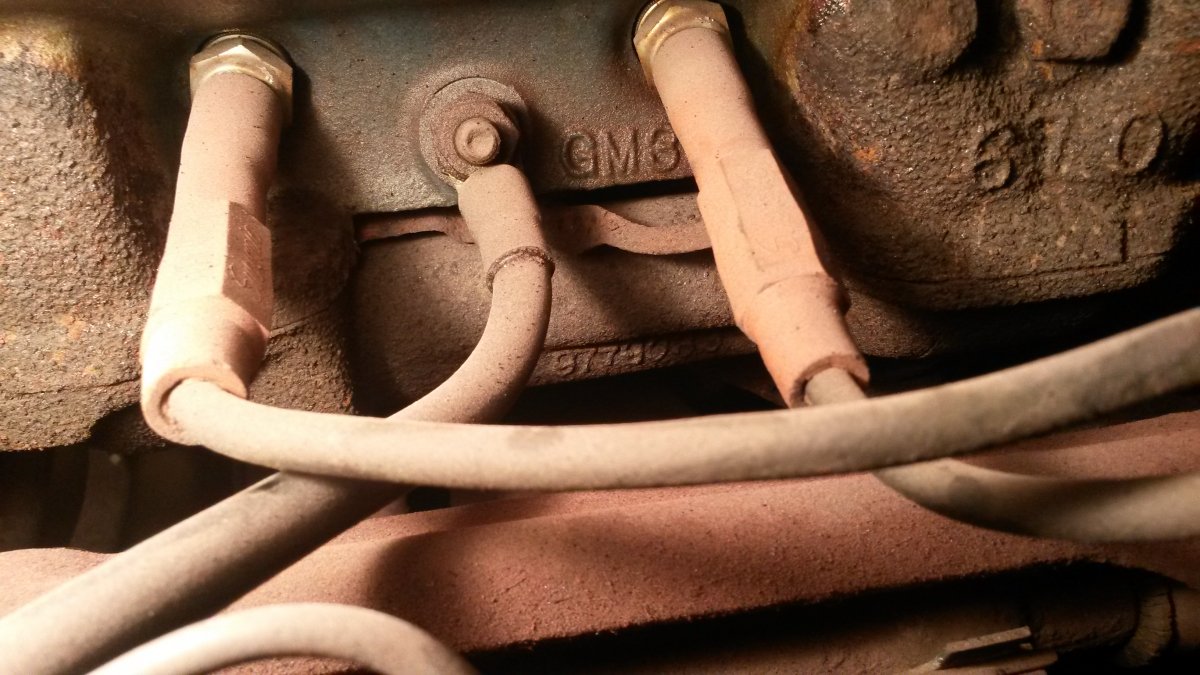

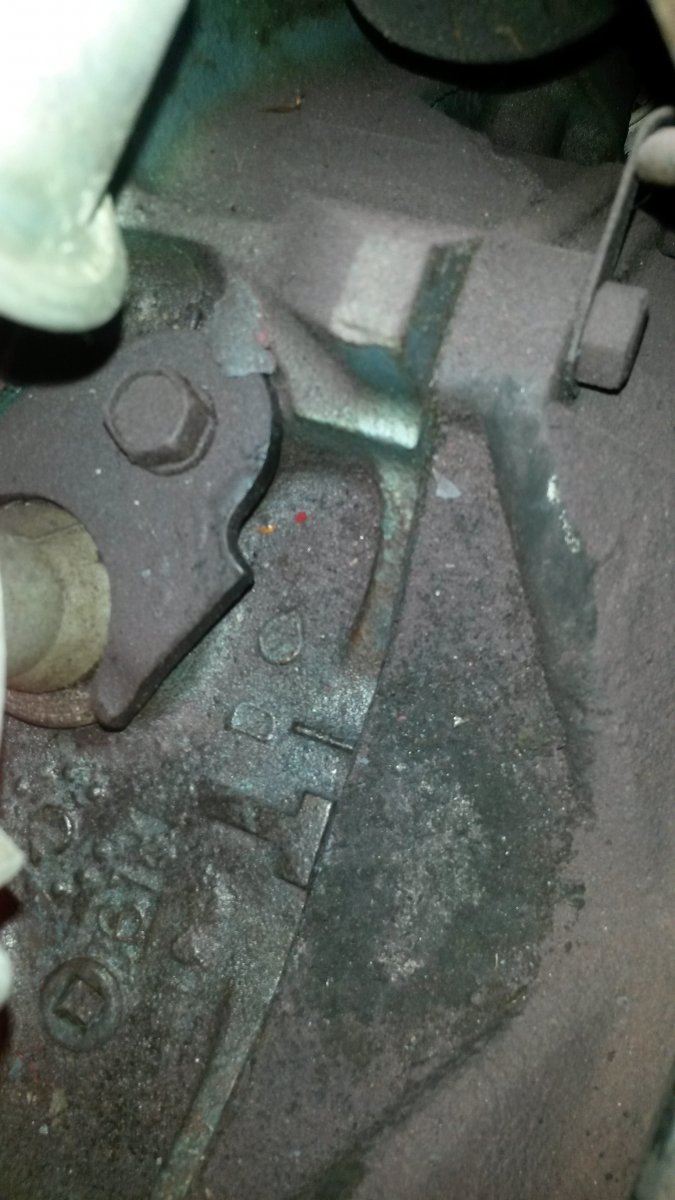

    I coudnt see anything under the car but I found this under the distributor.... see picture.

    I also found a 97790 on the driver side

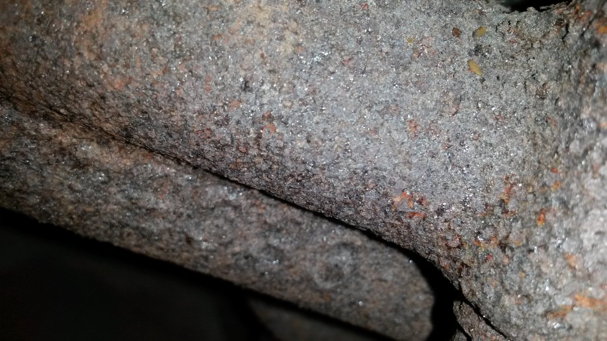

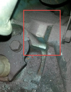

    I think I found a transfer lug too... see picture

    I removed a spark plug wire and found a 9336

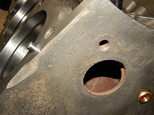

  17. Joe H
    Joined: Feb 10, 2008
    Posts: 1,553
    Joe H

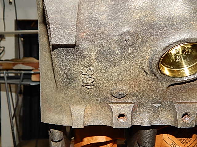

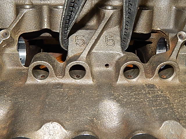

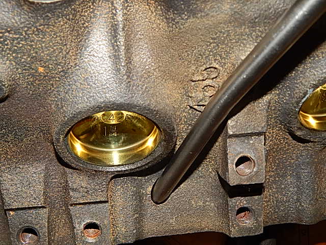

    Yours will be stamped just like this 455,
    First photo shows the transfer lug ( ONLY used on the big engines 421, 428, 455 ) and casting date ( 1971 for this block )
    Second photo shows the lifter galley, with " 55" cast into it, for 455
    Third photo, 455 cast in side of block behind dipstick
    Forth photo, 455 cast into side of block on drivers side front
    Fifth photo, shows engine code stamped into the passenger side front of block.
    Yours will have all the same markings. Pontiac did not install 428 pieces on a 400, someone else might have, but the factory never did. And again, 400s did not have the lug on the rear of the block, that was there to identify the bigger engines on the assembly line.
