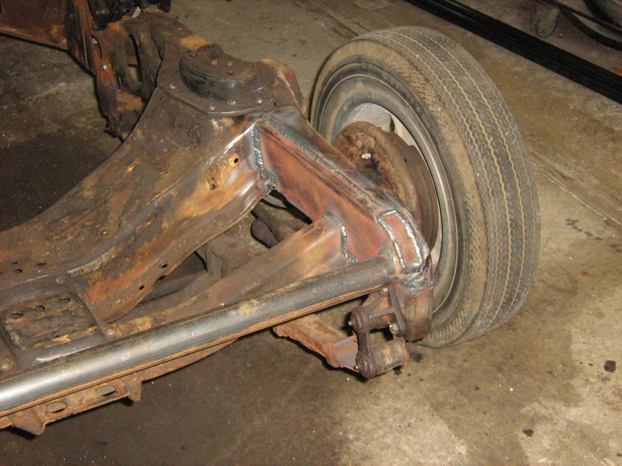

  5. Martys 55
    Joined: Mar 12, 2007
    Posts: 47
    Martys 55
    heres a pic of mine not the best pic it is front cross steer its on a 55 chevy

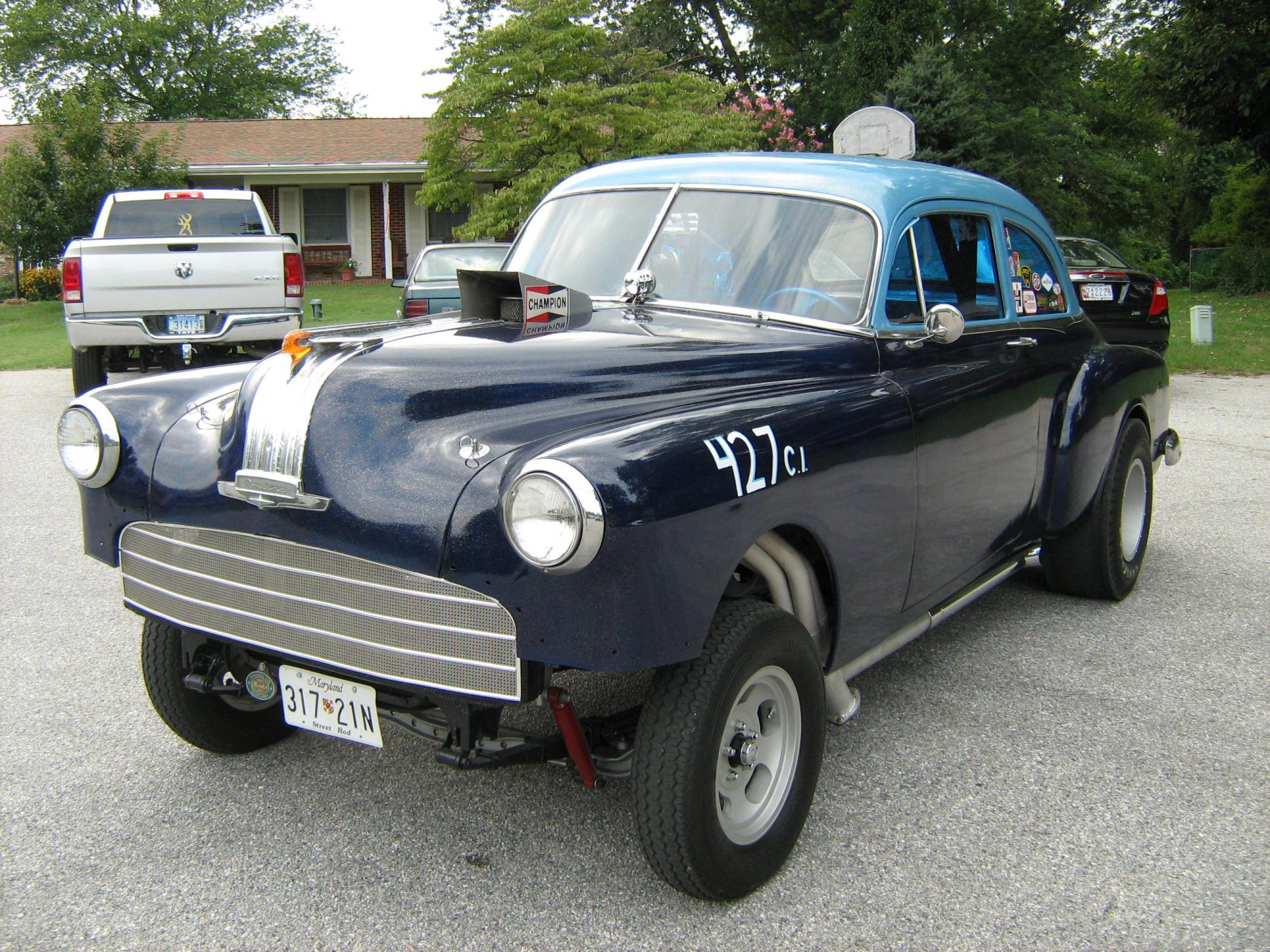

  13. gasserrod
    Joined: Feb 20, 2007
    Posts: 42
    gasserrod
    from maryland
    Here is my 50 pontiac with a complete 55 f 100 suspension and steering
