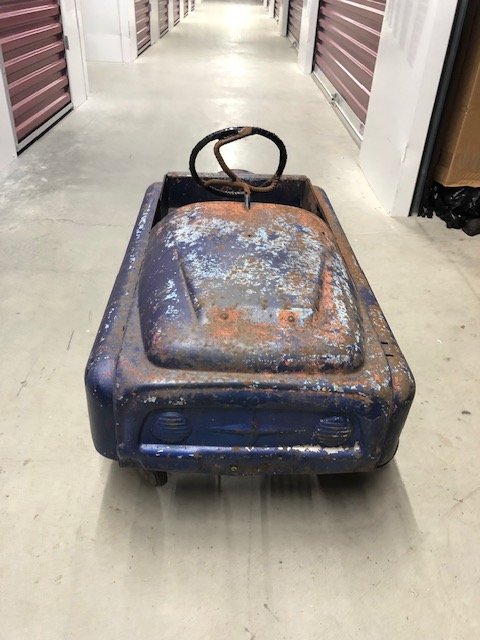

    D80FFF49-AA71-428B-AEC7-CB6700EC8277.jpeg I’m in the preliminary stages of converting an old pedal car into a stroller so my grandkids can enjoy car shows and cruise nights in style. I would like the front wheels to turn for the sake of maneuverability. Any ideas on how much caster is needed for the wheels to return to center? Planning to build a straight axle with no suspension...

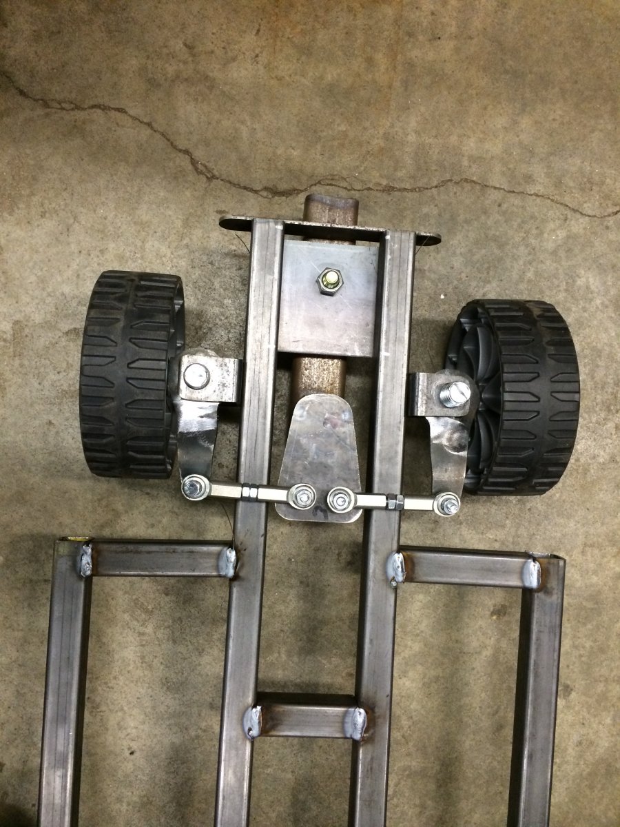

    8AE1F8DC-0F0C-4DBC-9852-2D5A0AF41693.png A6AE33BE-2C7F-4544-8F3E-6E963163D32F.jpeg Mark this is how I am doing mine, not a straight axle, but a idea . It will be pulled not pushed, so i don’t have to worry about self centering

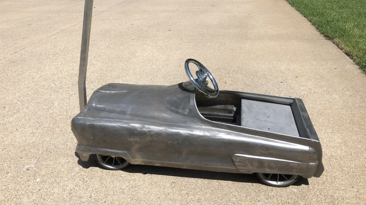

    My grandson is pretty young so I prefer this to be pushed so I can keep tabs on him while moving. Parts are being gathered up and I have a shopping list for Discount Steel so I can start building axles and a frame.
    Stainless shot glasses for injector stacks
    Steering wheel

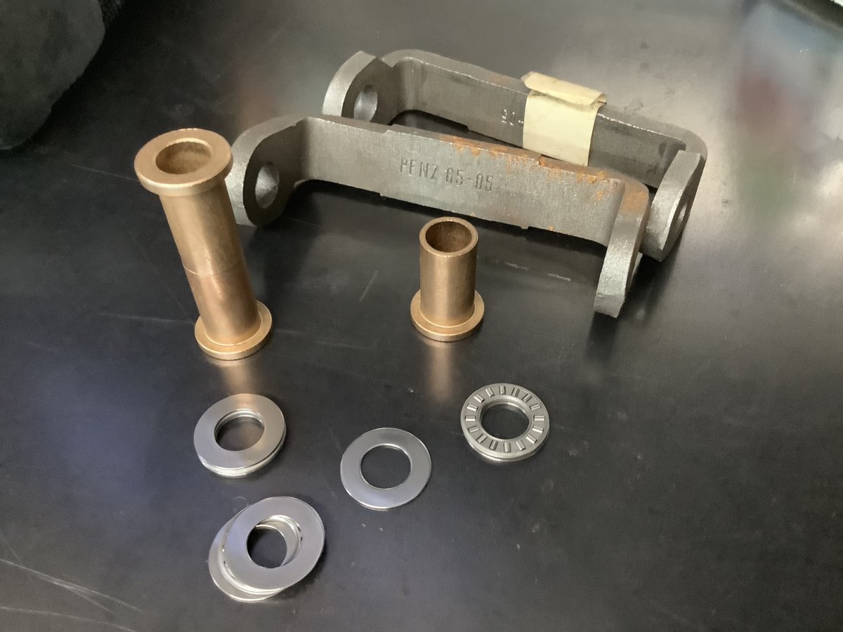

    0CDCE838-181B-4C8F-8358-80C41A94A640.jpeg The bushings and thrust bearings for the front spindles showed up today, one step closer. My buddy is machining some 5/8" ID DOM tubing, the bushings will go in each end and a thrust bearing and washers will go on top. Everything is 1/2" ID so I can use a steel pin as a "kingpin". The pieces in the background are hinge butts for a semi trailer that I dug out of my big bucket o' junk. They will be welded to a tube to make the axle. With the bushings and thrust bearings the wheels should turn pretty easy.
