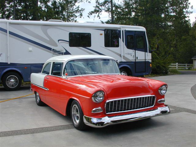

    from wash state
    Iam driving this 55 chevy to Good Guys in Scottsdale AZ 1500 miles in a few weeks would I do that with a Strait Axle under it
