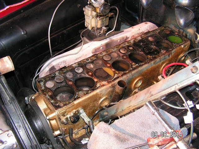

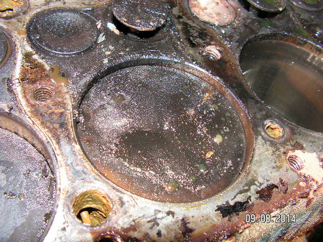

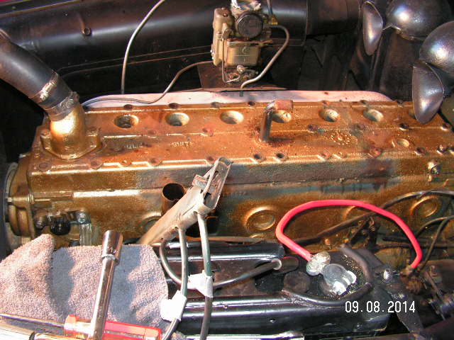

    I pulled the head off the engine today and turned it over a few times by hand with the fan and saw that only 7 of the pistons were going up and down. The third one from the back doesn't move so tomorrow I'm going to remove the oil pan and check it out from that angle. Any ideas on what I should expect to find? Will I need to replace the piston? Here's some pics....

  2. a busted rod and some rod bolts!

    A connecting rod that is no longer attached to the piston. I would guess it broke a rod.
  4. And probably chunks missing out of the cylinder wall. Sorry

    I hope you are lucky enough to find the piston separated between the wrist pin and the oil ring at the drain back groove. In which case, yes you need a new piston. Anything else and you need a lot more than a new piston. Up to and including a new block or at least a sleeve. The LS idea is sounding better and better.

    Lord only knows right now. If you are lucky, maybe the rod cap came off and maybe no real damage was done to the block.
    Piston may be OK but the rod is likely history.

    Bad news. It appears that the oil pan cannot be removed without pulling the engine first. There's only an inch or two of room between the front part of the pan and the frame (top part of photo). I stuck my hand in there as far as I could and still couldn't even touch the front of the pan. There's no way to get a wrench in there to remove the bolts....

    Is that an internal part lying across the drain plug hole

  21. Sure looks like it....if the pistons not moving I think it's safe to say the motor is coming out anyways.

    I looked in my 59 edition MOTORS MANUAL, and it says the pan CAN be removed with the engine in the car; steering linkage has to be dropped and the engine raised. Your local library may have MOTORS MANUALS if you can't locate one. Yes, you have dis-articulation of the piston-crankshaft connection. I am Butch/56sedandelivery.

    Dropping the pan in the car is another waste of extra effort. The engine will have to come out sooner or later........unless this a rare "virgin failure" (no other damage to crank or block)....

    Yes you are well past repairing your engine without removing it. If it can be repaired at all. If you want to get a better look at that cylinder, you could drill and tap through the loose piston. Screw in a bolt and maybe use a puller to remove what ever is there. Then you could look down through the hole and see the destruction. But the engine is going to have to come out sooner or later.
