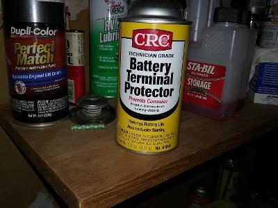

  22. ............It's a lot easier to just use this stuff.:D thumbnail (11) (1).jpg
    VANDENPLAS and Boneyard51 like this.
  23. In my younger days, I used Vaseline to prevent corrosion on the terminals. Same principle as the greasy cloth stuff.:D
    Boneyard51 and AGELE55 like this.
