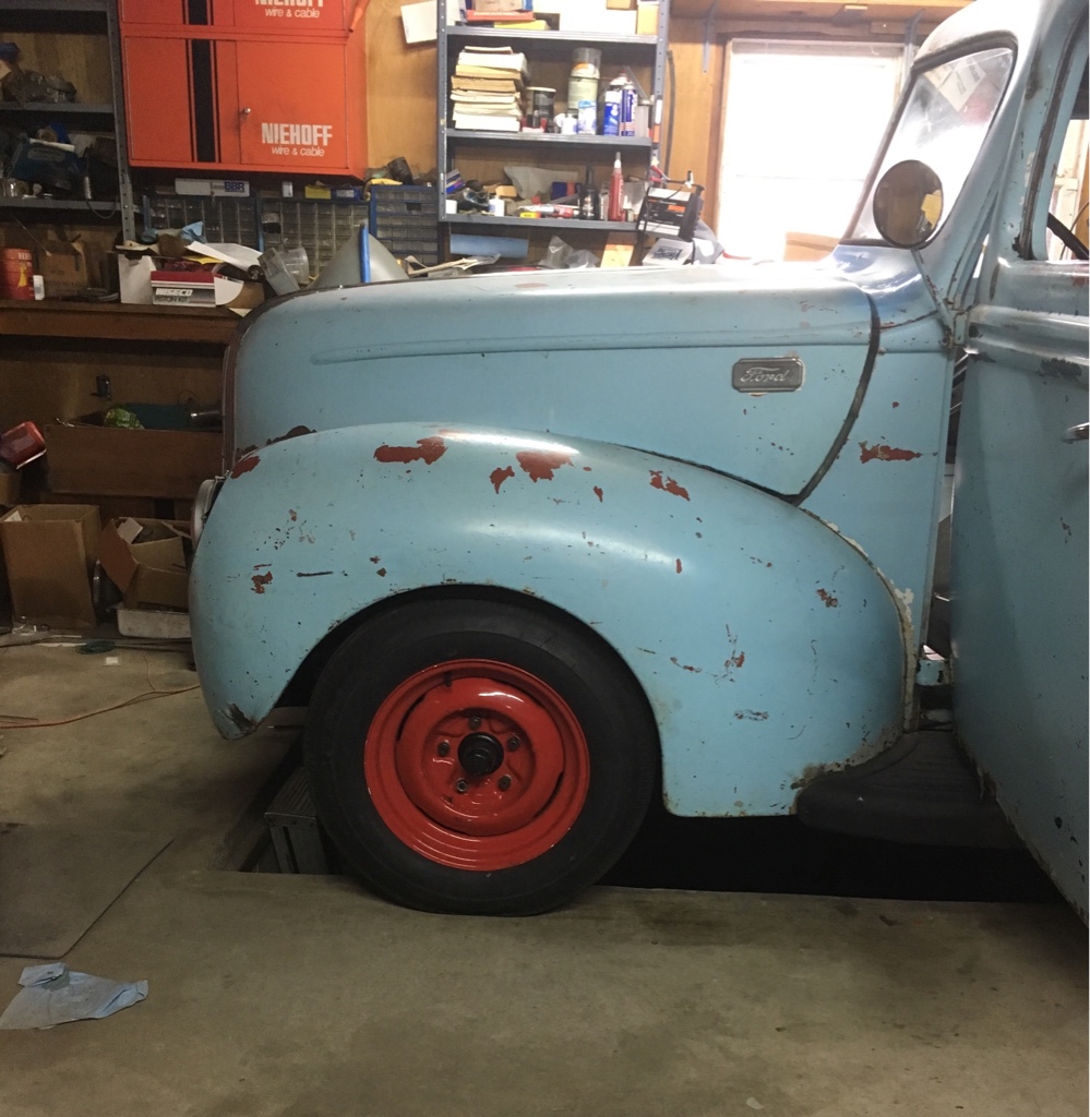

Looking at the picture above, I would move it forward 3/4 to 1" to center the tire better. I look at the center of the hub VS center of the wheelwell. Purely cosmetic but it can make a big change in looks. One of those things most people won't notice but it will look "right". I always move the front axle CL forward when lowering. I do it with mock-up. No set measurement to me. SPark

Thanks, alchemy, not looking for a slammed look, just nicely lowered. Plan at this time is running 16" steelies, so the look would be similar to the picture mrfliboy posted.
Like alchemy said, the lower you go, the more it needs. On the low front ends we do, it's usually 3/4" to one inch. Mocking it up is the best way though.

Thanks for the photos and front end info joel. mrfliboy, if you are still there, what was your suspension setup?
The pic w the www tire, to me makes it clear imho the tire should be forward. The cresent shape over the tire being tight at the rear, and open more at the front means the tire should be forward. Mock up to determine. Sent from my SM-G550T1 using The H.A.M.B. mobile app
