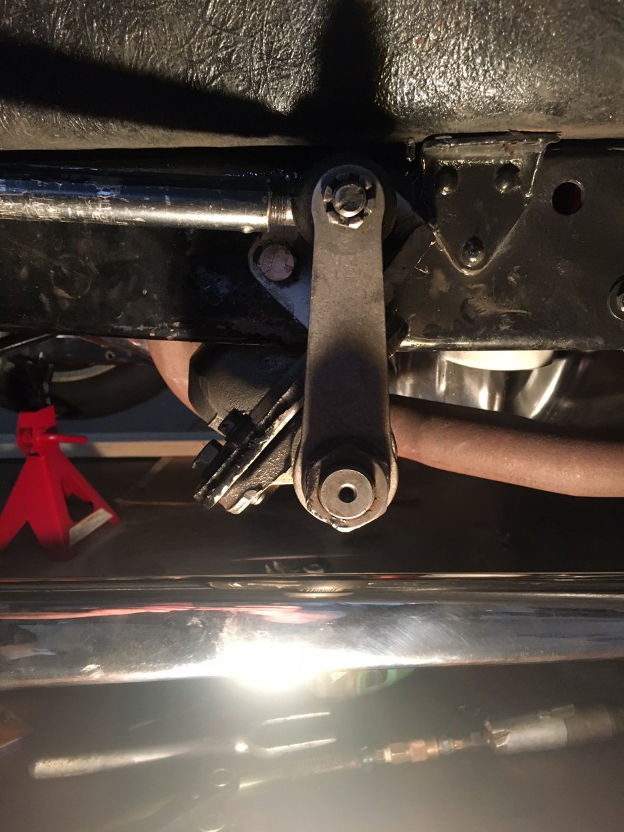

  5. Ben Chirco
    Joined: Oct 21, 2019
    Posts: 237
    Ben Chirco
    Update on the steering. I still need some help here.
    I ordered the short pitman arm from Pete and Jakes.
    I ordered a new 1968 mustang steering box with a 1 1/8" shaft, 5 turns lock to lock.
    I was sent a 4 turn lock to lock. I did not test this prior to install.
    I installed this all. Pitman arm is facing straight up and lined up with the factory center line mark.
    When I turn right, it takes 1 3/4 turns of the wheel to stop. I installed a stop on the king pin lock to stop from hitting the bone.
    When I turn left, it takes 2 1/8 turns to stop. No need for a stop here as the wheel just stops. This is when I disconnected the drag link to test and found it was a 4 turn lock and not a five turn lock. I dont think this is my problem.
    Any ideas on why it is not the same?

    Way back in post 36 @anothercarguy illustrated proper geometry for the pitman arm to have the same travel when the steering wheel was turned right and left. What I’m wondering is if that has to be taken a step further. Look at the ‘32-‘34 spindle, the steering arm is not perpendicular to the backing plate flange, it leads the centerline of the axle by an inch or so, putting the arm 90* to the drag link. Aftermarket steering arms have their c/l on the axle c/l, does that cause the right turn to be effected “quicker”, or to put it another way will it require less input at the steering wheel?

    Here are some pictures of furthest left, furthest right and center of the steering box (confirmed by rotating the wheel-factory mark was correct). I added a washer as a shim at the top bolt which is the one that holds the steering box to the bracket. It helped to bring the pitman arm to exactly 12:00.
    Now by turning the wheel I have:
    1 3/4 turns to the right stop.
    2 1/4 turns to the left. this is where the steering wheel stops turning. I have about 1" to the bone and i am not hitting the stop. So I am not getting full radius to the left.
    Would the 5 turn box help here?

  19. @Fordors you have a point, but based on Ben's photos of his front steering arm, it is already the "dogleg" version which I believe takes this into account (by moving the draglink hole slightly forward of the axle/kingpin centreline).
    @Ben Chirco , you need to:
    1. With only the steering wheel/column connected to the steering box (no pitman arm, no drag link)...turn the box all the way one way, and then all the way the other, counting turns and making a point of noting where exactly the center point of the steering box is (presumably 2 full turns in from each extreme). Leave the steering box at the exact center point.
    2. With the steering box exactly centered, measure and make sure your tires are pointing straight ahead (they are not yet connected to the steering box).
    3. Without moving the steering box/steering wheel, install the pitman arm on the steering box at the 12 o'clock position. If you need to file the master splines of the pitman arm to align with the master splines on the steering box in order to achieve 12:00, do so (as previously described in this thread).
    4. With the steering box centered, the pitman arm at 12:00 and the wheels pointing straight ahead, adjust the length of your drag link so it drops into place on the steering arm and pitman arm.
    5. Lastly, adjust your spindle stops (they can be shortened if necessary or a washer can be added if they need to be lengthened) so that the tires stop turning just before the steering box reaches max turn on each end, and/or before your tires contact the drag link, wishbones, fender braces or anything else they may come into contact with.
    6. Enjoy the ride...

    I missed it before but I just read that you aren't hitting the stops at full lock . If that's the case , your pitman arm is too short or your steering arm is too long ...
