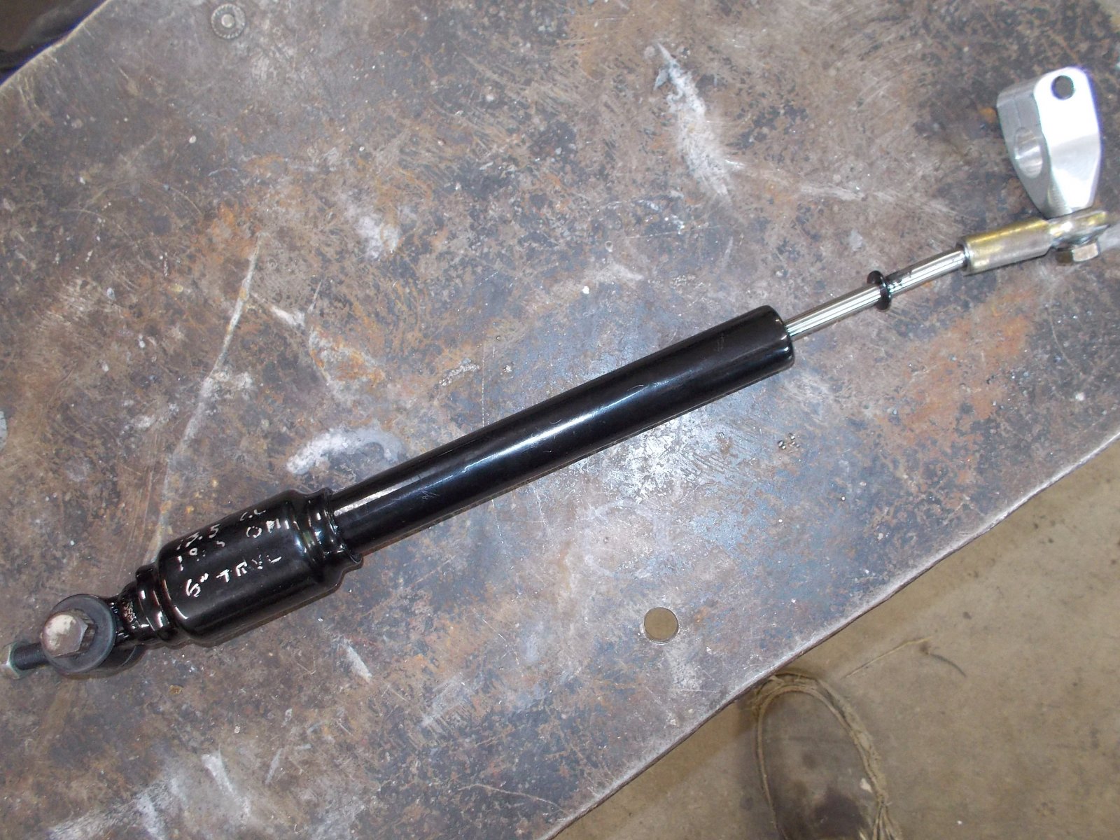

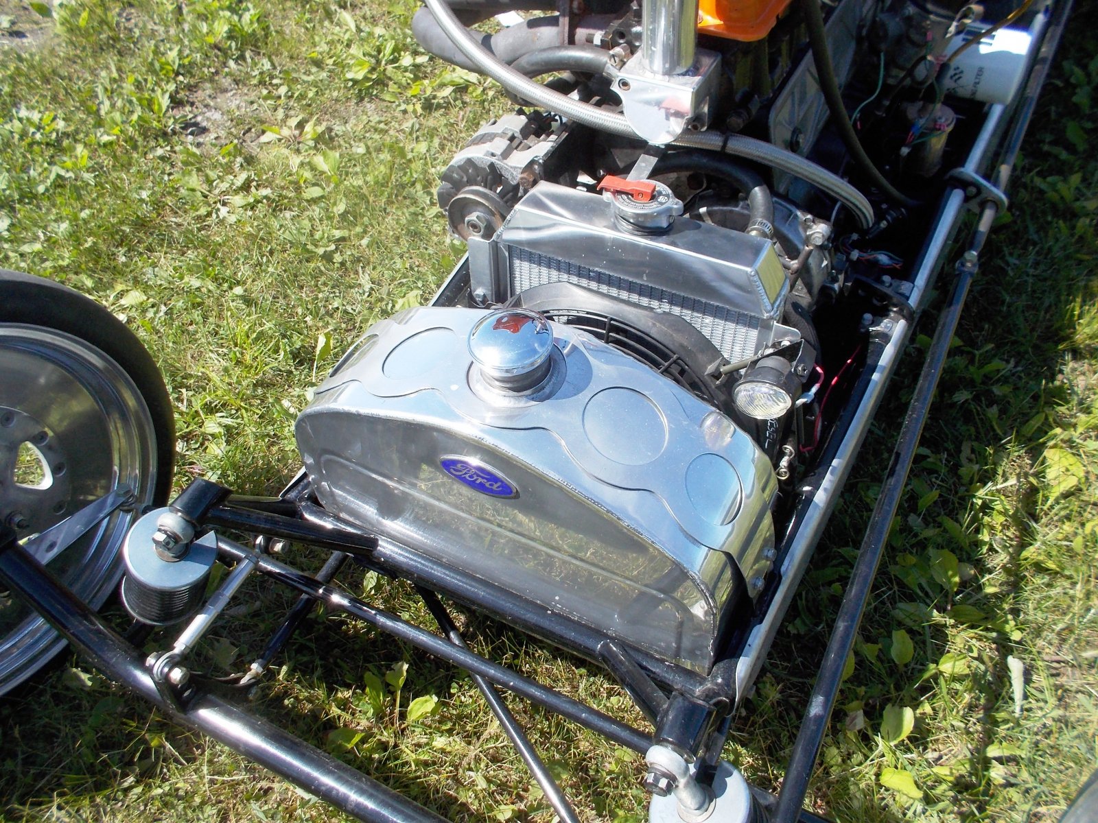

    Here is the VW damper installed on my Logghe car. I'm done racing for this year so I will try it out next outing in the Spring. It has a 6" range of motion.
    theHIGHLANDER and Ned Ludd like this.
  16. sdluck
    Joined: Sep 19, 2006
    Posts: 3,332
    sdluck
    Rock auto Sach vw bus steering damper 313714 $20.79 is what is on my model A with vega cross steer.

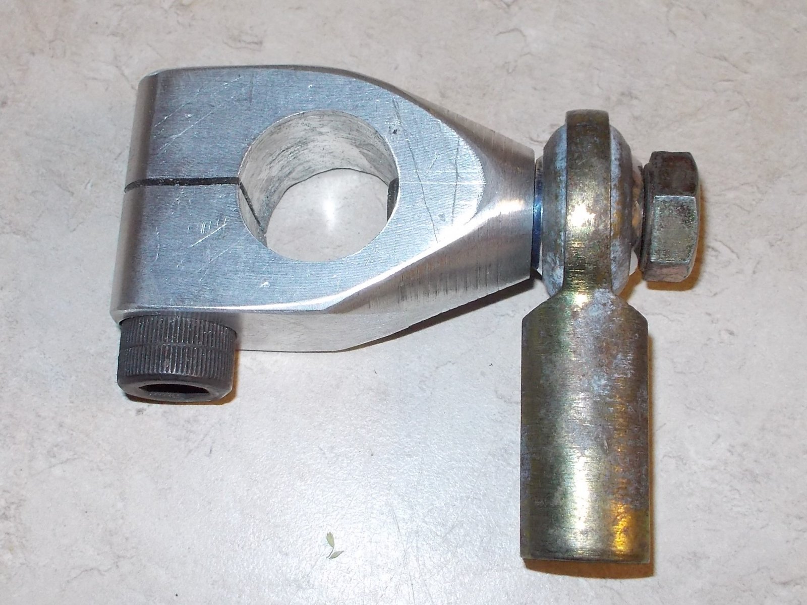

    Any pictures of how you mounted it?

    I used a clamp around the axle and another one the tie rod. I will try and take pictures later.
