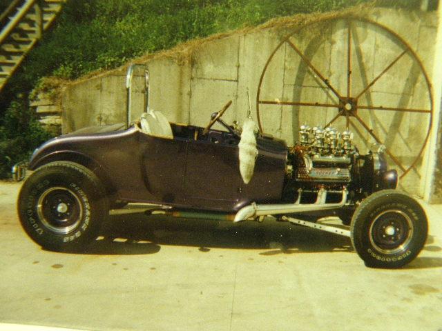

  12. ROADSTER1927
    Joined: Feb 14, 2009
    Posts: 3,283
    ROADSTER1927
    I put a dead perch on on side and it does drive with out any nasty things! In other words Perfectly! original do.jpg
    ALLDONE, hotrodjack33 and bschwoeble like this.

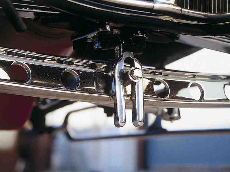

  13. DDDenny
    Posts: 21,671
  14. Here you go Rick, this is the frame under my '32 pickup, notice I used a panhard bar, this truck drove like a dream.
    And I agree with the fellow member that said a steering stabilizer is a band aid for improper setup. HRP
