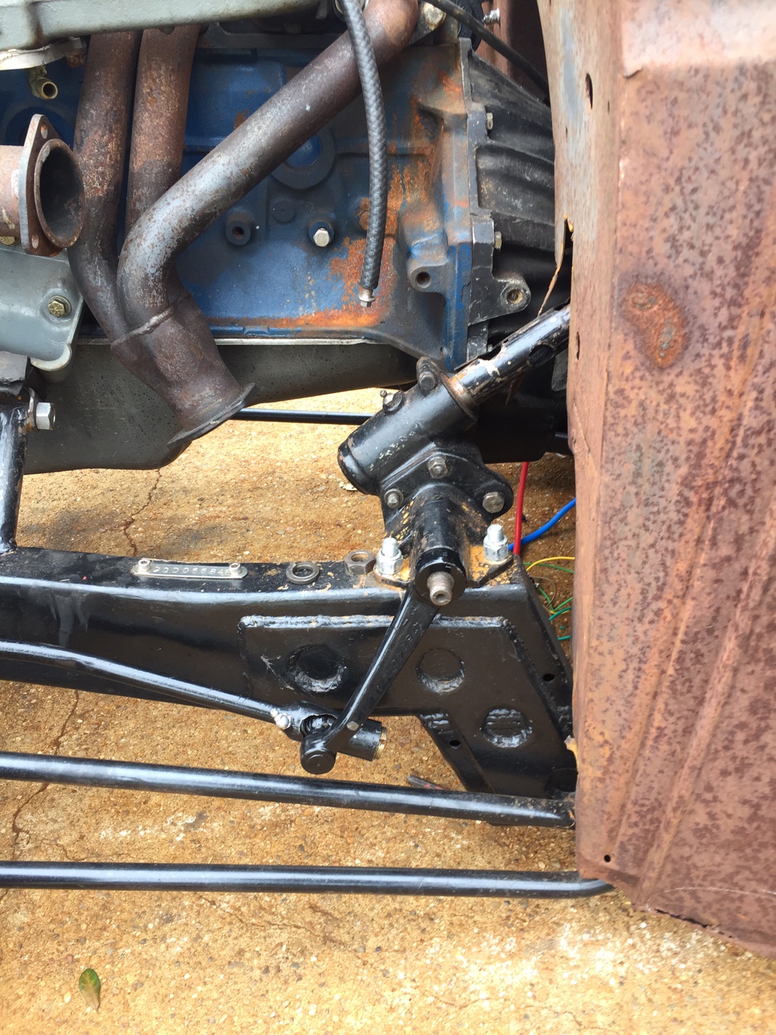

    What’s wrong with my steering setup?
    It binds up when u try to turn.
    It’s a gear box from a 1936 Chevy car
    [​IMG][​IMG][​IMG]
    Sent from my iPhone using The H.A.M.B. mobile app[​IMG]

    Looks like the rod end attached to the pitman is not aligned with the stud. Did you build this?

    No it’s not hitting the radius rod It feels like it’s binding up in the gear box but just wanted to make sure the angle looked right or even the set up

    Yes I did. First one so trying to get some help.

    Disconnect the drag link, then turn the steering wheel lock to lock and center it. Make sure your pitman arm is pointing straight down. If not fix it. Point your wheels straight ahead and see if the drag link will fit. I'm guessing it's too short to run with the steering gear centered.

    Your steering arms that are connected to the tie rod are not angled correctly to have correct ackerman. It will scrub tires on turns.

    I take it it turns nicely to the right but not the left? It sure looks like you didn't center the box before before installing the pitman arm and the drag link?

    Since your pitman arm is pointed forward with the front wheels pointed straight ahead, I would think that your drag link needs to be longer.

    Is the drag link hitting the frame and why does it have the bend in it? Looks like it would move all over the place when steering.

    drag link too short,with the wheels straight, the pitman arm needs to be pointed straight down.ackerman is off a little,but not as bad some cars with lots of miles

    also looks like NO caster in the front

    start at the box with the pit man arm disconnected from the drag link, and adjust by the book. center it take the play out. then center the wheels and as said already see if the drag link reaches, from the photos I guess it won't.

    Can you straighten out the bend in the drag link? It would actually make it a little longer which would coincide with the pitman being off center.
    I was asking about the stud in the drag link fitting into the hole correctly because in the pic it looks like the tie rod is twisted upward so the stud would rub on the bottom edge of the hole (causing bind).

    Ya the drag link is to short. So I’ll start with that. Thanks guyd

    Also, o\it appears to me the paint on the frame is broken where the pitman arm/ drag link has been rubbing on the frame rail reinforcing plate in photo 3. Has it been touching on a hard left turn?
