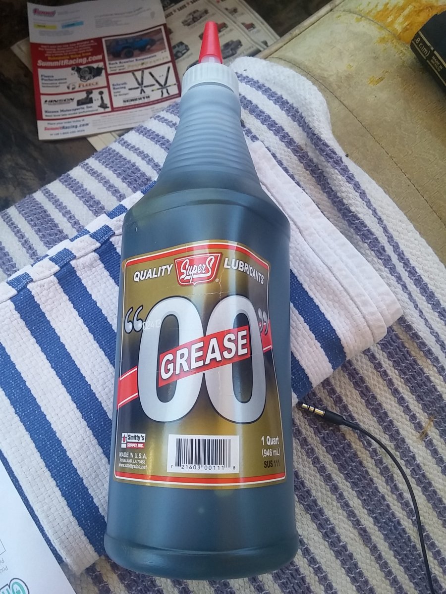

    I've been searching for years for a pourable grease to fill manual steering gears, since the Chevy grease was discontinued years ago. Since I got a 1928 chevy, I also need it for the transmission and rear axle. Can't find Corn Head grease around here, since there are no corn fields. I even asked for it when Tractor Supply opened a store in town a couple years ago.
    Anyways, spending more time googling I found a thing called EP00 grease, which NAPA can order for me, for twelve bucks a quart. More googling found some at Tractor Supply, five bucks a quart. I bought the one quart they stock, and the guy said he'd order me a couple more quarts. It seems to be what I needed, although I don't know how the specs compare to "real" steering gear lube, or the old 600W oil that the old car manuals specified for the gearboxes and suspension fittings.
    https://www.smittysinc.net/images/products/files/2_Super_S_00_Grease.pdf
    I don't know if this will help anyone, but it would have helped me to know this a while ago :)
