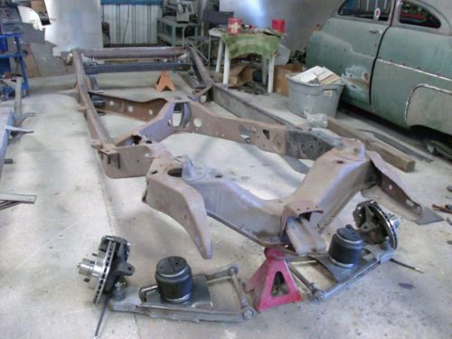

  14. the frame dimensions are similar
    may look into using this clip, it has some huge disc brakes
    this clip I have has a power assist that bolts to the center link
    it is rear steer with very little frame past the front xmember like the stock merc

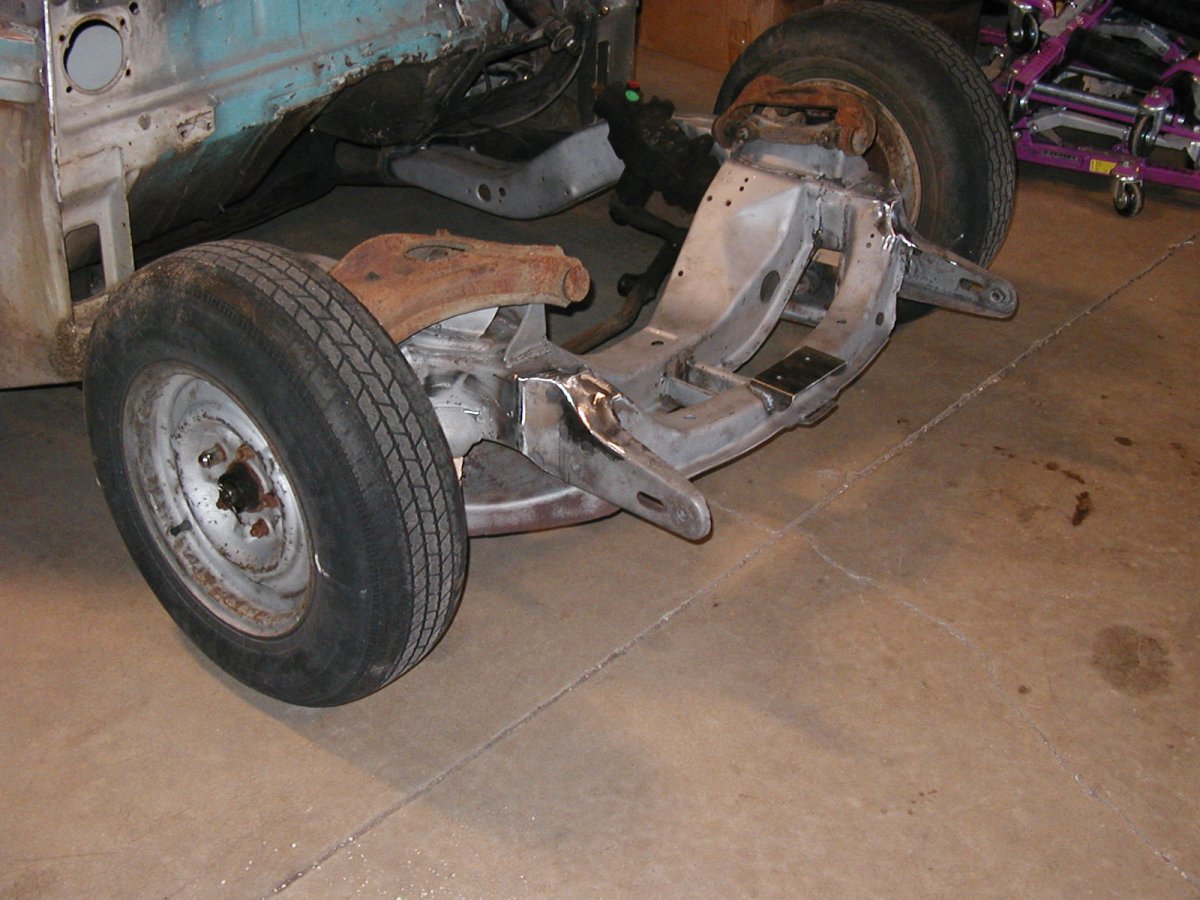

    vette frame
  16. Wow, amazing similarities. I guess it goes to show there are only so many ways to to do a job before your right back where you started. Or 50 Merc's were way ahead of there time. That right there is a Kool discovery. Kind of let's me know I wasn't to far off the mark with this little project I did not to long ago.
    The Wizzard

    any more pictures?
