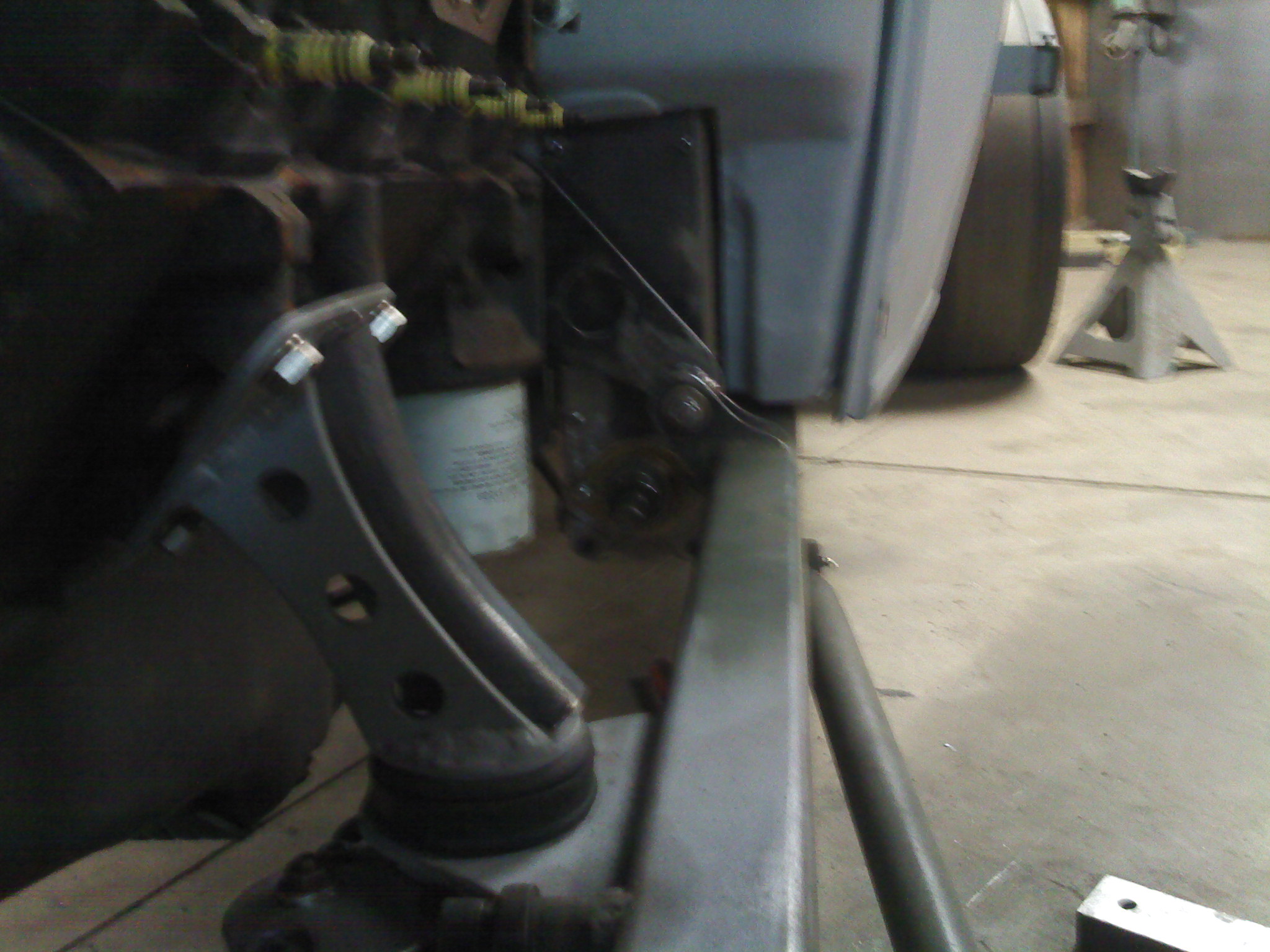

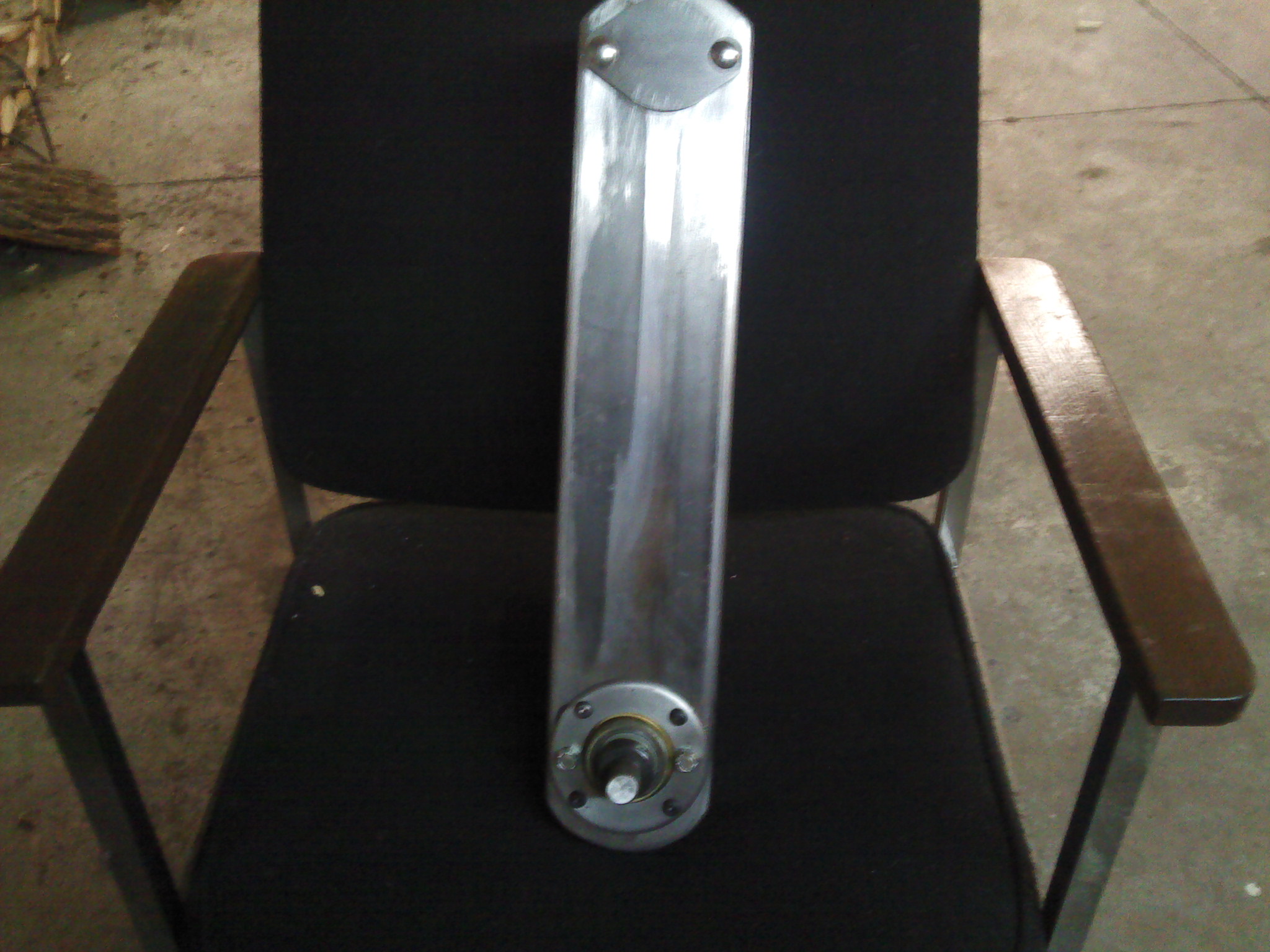

    Couldn't stomach the price so I built my own. I had thought about doing a tech thread but until i test and have used it probably not a good idea. I have under $100 bucks in it with bearings, gears, chain,splined shaft, and steel. I'm going to run it back and forth on a lathe a couple hrs each way and take it apart to inspect it. If it looks good I'll try it out.

    Pics didn't work lets try again.

  20. CutawayAl
    Joined: Aug 3, 2009
    Posts: 2,144
    CutawayAl
    from MI
    Whether justified or not, if something bad happens lawyers tend to sue everyone possible. That being the case, I suspect some potential legal expense is factored into the cost for these units.
    I like splines too, but they can be a problem. Machining specs can vary from one manufacturer to another, and OEM stuff typically has rolled splines. Rolled OEM splines are notorious for variation. OEMs use a pinchbolt to clamp the splines, so if things are in the ballpark you end up with a tight joint. Aftermarket splines are usually solid. Fit is more critical with no pinch bolt. Combining aftermarket splines from different manufacturers, or aftermarket and OEM splines, can sometimes result in a poor fit.

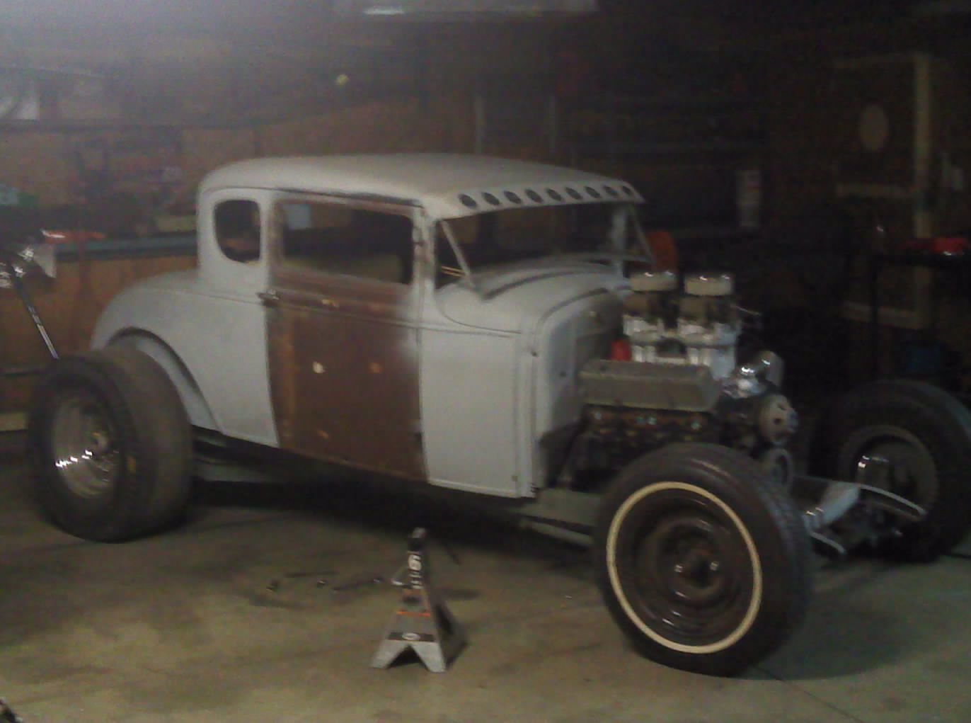

    NOCERO I like how you hid yours, looks good:) I have seen some really clever chain drive setups that seem to work great. Pics:
