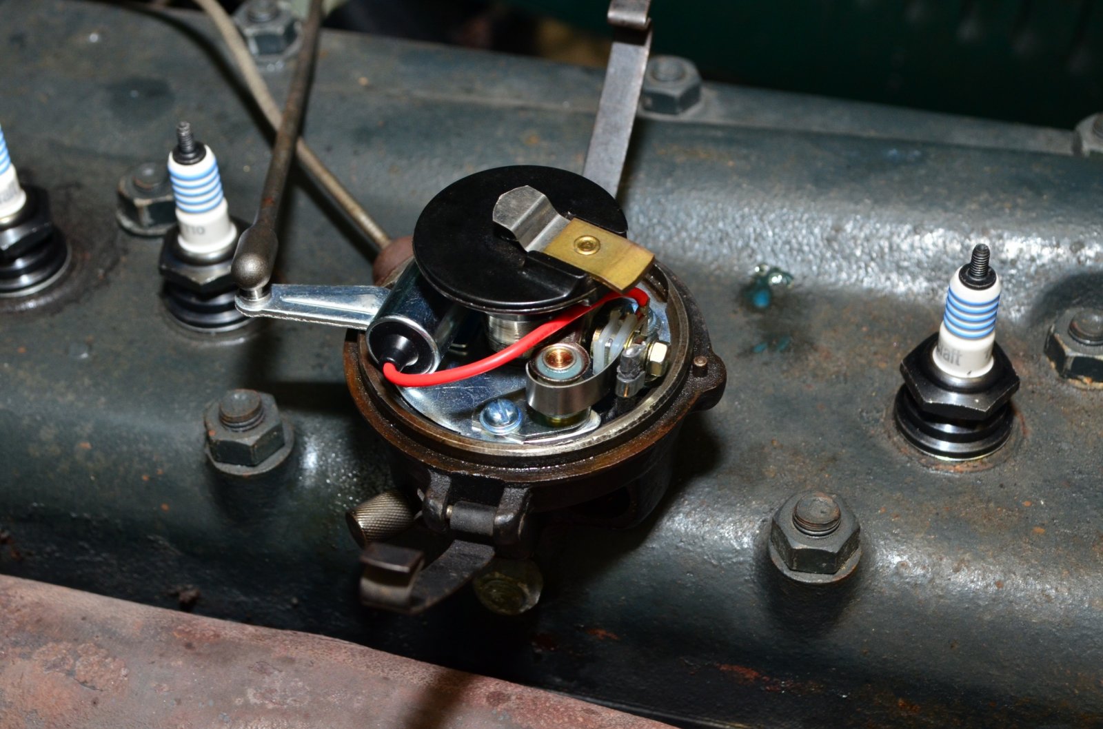

    Thanks all that have helped so far. Was able to get my wife to come over and help this afternoon and its spark issue.
    Earthed out the coil wire (held it near a head bolt) and the spark was really weak and was rarely there.
    Same result with the points and no spark at a spark plug.
    Have 12v at the coil and the top of the distributor (Its been converted to 12V)
    Have sanded the points and they look clean.
    All electrical connections are tight.
    Pics below are what I am working with.
    You'll see in the 1st pic there is an electrical connector but no wire to it but it doesnt look like there has been one for a LONG time and I know 6 months ago this was running like a champ. It actually appears to be holding something in place?
    For the no spark issue could it be the condensor as suggested? If so I sure hope I ordered one but cant recall and wont know until Wednesady when the rest of my stuff arrives.
    VANDENPLAS and Stogy like this.

  13. The37Kid
    Joined: Apr 30, 2004
    Posts: 30,793
    The37Kid
    The tab on the condenser is broken off, they used that ring terminal to hold it in place.
    Bob
  14. The37Kid
    Posts: 30,793
    The37Kid
    I think your spark advance is disconnected, an electrical guy will explain things. This is how a stock one looks, but the condenser, is relocated. image_14.jpg
    continentaljohn and panhead_pete like this.
  15. panhead_pete
    Joined: Feb 22, 2006
    Posts: 3,487
    panhead_pete
    You are right re the advance/retard linkage The37kid ! Its not connected.
    Just gone back through my emails with the seller and its apparently a Model B dizzy. Did a bit of reading they are apparently auto advance?
    trikejunkie likes this.

  20. CycleTech
    Joined: Oct 24, 2020
    Posts: 160
    CycleTech
    That is a so called "modern" points set up for the A.
    They went through the job of converting Petes car to 12volt but not updating the ignition.
    Come spring mine is getting a complete tune-up. with regular spark plug wires instead of the original blade type. It already had the "modern" points and condenser. Replacements are in order for them too.
    panhead_pete likes this.
  21. winduptoy
    Joined: Feb 19, 2013
    Posts: 3,397
    winduptoy
    Pete,
    It does look like a B dizzy but there are a few things that might give you a weak spark.
    First keep in mind that Henry stock wiring had the + terminal on the coil 'hot' all the time. The 'ignition switch' provided a ground path. I have no idea how the PO wired the conversion, it kind of looks like the way the ignition is wired, but i can't be sure. That is something to check along with coil polarity.
    Ballast resistor; if the coil has (nominal) 3 or more ohm resistance on the primary side of the coil, it doesn't need an external ballast resistor. If it has 1.5 ohms or less, it does. A ballast resistor on a 3 ohm coil will cause a weak spark.
    Bypassing it will allow you to troubleshoot and see if you have a stronger spark.
    The correct condenser has a wire lead that in part of the condenser and goes to the terminal on the dizzy. The condenser is suspect on your set up. Disconnecting temporarily will allow you to troubleshoot.
    I'd start there.
    I know you were on the hunt for a B condenser. I have a complete, rebuilt B dizzy, with a good condenser and we can talk if you are interested PM me.
    Good luck
    trevorsworth and panhead_pete like this.
