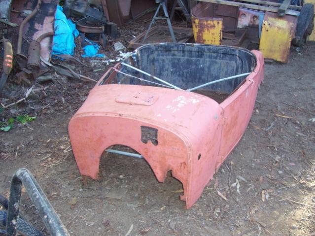

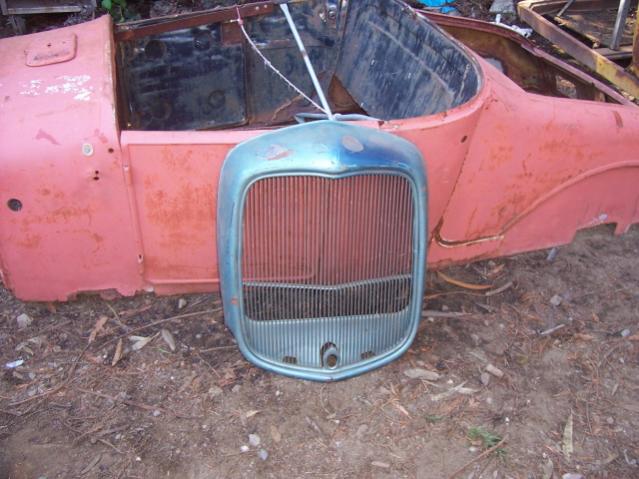

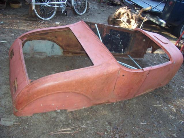

    Well, I'm just in the part collecting phase and this is my first shot at building a hot rod. Its a 27 T roadster body with good doors and a decent shell. The car was channeled at some point in its life so the subrails are pretty much toast. They also cut out the original firewall and welded in a 1/4" piece of sculpted plate to look like a firewall. Overall the body is kind of rough. But, considering its birthdate it could be alot worse. These are the parts I own. A 37-41 front end minus the drums and a 32-36 axle with another set of split bones, 5-35 ford wire wheels and 2-40 ford steelies, I found a 41-48 ford banjo with 3:54 gears, its missing the bones, purchased a deuce chassis that was already pinched for a 27'(hope all is well Ron), the motor is a 270 plymouth poly block with 1955 dodge red ram hemi heads, and a 1932 grille shell thats been sectioned 3-1/2".
    I like lists, and I'm trying to get a feel for what else I'll need.
    The look of the car is going to be mid 40's that someone threw a polyhemi in the 50's. Motor is a runner that belonged to my uncle whos passed on. The Tardel/Walling roadster is a rough idea of what I'm going for. I'm researching and digging for info on setting up the frame. Keith used a T crossmember, Z'd the frame 6 inches, used a 46' rearend, and I think a 36 axle. That info came from the Ol' skool rods issue.
    Anyone have any pointers? Just trying to get some more info from you guys out there.

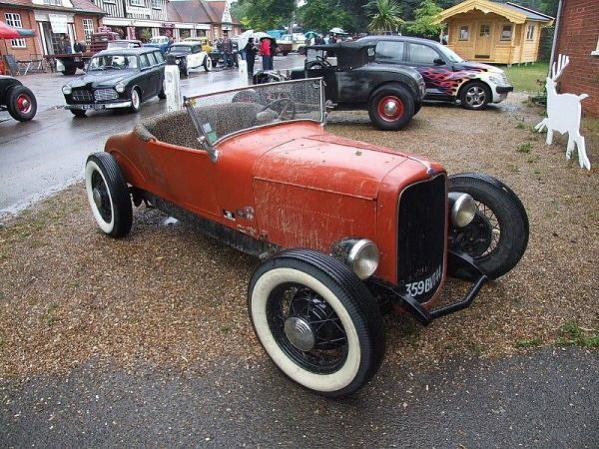

    The pics are what I have now and the orange t and the black and white Winfield t are more ideas.

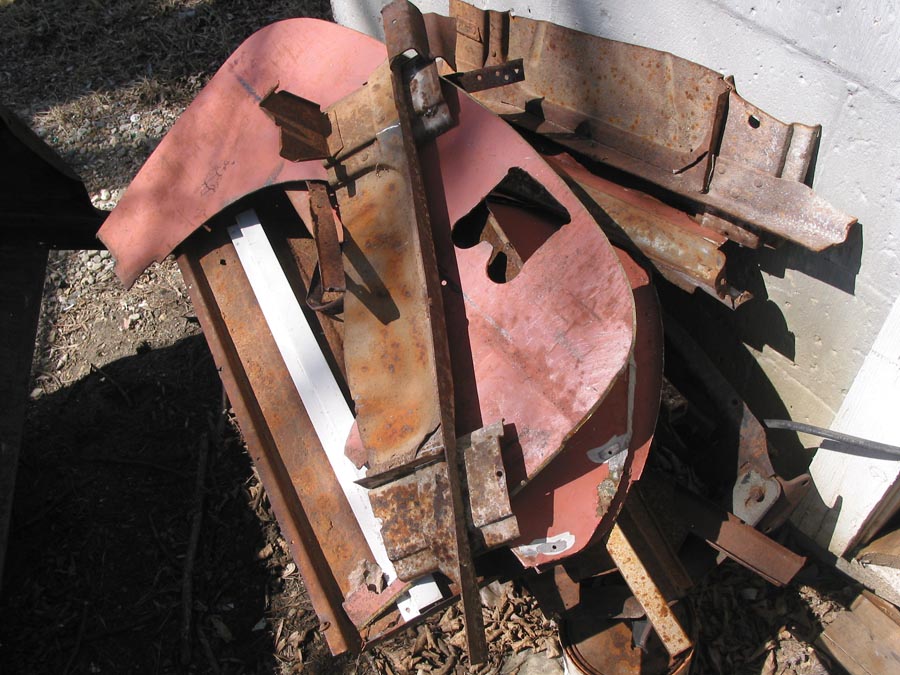

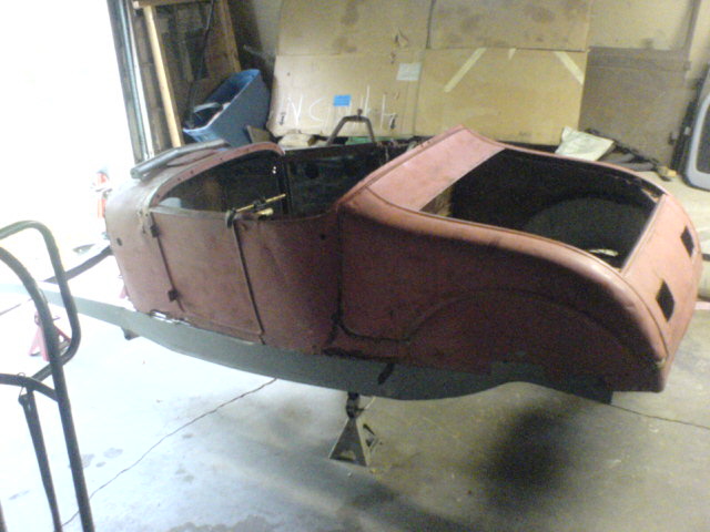

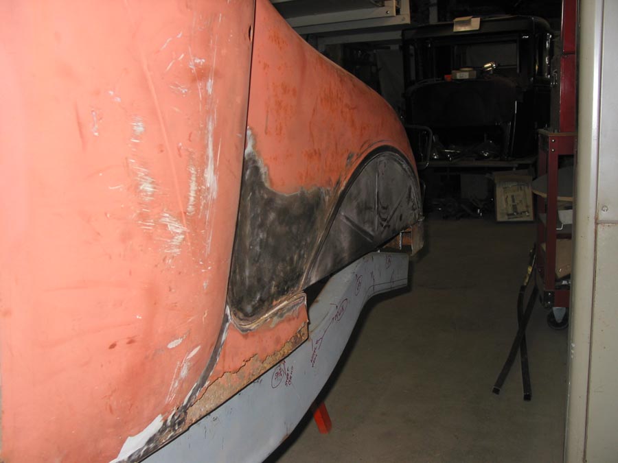

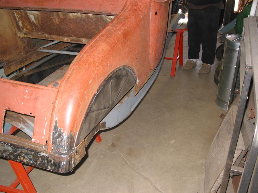

    Its been along time since I've posted anything on the roadster project. I purchased a deuce frame from HAMB member Youngster. He had already pinched the frame to fit a fiberglass 27' roadster. A club member and I brought the body down to check the fit of the frame and it had been pinched a tad bit much in the rear. So, Youngster says leave it here and I'll make it fit. Youngster is a hot rodder through and through. He works out of his long, narrow garage filled with all kinds of cool projects. Cooler yet, he makes most of his tooling(breaks, rollers, etc.). The body I purchased was pretty rough. 1/4" plate firewall that someone welded in, galvanized rear wheel openings that were screwed in and sculpted over with filler, no subrails, no toeboards, quite a bit of rust, etc. Youngster took it upon himself to square up the body by installing hand fabricated subrails, put in a stock firewall, installed new rolled wheel openings, cleaned up a bunch of rust and dents, and all this just to fit the body to the frame. He also found out that the body I purchased was pieces and parts of 3 different cars. Did I mentioned that in the middle of all this he had bypass surgery? I've added some photos of the work thats been done and just want to say thanks to Youngster. I only hope that I can be as much of a hot rodder someday.

    Cactus1 - Youngster bent up, rolled the beads, and installed those rear wheel openings.

    hi all ... talked to jake last night. he told my about the thread here so i thought i'd check it out. first off, i ain't no one special, just love Henry's '26-7 T's. i'm not doin anything any one of you couldn't do.
    whan i first saw jake's body, i thought "boy, now here's a challenge!" then after looking and assessing it, it's not as bad as it looks. just about any '27 body you find you can plan on replacing the bottom 4" all the way around anyway. the cowl is real nice, the doors are excellent, rear quarters are workable as are the turtle deck pieces. it's certainly a keeper. i'll be adding pic here to show the progress also.
