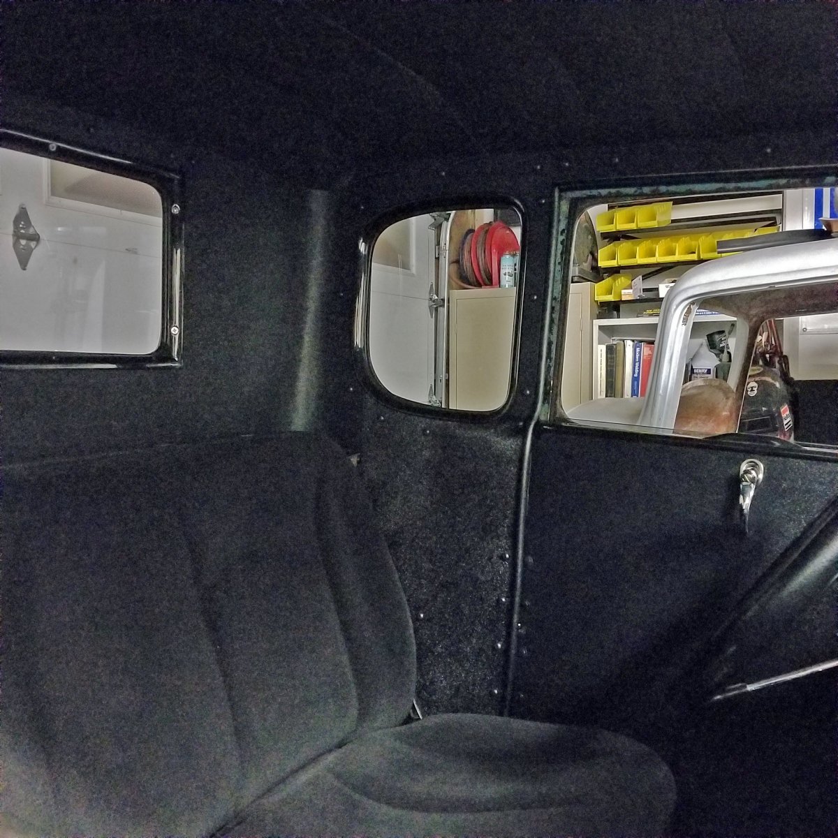

    The clips came today and the door and kick panels are done and look good. The upper corner panels need to be formed to a 4" radius and rather than try to wing it, I started looking for something to use as a form. Found just the right thing and it was pretty cheap too. I'll get around to those in the next few days while I'm waiting on more windlace so I can finish the doors.

    Here's the door panel showing the clips. A little more obvious than I thought it would be, but kinda follows the whole utilitarian theme. I'm holding off on the corner panels until this weekend as the way I want to do it isn't the easy way (shocker). The windlace is going in with more coming in a couple days. It really REALLY quiet and solid now. You close the door and it closes with authority. door1.jpg

    I have to get the new diff installed as well as finishing the interior. I've been creeping up on how to bend ABS but will be getting those panels done this weekend. I need to blast, weld and paint the package tray, too. Last, I'll be dying the seat black to match the rest of the interior since the gray doesn't really hack it.

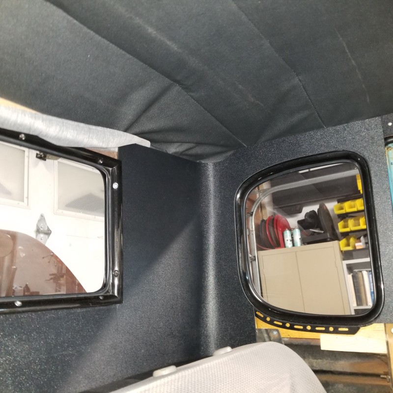

    Something always has to come before something else and that's what this (and this weekend) is all about. Put the headliner in but can't final tack it in until I have the panels done (to determine how much tension to put on the edges). I had to get more windlace 'cuz the vertical sections on the B pillar have to go down before the panels. I have to remove the seat (again) to put down the windlace and make the lower panels. As long as the seat is out I'm going to dye it black to get by until it's upholstered. Got the driver's side around the 1/4 window done and only took 2-1/2 days. The passenger side should be alot easier. My little Chinese screw caps should be here Saturday too. :)

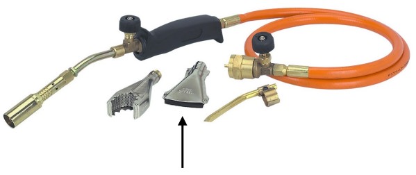

    Got it at a local plastics supply house... Orange County Plastics 4'x8' sheet for $45 each and using 2 sheets for everything.
    I found by doing some test panels that a heat gun is fine for small localized bends (and I'm using it in a couple spots), but the side panels are 20" high and by the time I got to the other end with a gun the beginning is cold. That means an inconsistent crappy looking radius (ask me how I know).
    That meant I needed more heat that I could control, so....... off to Harbor Freight. Uses the small propane bottles and the wide tip is perfect. Takes some experimenting, but starting getting a handle on it. Cutting ABS is a learned skill too. Found a die grinder with a cutoff wheel works pretty well for rough cuts, but the die grinder with rotary bits is what you need for finish trimming. A 6" belt sander helps give you straight edges as well. I'll see if I can take a few pics on fabbing the passenger side panel.

    If I can do it, you can. Cool thing is when you're done you get a decent looking interior AND a torch to boot!

    Its a good job u did, i like the look. I have a wide adapter like that for my heatgun....wonder how it wud do, or u already try? Did u use a form ( like pipe, barrel, etc) to help with those corners, nice work

    I tried a wide attachment on my heatgun but it's not the width necessarily, it just requires more heat in addition to a broad tip. I'm going to start a "tech" thread on making the other side panel. I'll be cheating a little since I can use the first panel and mirror some details. I learned a few things that don't seem real intuitive at first and will pass them on. First thing I learned? A form only made it worse........

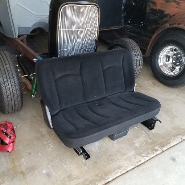

    Since I had to pull the seat to finish the interior panels and windlace, I figured I'd get rid of that gray Caravan seat and dye it black. Looks good enough until it gets a proper upholstery job.

    Looks decent for now....sorry for so many questions, but is that a second row Caravan seat.....late 1990's...early 2000s

    Exactly what it is. Stripped off the fabric and foam, cut off all the brackets and welded on my own mounting brackets. Sits nice and low and gives plenty of headroom. I modified the package tray which allowed the seat to go back another 3". The only thing that makes you feel cramped is the width and there's nothing I can do about that (and it's not bad).

    Cool, thanks. Im debating some ideas on seating in my Coupe, has buckets from like an S10 or Toyota p.u.....want a bench instead

    Gotta tell ya, this seat is REALLY comfy.:)

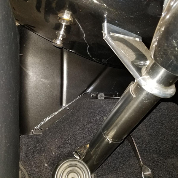

    One little detail that has been bugging the crap out of me is where the throttle shaft goes through a hole in the firewall. I've been looking for something to give it a more finished look and came across a throttle shaft boot from a 240Z.
    It's all about the little details......
