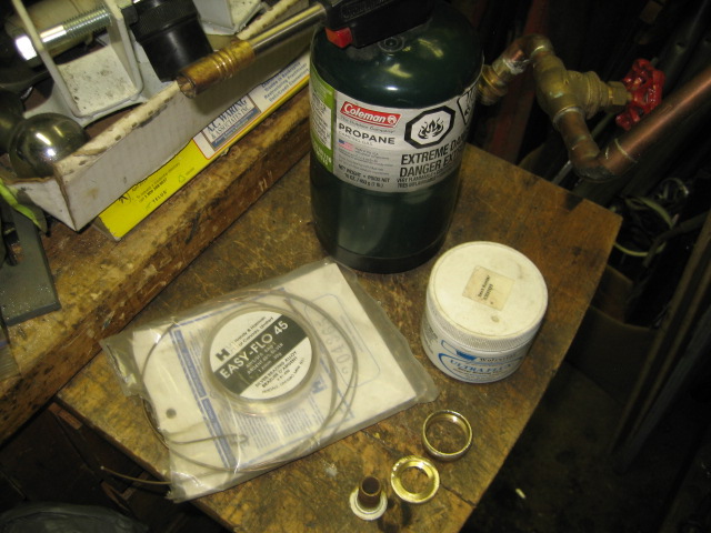

    I'm going to make the long story shorter. Oxy acetylene gas, Silver brazing alloy, BAg1.
    Final answer.
    Why, because not everyone owns a Gas Tungsten Arc Welder.
    winduptoy and wandi harry like this.

    Like NoelC said, get some 45% BAg1 silver braze wire and the proper flux. Put flux on both pieces, butt the parts together and clamp them so they can't move if you can. Start heating the joint and watch the flux, it will dry up first then it will turn to a clear syrup. This will indicate that you are close to the brazing temp. Add more heat and try to add the filler wire to the joint, when you have reached the correct temp, the silver braze will flow into the joint like solder.
    I use this silver braze to connect regular and stainless steel parts and it will make a repair that is as strong or stronger than the base metal.

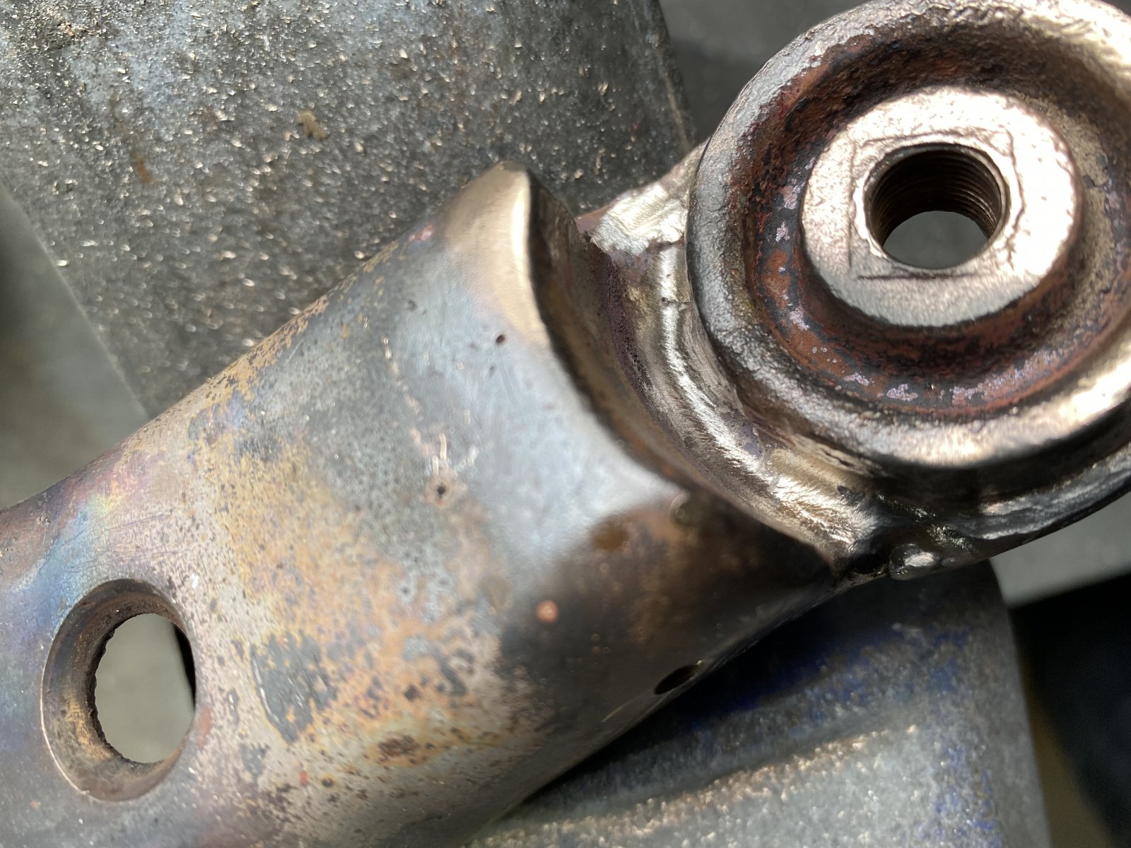

    Just because l have oxy/acy available that’s the method l went with.
    Got hold of some silicone bronze wire 1.6mm and flux to suit. Definitely didn’t have enough heat into the first time around so l cranked it up a bit.
    The silicone bronze didn’t flow like silver solder would and l was worried about the amount of heat that l was putting into the stanchion as it was well past cherry red to get wire and base material to meld together.
    I cleaned it up and it turned out ok, could be better but good for me
    I reckon it’s a weak spot in the design so wouldn’t be surprised for it to crack again ] 7028F9A0-E9B7-4B9A-AF72-7BAD64B3E394.jpeg 0C73D0EB-7062-48CE-9F4A-EB5695EF770E.jpeg

    You got it to actually melt is what you did, and it does take a lot of heat to do so. Well done.
