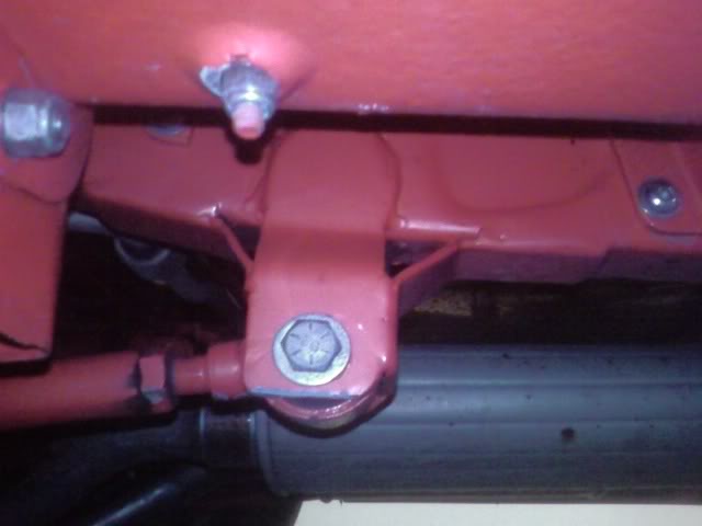

    Not a leaf spring however a simple gusset would work, this is a lower Jag IRS arm in my 35. There's another similar bracket on rear to capture the other side of bushing

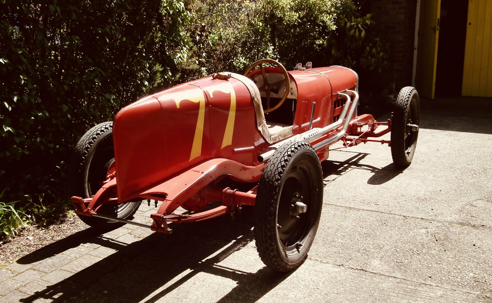

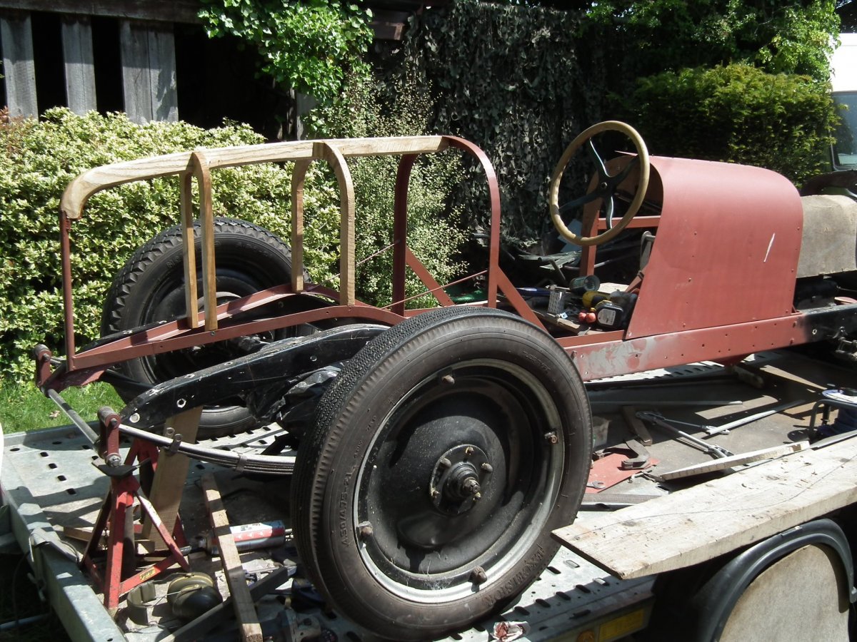

  4. 282doorUK
    Joined: Mar 6, 2015
    Posts: 518
    282doorUK
    That's interesting Reidy, I ever heard about that before, do you have a link to the discussion?
    Although I've just drastically narrowed the chassis and axles mounting pads to make the rails and the springs parallel as it was tapered towards the front originally, so I don't really have much appetite for altering things back again now..

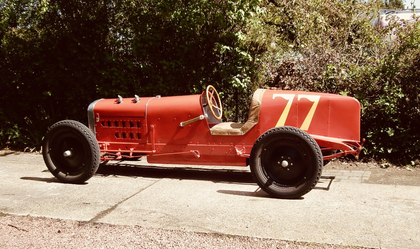

  12. That's fantastic! Did you make the bodywork as well?
    Six Ball and Outback like this.
  13. 282doorUK
    Joined: Mar 6, 2015
    Posts: 518
    282doorUK
    Wow, dunno what to say, but thanks for the compliments guys, very much appreciated.

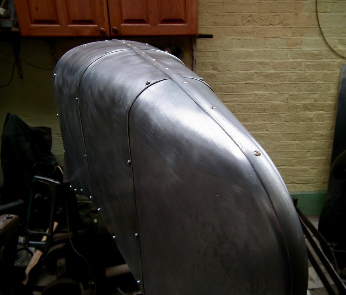

    Cactus, yes I made everything that Chevy didn't and altered most of what Chevy did.

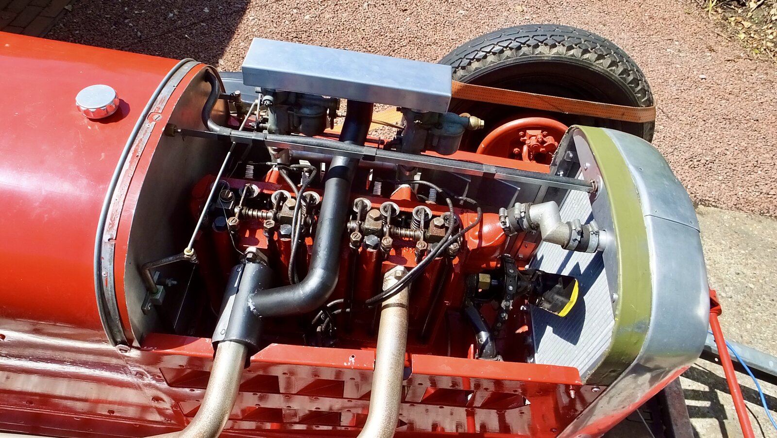

    On one of these posts, you said something about a tired engine. I could not hear well enough on your video, but if it was backfiring when the engine was slowing down only, and it is not slipped timing or gaskets, check the disy. gear clearance for up and down movement. Also check how much end play is in the cam. both of these will change timing when slowing the engine down. Both can be easily fixed. I have found both in tired chevy 4 bangers. Be safe, Have Fun!

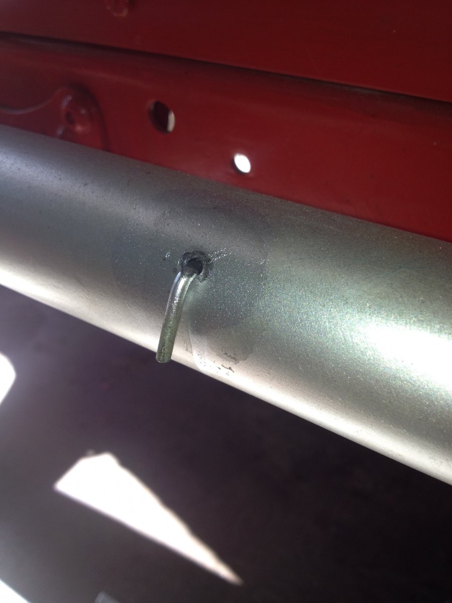

    Thats good info Gaby, thanks I'll have a look at that. I edited out most of the big loud over run backfires! I might have found the cause though, a few pin holes and the holes for the period correct redneck fence wire retainers holding the rolled up chicken netting baffles in place.

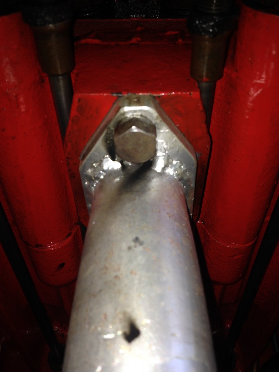

    Just to catch up on my original problem, I ended up using two long 8.8 bolts with the heads turned off, long enough so a thin Delrin spring bush rides on the unthreaded shank.
    They pass tight through the frame horns into a length of hollow LandRover steering rod, I plug /rosette welded them together and ran a weld to the frame horns underneath out of sight to stop rotation.
    Of course I got so involved in doing it I forgot to take any pictures, sorry about that!
    As to the rough running, it was mostly caused by the timing being off and the carbs being too big for the low comp low revving motor. So I enlarged the balance tube and blanked off the rear carb, it runs better on one but icing and condensation in the manifold became a problem.
    I've made up a hot air feed to work like the stock setup. An air box fits over both carbs and the feed tube is almost hidden under it.
    Looks a bit odd with the hood on, it'll confuse a few 'chaps who know about stuff ' but it works fine for now, no more ice. It won't be winning any races for a while but it'll do till a motor hop up requires a whole different approach.
