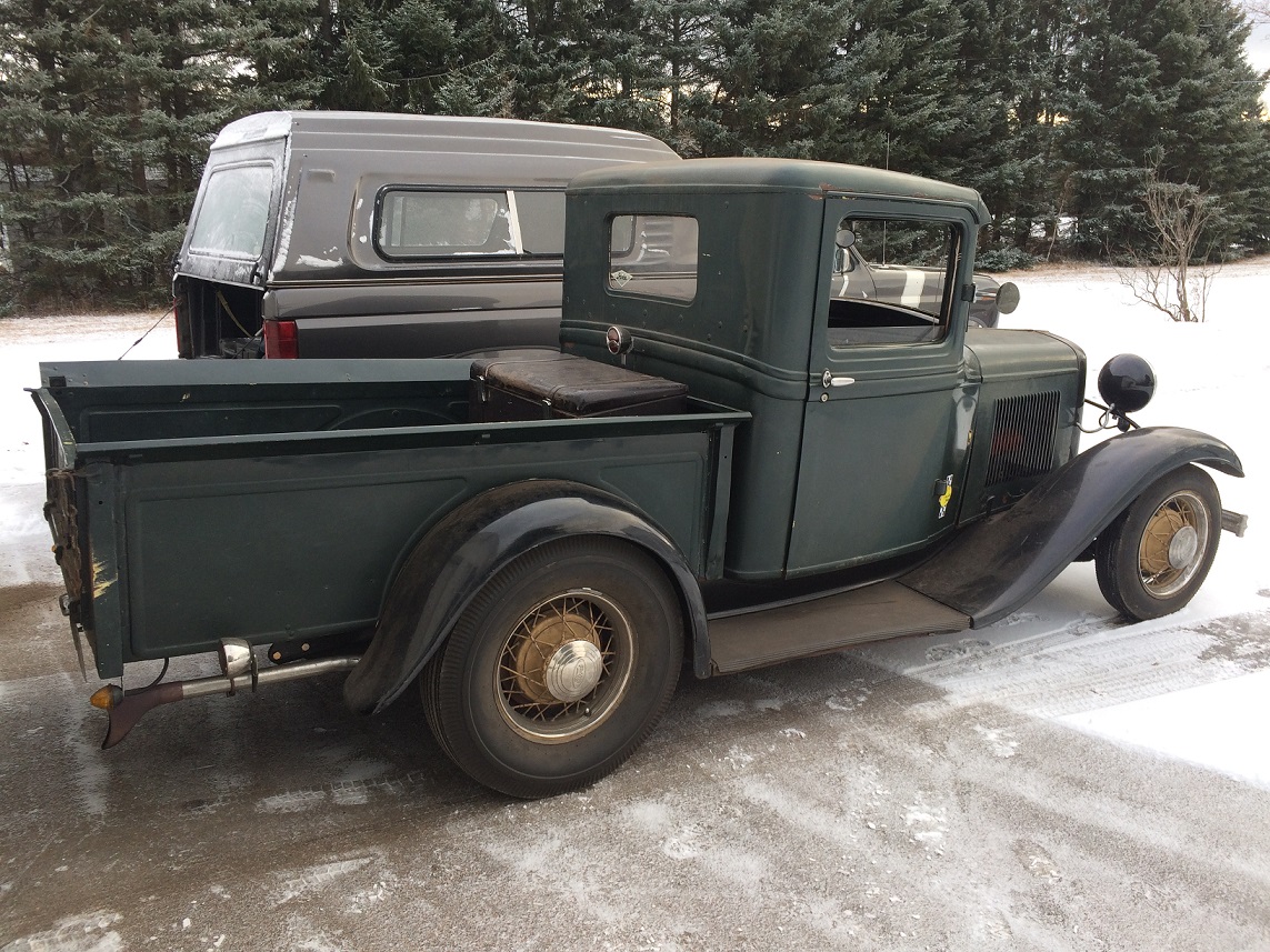

    Do you have the stock rear banjo? That's what I used on my truck with a mild 265 bored to a 283, 4bbl.
    That way no need to mess with the spring setup. Just removed a few leaves and reverse eye the main. You would need to convert to open drive for your use and/or maybe parallel leaves but you can get all that and the install is pretty easy.
    catdad49 and Nailhead Jason like this.

    Tasty truck, 2935... Love the stock length bed, stance is enviable.

  6. 2935ford
    Joined: Jan 6, 2006
    Posts: 3,843
    2935ford
    Thanks.
    Unfortunately......it's no longer mine! :(

    Love the stance of your truck! I plan on using my truck as a daily driver (some freeway) so I went with the later rear. I thought about using the stock one for a while though.
