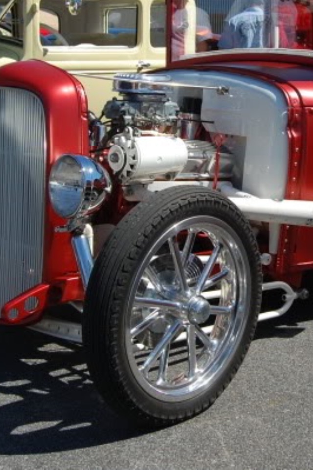

I'm planning and collecting parts for a new front axle set up and I'd really like to hear from the 12 spoke owners. I'm completely in love with the drag strip/show 60's era hot rods!! So that's the direction I'm shooting for, but I need to know if these 18x3 spindle mount 12 spoke wheels and disc brake set up is completely none drivable. Now keep in mind my lil T is no daily driver, but I like to take it to work on occasion or a show or two maybe a show outta town. Thanks, and would appreciate any and all advice. A picture I found on line

I hadn't seen these Radir wheels... I like these. And they are available so they can be fitted with brakes, so no issues there. The downside is you'll be running motorcycle tires so pay attention to tire load as most tires in the sizes that will fit are only good for about 600 lbs each at 40 psi. You also won't have much of a tire contact patch, so don't expect great cornering. And get used to replacing tires often, as motorcycle tires don't last; if you get over 5K miles on a pair, I'll be surprised.... Those ten-spoke 'bolt-on' wheels just don't look right.... I know they're popular, but they look 'fake'...
When planning my sedan, I considered those Radir spindle mounts and discussed them with the Radir sales rep. Weight capacity wasn't limited by those wheels, but it *was* limited by the motorcycle tires typically used. I think 800 lb/tire was the max load. SBC-powered T-bucket (or the A coupe in the picture you posted): Sure, no problem. Blown early Hemi in a '50's sedan: Probably not.
Agree with Just - Also, don't pretend it's a road racer either... Unlike the 15"x4"'s posted above, the 18"x3"'s don't like high corner speeds. Low side load capabilities. Mike

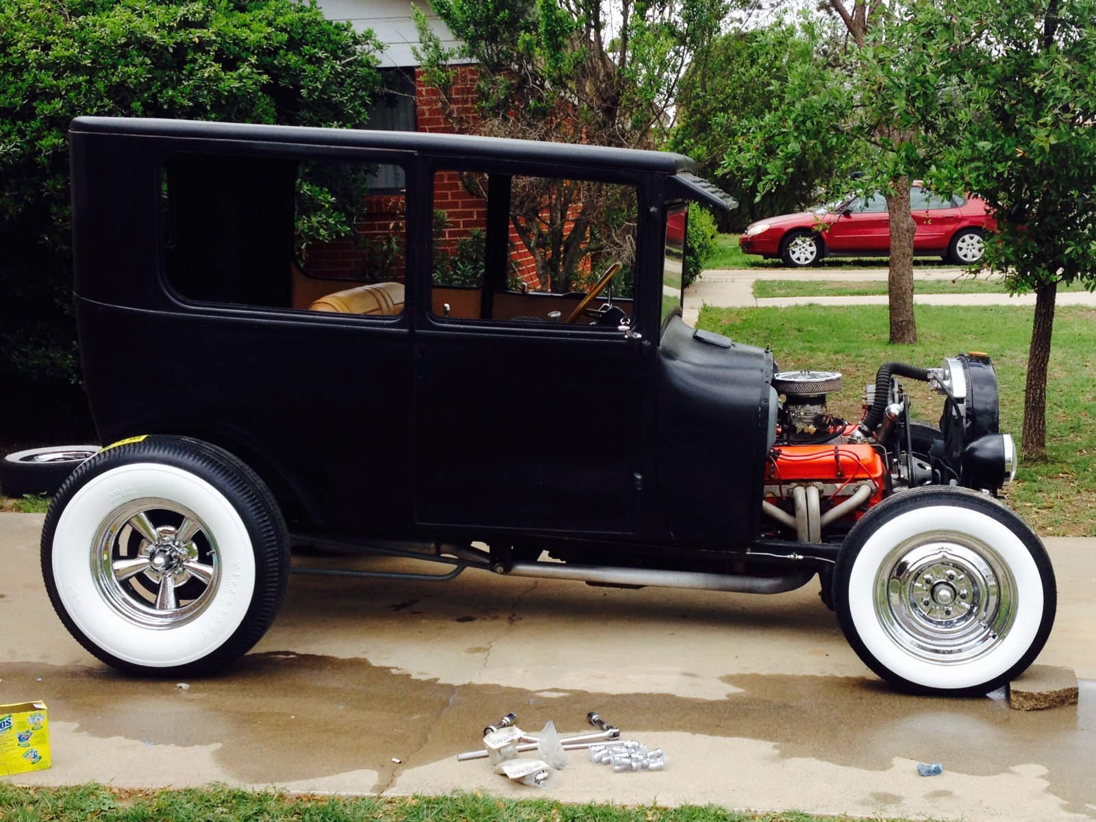

These have been on this roadster for over 20 years. They're mag, font and rear. The fronts were already drilled for rotors and I made some 3/8 thick steel rotors and mounted single spot calipers. Works great.
