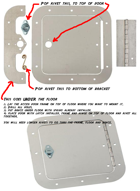

  9. Is this what you are referring too? HRP

    That's basically it ~ mines the 6 x 6 but pretty much the same parts.... Does the piano latch go up through the slot? I appreciate your response ~ though like I said, a simple hand-drawn diagram showing the assembled door would have gone a heck of a long way, for me anyway

    Try this.......

    A lot of things on their Website has a place to click on that brings up the instruction page so you can check it out before ordering. If you can't figure out the Dzus fasteners then let the weight of the carpet keep the lid closed.

    I would mount the aforementioned piano hinge to swing up,I would mount in under the flange where just the hinge is visible but under carpet it wouldn't matter if it was mounted on top..it would just look better mounted under the flange. HRP

    Greybeard360 ~ now thats what I needed and was confident someone on the HAMB could come up with it - thanks to alll (or most) who responded to my newbie question. I know I don't have a ton of brains.... but I'm smart enough to turn to the HAMB for answers!!!

    I took those images directly from the Speedway web site. The bottom image clearly shows the piano HINGE (not latch :confused:) under the frame/door. I would rivet the hinge to the door when starting the assembly process, will take one less hand that way.
