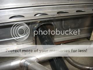

  1. I stepped back and finished up the bed. Fabb'd up and plug welded the 14ga angle iron that the hat channel sits on. Finished up the hat channel and drilled 32 speed holes. Also notched out the front and side panels for the drive shaft and axle and welded the 1" strips in.

  2. Brian, very nice work; you should bring it to the Meltdown.

    very nice work. I really like the bed crossmembers.
