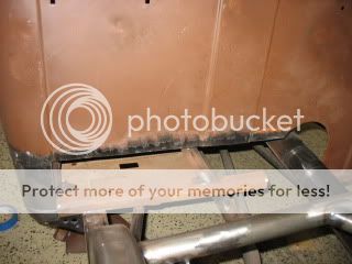

  9. I been working on the driver side cab corner and rear lower wall replacement.
    It's my first rodeo with patch panels so it took me about 8 hrs start to finish.:rolleyes:
    Here's a couple before and afters...
    Needs a little more metal finishing but I'm happy with it so far.

    Cab corners and lower cab patch look awesome! I'm going to have to do mine sooner then later. Have the patches , just haven't gotten around to them. Any tips?

    Only tips I have is measure three times and cut once. Take your time with welding them in. I did a quarter of an inch at a time, hammer on dollied the weld and moved on. Use the correct size wire if you are mig welding.:) When I chopped the top I was using 030" in the beginning and was fighting myself until I realized what was wrong. I am no pro at this by any means, but these are a few things that worked for me.

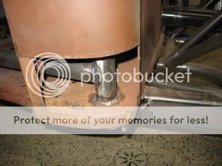

  24. Inching along on the truck. I cut the new passenger door and tacked and fitted it. Still needs to be finish welded. Cut out the cancer in the passenger cab corner and lower wall bead and made up some new pieces today.
    Before...
    After...
    I wish I had a lift to do this shit. :D
