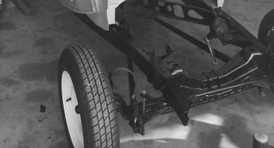

  5. How about a picture of the spring

  9. Roothawg
    Joined: Mar 14, 2001
    Posts: 24,602
    Roothawg
    Good call. The spring appears to have lost all of its arch in 750 miles. Nice. I won't buy another Posies spring.

  13. It's hard to see, but the shackles are cocked assbackwards wrong in these pics. However ,,, Also the spring should be pulling the shackles at 180* in this set up and there should be no way possible to get them that way unless the spring is too long.
    It appears that it is indeed too long
  14. This is set up right, rides great.
    You can see the shackles are showing a balanced spring rate to load. You also can see the amount of arch and it's not much.
    This spring needs quite a bit of preload flattening to get it mounted.
    olscrounger likes this.

    X2--if the shackles aren't at a 45 with the car loaded it won't function but sure looks like a lot of leaves.

    I'll get it up in the lift this weekend. It's hard to see in the dark garage
  17. Roothawg
    Posts: 24,602
    Roothawg
    At one point we had them flipped. We unloaded them later. Not sure when those pics were taken. Pre or post.
  18. Need the spring loaded, A 4 post lift would be ok. A 2 post or stands would not get us a good representation.
  19. I know at least one spring manufacture out there has some bad info and measurements and has WAY to much arch in their springs.
  20. That flip is the tell tail sign the spring is too long. The shackles should be pulled horizontal, and when pulled horizontal there is ZERO chance they could ever flip.

    The shackle looks fine. Check the shock length and also, make sure the swaybar isn't hitting the shock mount. You could try removing the shocks and driving it, that would at least eliminate the shocks being the culprit.

  26. Looks damn near vertical to me
