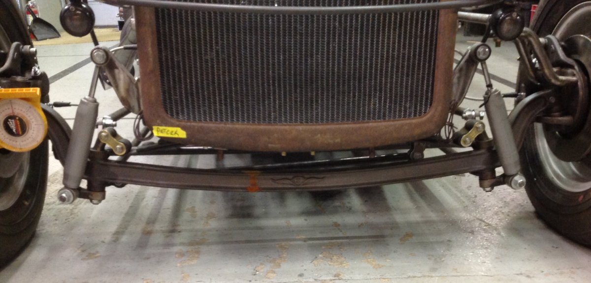

    This is a super bell axle, customer purchased a front end kit from honest Charley back in October 2014. I remember there were some bad ones out but can't remember the time frame.
    I'll give some static pics first, so you can get your bearings.
    Then I'll post some dynamics and the movement I'm seeing.
    Drove it for the first time yesterday. Brought it back in for caster tweak and some death wobble then started finding this crap.

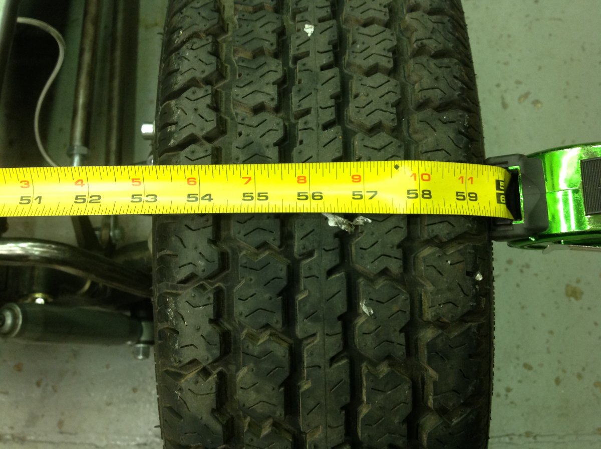

    Ok so first thing noticed is a huge camber change when it gets some weight on or off the axle.
    Setting on the ground full weight. Watch the tire's center mold line.
    Next with the jack in the center of axle
    With jack under drivers wishbone mount
    Here's 2 jacks - 1 under each spring mount.
    Next problem I'm seeing.
    The drivers side of the axle seems to be rotating around the spring perch.
    Check the zip tie on the shock.
    First pic is just putting tension to turn right. Which pulls back on steering arm.
    Next is tension to turn left, pushes on steering arm.
    image.jpeg ,the variation you're seeing is the distance the lower shock mount is moving up and down while the axle twists. No movement that I can feel, see or measure in the radius rods
    Here's the movement at the king pin. Tape was attached to the frame further back.
    Tension to right turn first- then tension to left turn.
    3/8" +/-

    I hate to say it my friend but I may be w little concerned about the axle. I do recall Super Bell having some problems a couple of years back but I can't give you a time period for sure. Unfortunately no one in our industry has anyway of tracking batch numbers. If I was getting death wobble I may suspect that this may be the cause of it.

  12. Well I followed "this guys" lead on the steering arm.
    This axle isn't dropped though.
    So if the torque from the raised steering arm is causing 1/2 of the troubles it's good to know the Arm I made is stronger than the axle
    I don't want to see or find this, and that's about where all the bending is coming from. BOTH The camber bend when loaded /unloaded and the caster twisting seem to be happening right there.

    The spindles rotation about the king pin is somewhere between 0 and 1* - nominally "none".
    the axle isn't going up and down, it's twisting and the lower shock mount is the pointer.
