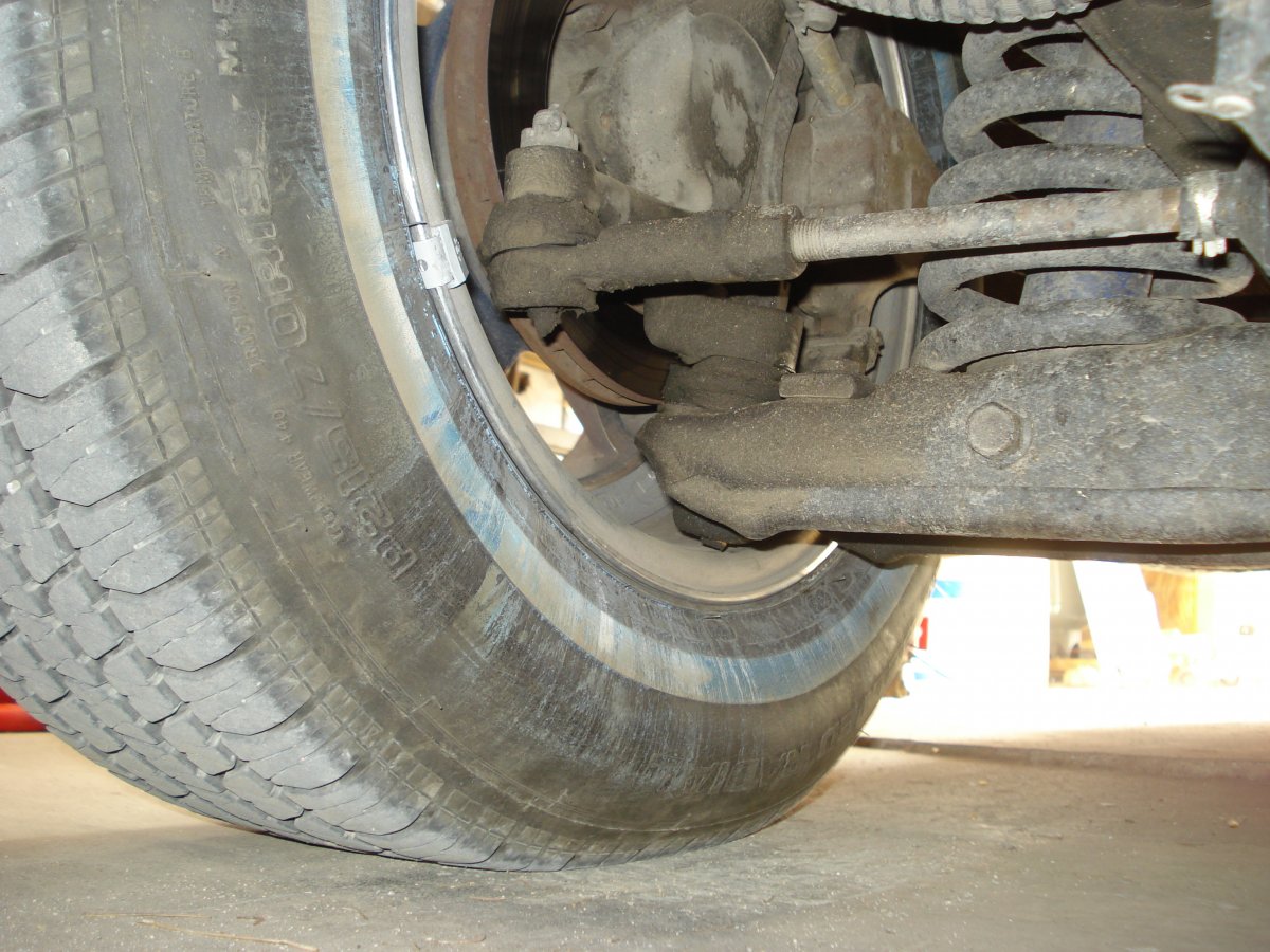

  15. Just because it is new does not make it good.
    john worden and nunattax like this.

    if they are 15 inch rims in the photo wouldn't 16 inch rims give you an extra 1/2 inch clearance there and room for stick on balance weights just a thought.
  18. trollst
    Joined: Jan 27, 2012
    Posts: 2,108
    trollst

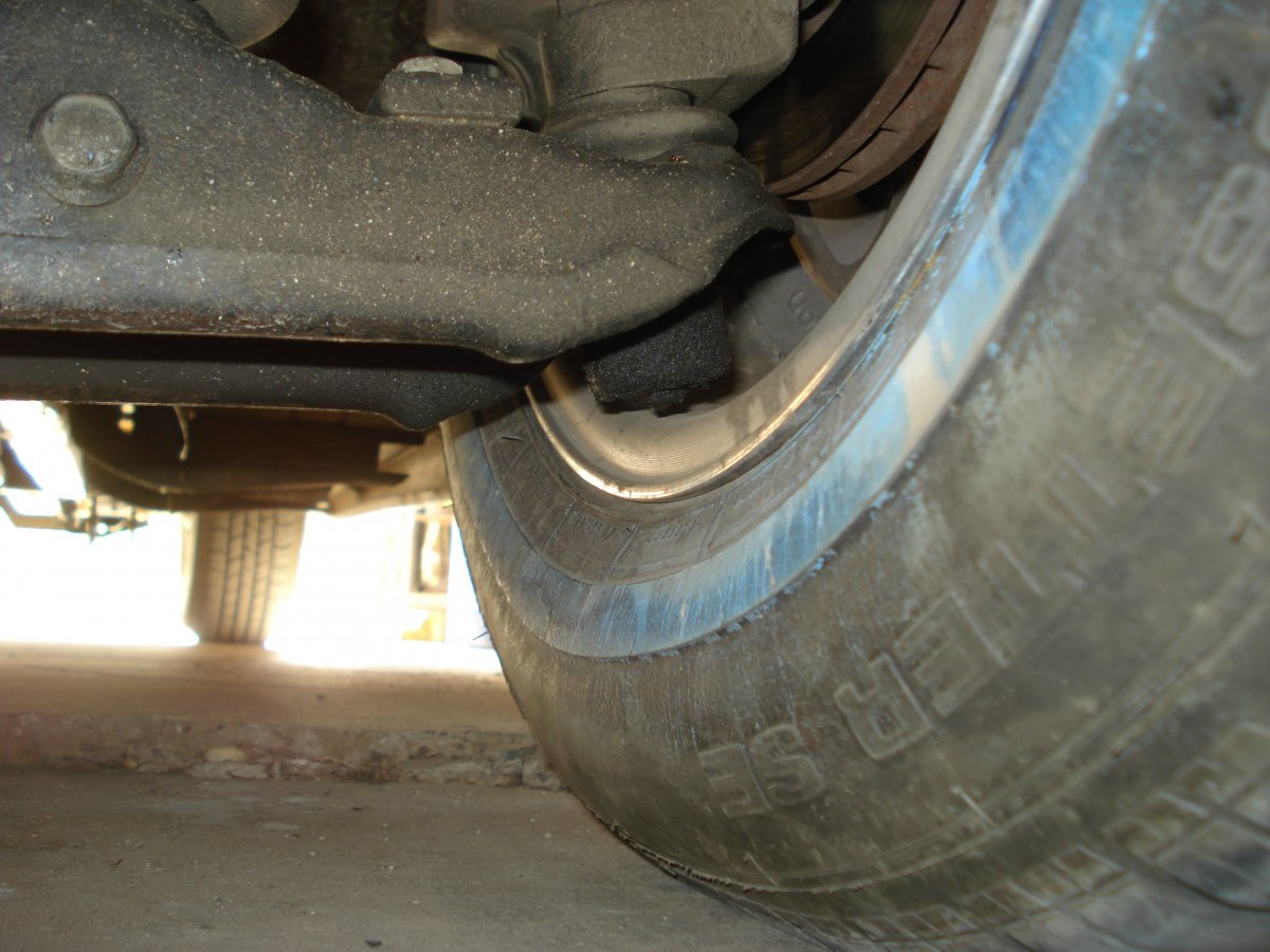

    The balance weights are stick on, in the center of the wheel, the inside rim has clip on weights, no issue. 16 inch rims would kill the look of the truck, nothing hot rod about it, 15's work fine. DSC07702.JPG
  19. nunattax
    Joined: Jan 10, 2011
    Posts: 3,069
    nunattax
    from IRELAND
    gotya clear in the photo

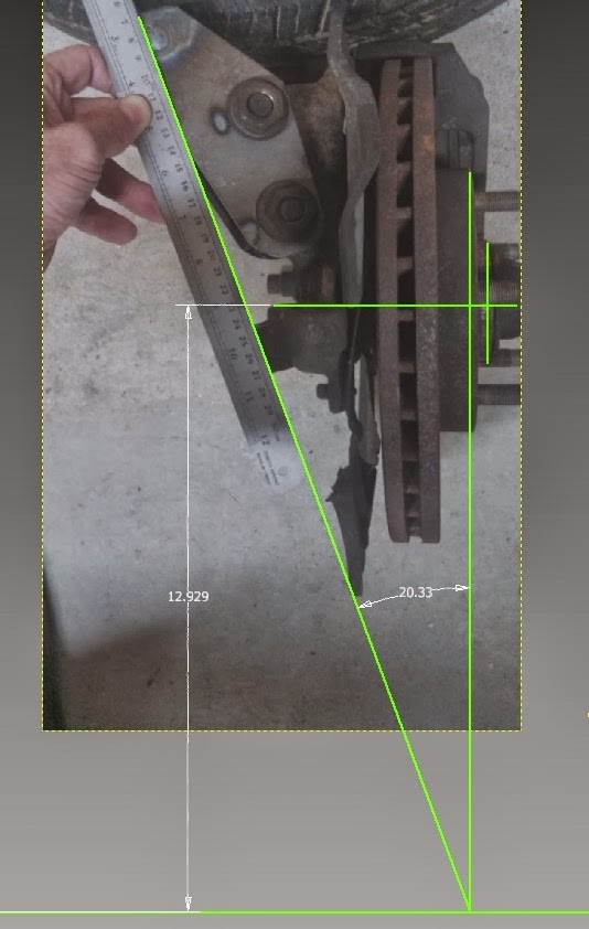

    going to a smaller tire
    Drop spindles are even more dramatic and then add in some offset of a deep rim with shallow backspace,,,
    then you have this
    12” represent 24” tire shown with zero offset rim.

    31 vicky - can you explain how the scrub radius can affect steering wheel shake/vibration? I would love to find that I have some geometry problem which causes or adds to the problem.
    My ‘37 has all stock Ford parts, no dropped spindles or cut springs, stock type wheels 6” with normal backspace, all of which seem similar to the ‘36 trollst pickup.
    As far as the on the vehicle spin balance. The first time they balanced the tires and wheels off the car then put them on and spun them. They could not get them right and thought the wheels or rotors were a problem. I checked the rotors and thought they were drilled off center. I bought a new set from Jim Weimer. Not much change. Bought new front wheels. Not much change. Bought new tires. Not much change. Had the wheels spun balanced by someone else, all four, no improvement. He was stunned that did not work.

  29. The super condensed version...
    force and lever
    The natural consequence of aTire going down the road creates a force from resistance , the scrub radius is the length of the lever that force acts on.
    I have not ever seen a perfectly true rubber tire.
    https://m.youtube.com/watch?v=8H98BgRzpOM
